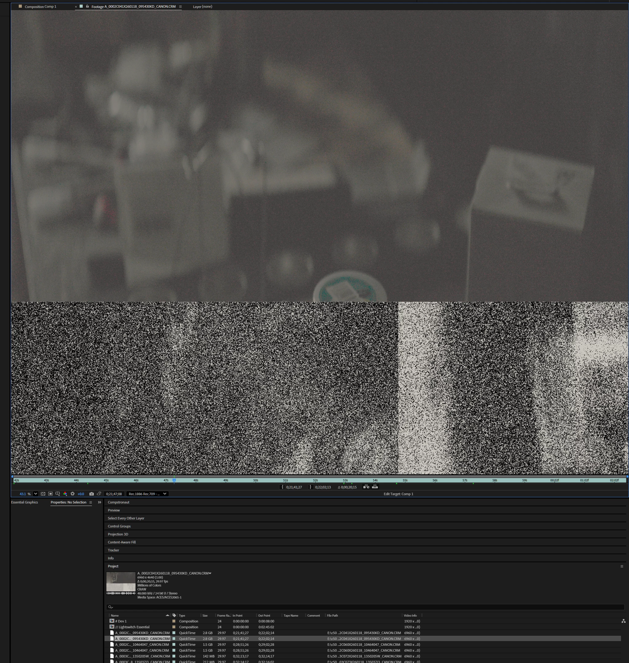

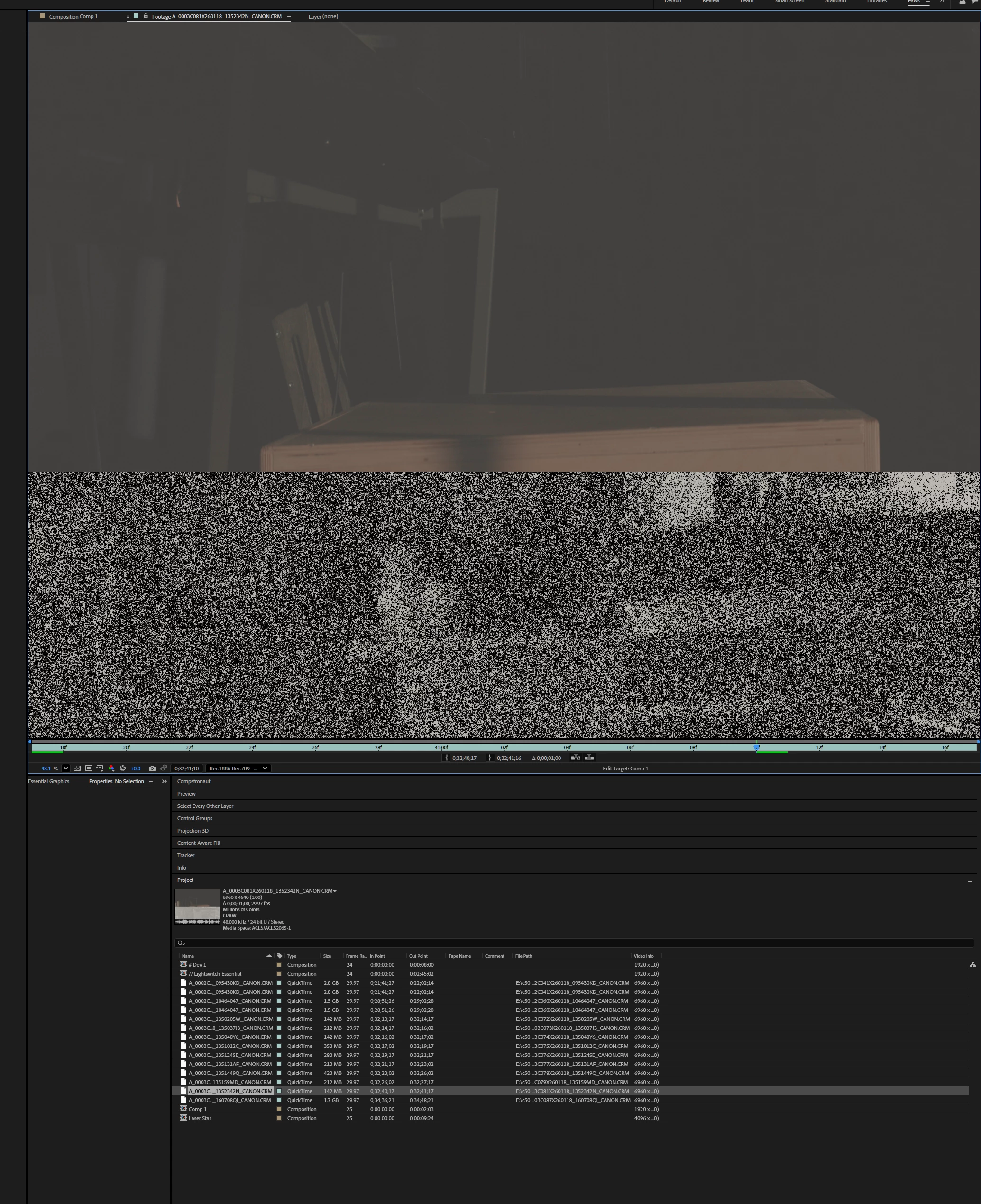

Canon C50 7K 3:2 RAW Light clips do not show up correctly
They open up with a white green noise and there are 2/5 of the composition screen two-bar glitch at the bottom
Providing the link to some test footage of .CRM from Canon C50: https://drive.google.com/drive/folders/1hJBx_KVy20I0wjVHAtCzzhE_orua7zrx?usp=sharing

nishu_kush
janv. 20, 2026 7:56 PM UTC
Thanks for reporting the issue and sharing the media files, Eugene Mogrts. I am able to reproduce the issue on my end. Filing a bug for further investigation. It is working fine in version 24.6. Feel free to use it while the issue is getting fixed.
Nishu
