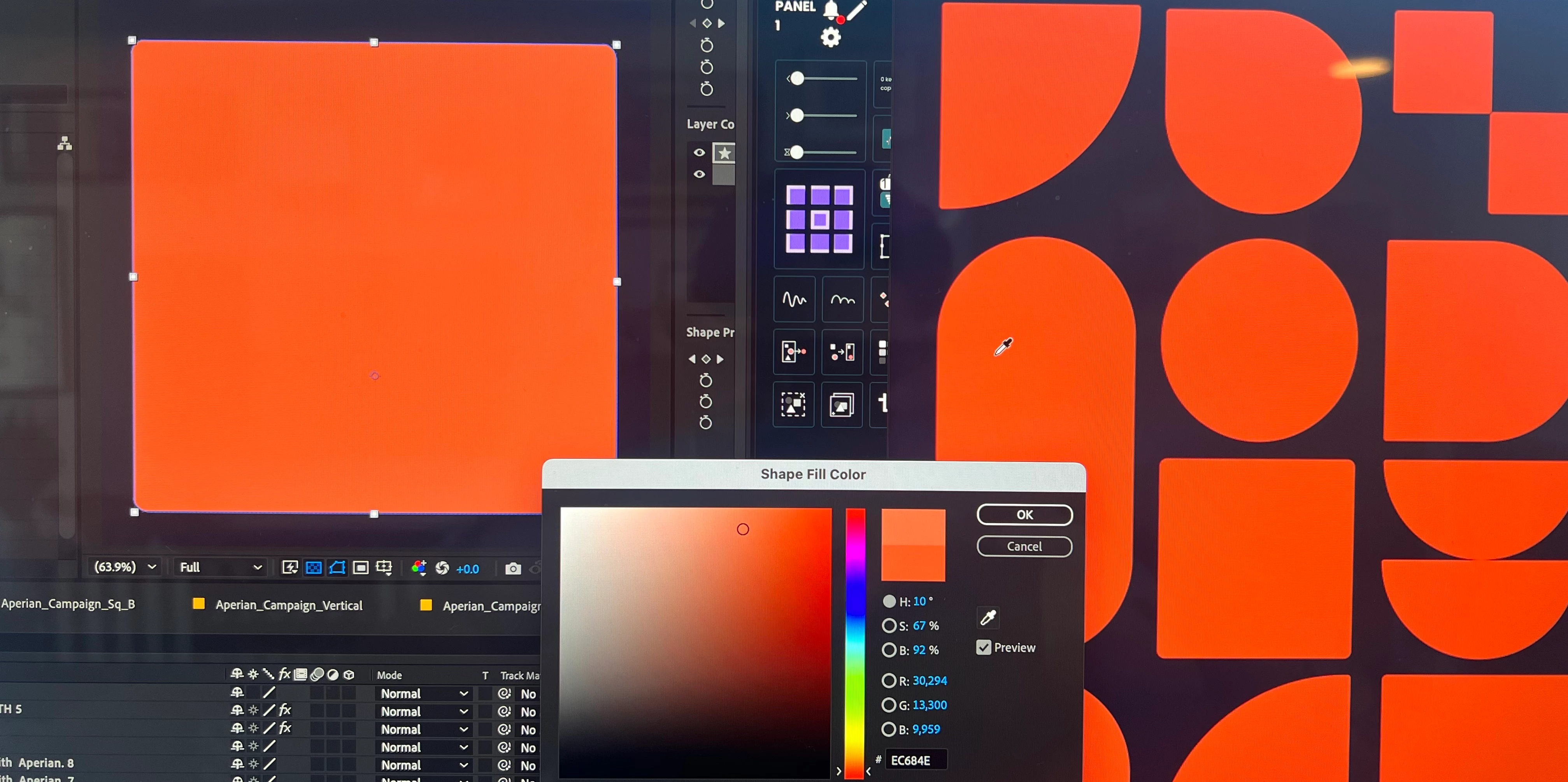

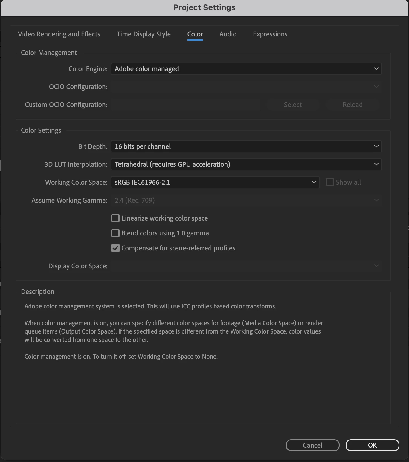

I'm working on a mograph project and I'm running into an issue with my exports not matching what I am seeing in AE. My color workspace is set to sRGB IEC61966-2.1 and on export AE I make sure the color space is the same.
I've tried the QT-Gamma correction LUT avenue but the colors are still not accurate. Also when I try to export into a QT file (Animation Codec) and then encode the file to a .mp4 in Media Encoder the colors get desaturated. When I import the .mp4s into AE the colors match but when viewing in QT or outside of AE the colors are washed and for some comps, the colors are shifted. When doing research I saw that this might be an issue with QT and when you upload to a platform the colors should then be corrected but that's not the case, the colors still are off.

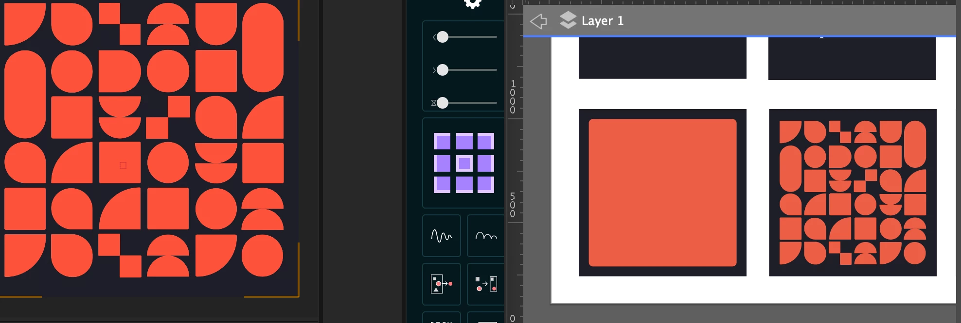

Another issue I noticed is that when I have AE and Illustrator files open side by side the colors are not even matching there and I double-check that the color spaces are both sRGB IEC61966-2.1 and that Illustrator is in RGB and not CYMK mode. In both of the programs, the hex codes are the same.

I'm using an Apple XDR color preset on a Mac Book Pro, is that not a good profile to use?
I fixed the color proofing issue in AI, but other than making sure that there is no simulated color profile in AE and making sure the color space is matching in AE and AI what else can I do?

Let's keep it brief: None of what you wrote indicates that you are using actual color management anywhere. Not in AE, not in AI, not on your monitor. Of course inevitably colors will be unpredictable if your monitor isn't even calibrated/ set to a specific profile and that profile being used inside the apps for previews/ proofing. That and of course every friggin' video player on the planet has its own mind about how to honor color profiles (or mostly not) and mess with things like Gamma, so it basically means nothing to view clips outside managed environments. So for what it's worth, educate yourself about that CM stuff and then act accordingly. Calibrate your monitor, set up the CM correctly, use proofing and composition previews with the monitor profile.
