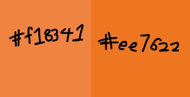

Issue #2 (the more important issue):
In a different video (although one in the same series) I have two assets that are the same shade of orange (in their adobe illutrator files). However, they are NOT the same shade of orange according to adobe affereffects. (Also I did make sure to check the opacity, this is not an opacity problem.)
As you can see in the above screenshots they're different although I swear to god they're the same in their own illustrator files (the one on the right, #ed7622, is the correct colour and the one that is in both illustrator files). Because this asset is way more complicated then the one I talked about in issue #1, I am absolutely not going to be rebuilding it in adobe aftereffects just to get the colour I want. I might just take the L with this one and hope my supervisor doesn't notice the colour difference. However I would greatly appreciate if anyone has any idea what could be causing this.
(Also, somewhat alarmingly, when I copy-pasted a shape from one of the illustrator files to another to check if they were the same colour, the copy-paste changed the shape's colour from #ee7622 to #ee7722 ?! Is that normal when copy-pasting between illustrator files?)

Hi Anjali,
Thanks for the question. The first issue might have to do with the working color space in Project Settings > Color Tab? Does it match that same one as the one set up in Illustrator? Check that out.
The second issue might be related to the color profiles you are using in Illustrator. Check if one Illustrator file uses a different embedded color profile.
Let me know if the advice helped at all. Sorr for the issue.
