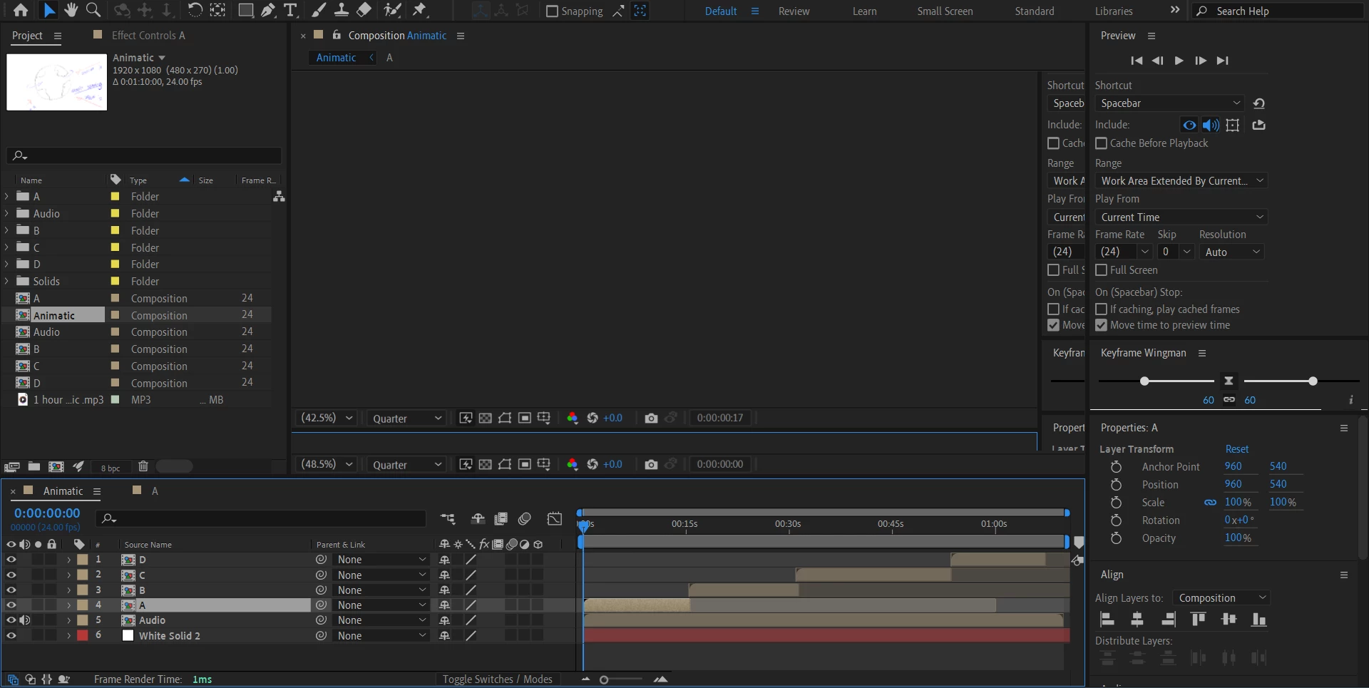

So for context, I've posted a similar discussion before this and my issue currently is that AE Comp preview doesnt work as it is intended to. It only works when im Putting the program in another window ( on a extended display screen ). This wasnt an issue previously as all my drivers are now fully updated, I've purged all the disk caches, have done the " Deactivate Hardware Acceleration" mode and purged my media and disk caches. I'm not sure if this is a AE issue or my laptop's. Again I've done everything, I even checked and reinstalled my Intel Gpu Driver, Windows Update and Nvidia Driver recently to see if it would resolve it but it didn't work at all.
Issues:-

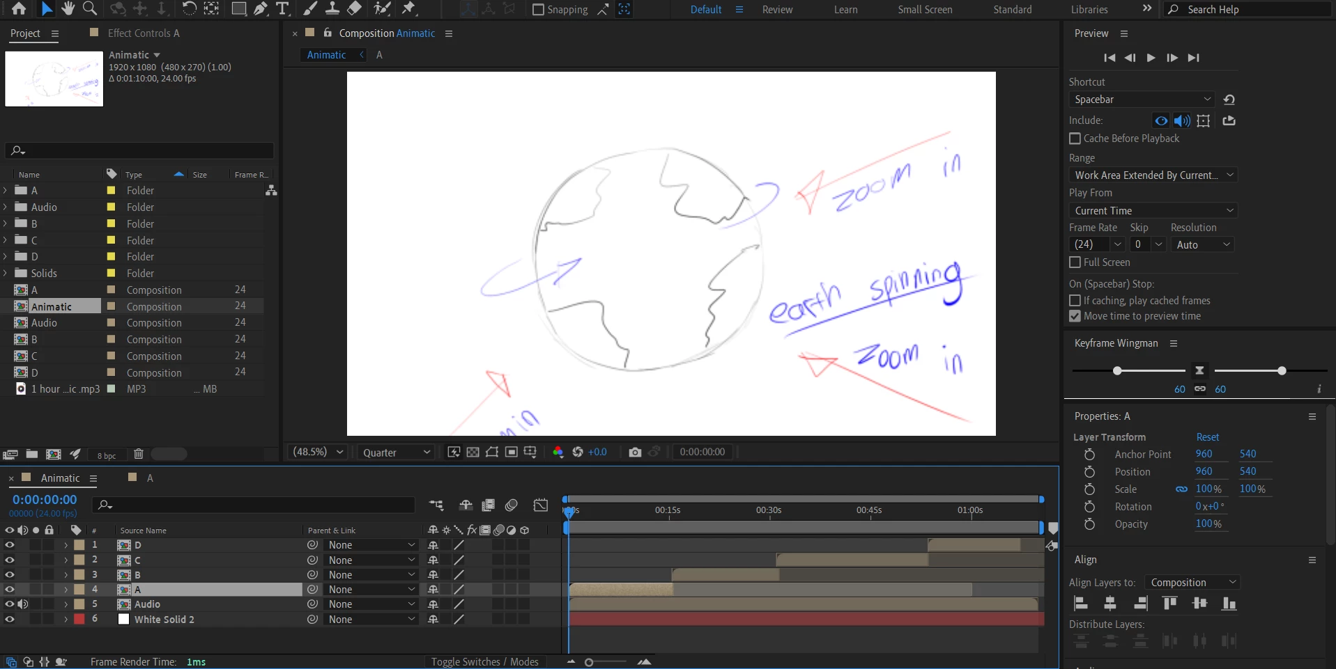

AE doesnt work on main display as seen here ( My laptop display )
But works fine when I place on another display ( another monitor/screen )
This issue is also seen through Premier Pro as well. I also looked through other discussion forms and have seen a few people having the same issues/problems as the one I'm currently facing. I don't know what to do as this is quite frustrating to deal with 😭😭

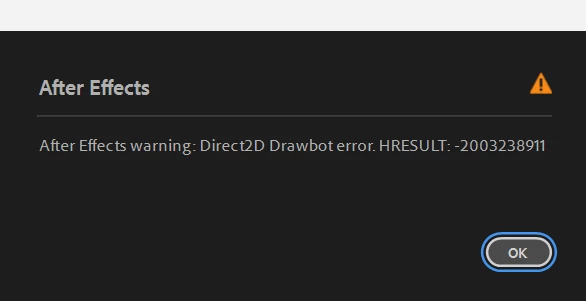

@jenkmeister17177426  Hi sorry to tag you again after the previous reply but right now theres another issue that popped up, I thought it was fine and then this happened? For context after changing the graphic settings through windows mentioned before, I tried dragging into the second screen and for some reason this error pops up?

@jenkmeister17177426 I have found something that might help find the issue, while waiting I was trying to see if it was my drivers fault. So I disabled my Intel UHD driver on the Device Manager and opened After Effects. It works and when I tried to enabled it again it also works, but when I turn After Effects off and reopen it again it seems to go back to square one ( I hope this isnt the only solution because I dont want to do this everytime I open AE 😭).
Edit :
Upon further inspection, I found out that after effects just rejects using my Nvidia GPU. I went to graphic settings on windows and changed the options from "Let windows decide" to use "Intel UHD" and it works. Isn't AE supposed to run on Nvidia GPU instead?

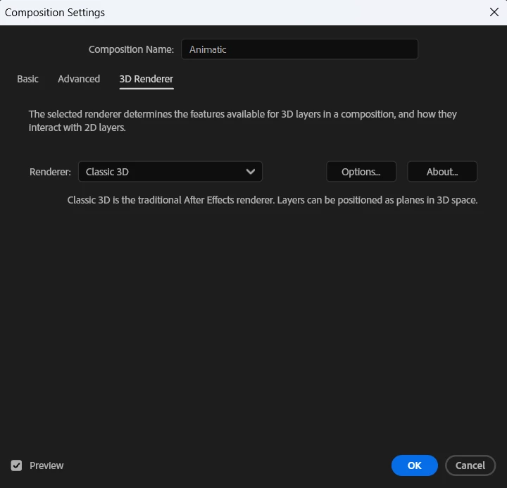

October 15, 2024
Thanks. Please check the 3D renderer setting for me.
Are you able to zip up and share the project with us to look at it further?

October 15, 2024
Is this a new project or an old one you're trying to load? I ask as the memory failures I'm seeing in the logs are related to a Raytracing engine that was turned off in AE quite a number of years ago.
If it is an old project, go into the Composition Settings and make sure the 3D Renderer is set to Classic 3D.
