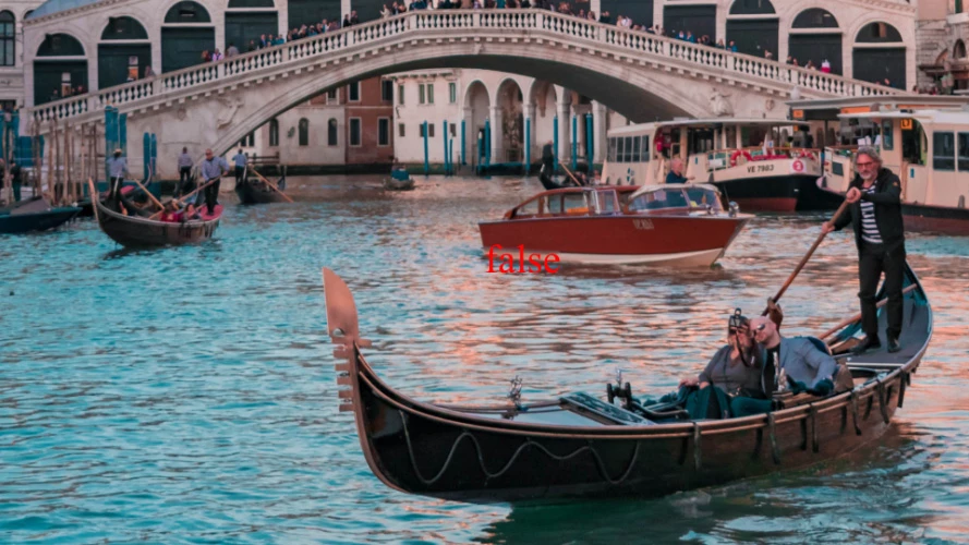

PS. Even worse, if in script1 I render the comp with the footage and the text, text is correctly rendered out as false, even though its value is true in scripting both before and after the render. So, in the same script:
  1. I prepare everything and get the text layer value - it is true
  2. I render it out - in the render it is false (attached)
  3. After the render I get the text layer value - it is still true
