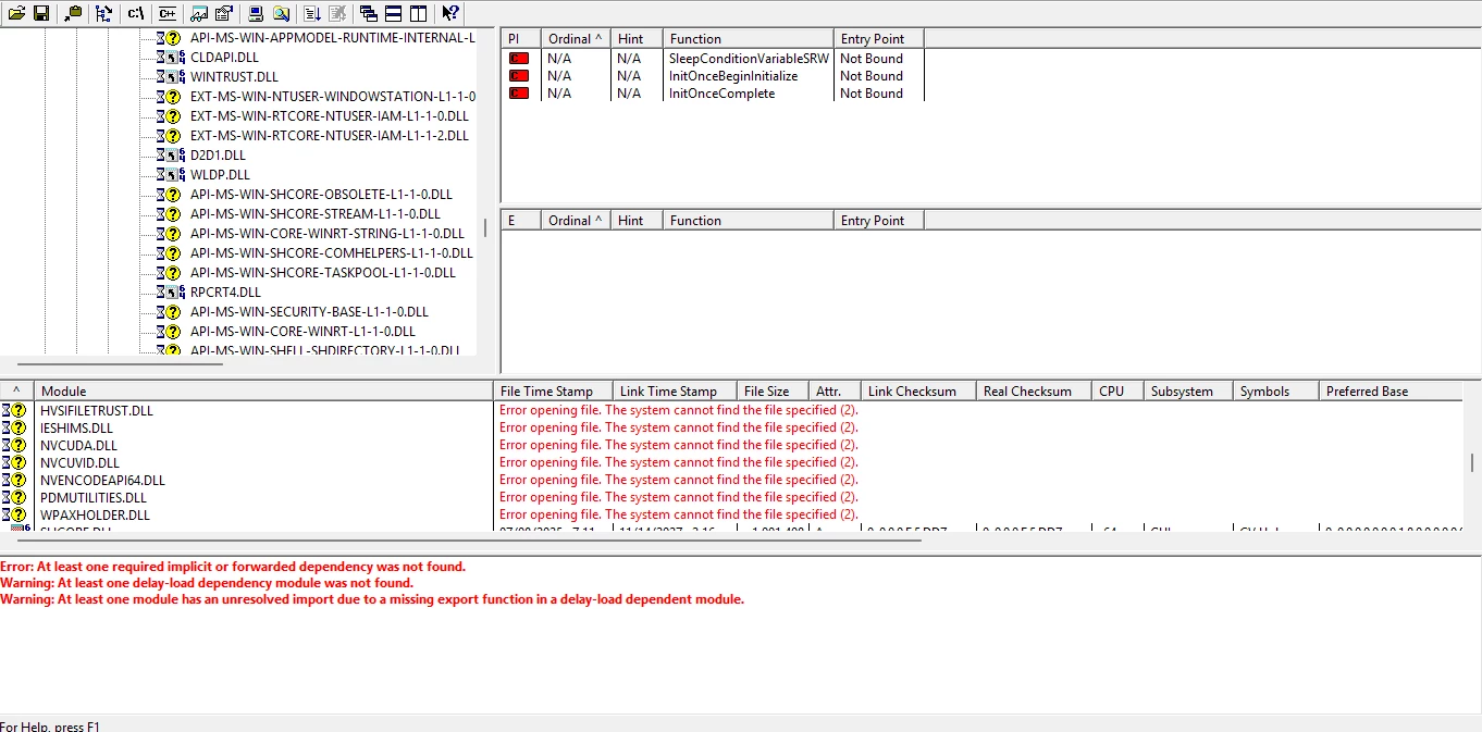

Very helpful. It appears you have an NVIDIA GPU installed? The missing files indicate some required NVIDIA components are not installed that AE needs. Can you download and update your NVIDIA GPU drivers and then try to start AE again?

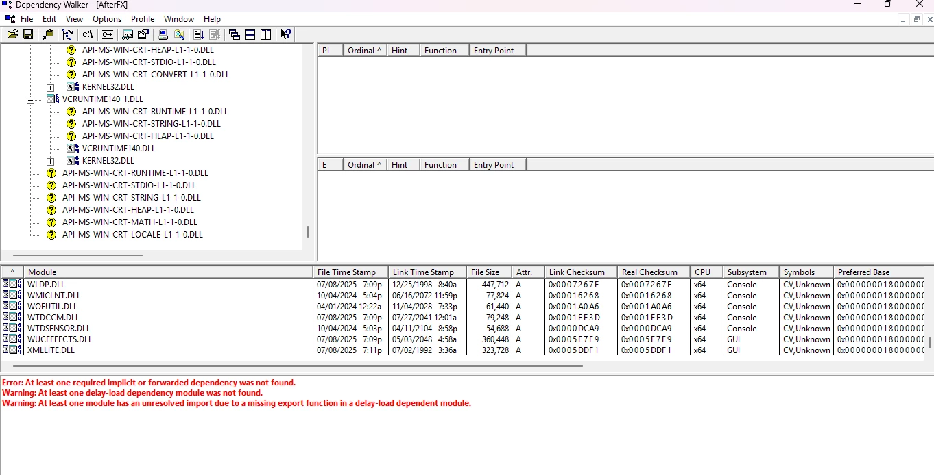

Pretty sure these are all the files with that lable withough API or EXT
Jul 25, 2025 10:59 PM UTC
Thanks. Ok, looks like we'll need to do a bit more looking around that middle panel. I would have you export a log file from depends.exe but it will likely be 100's of MBs so let's just see if we can find the issue manually. Look through the middle panel for any line that says "error opening file. the system cannot ffind the file specified".
Now, ignore any that start with API-MS or EXT-MS. It's the rest of the missing files we need to get a list of. I'm hoping it's just a couple. If you can find those missing ones and list them back here, that'll be what we need.
Alkali_Author
Jul 25, 2025 10:20 PM UTC
Alright this should be the bottom of the panel!

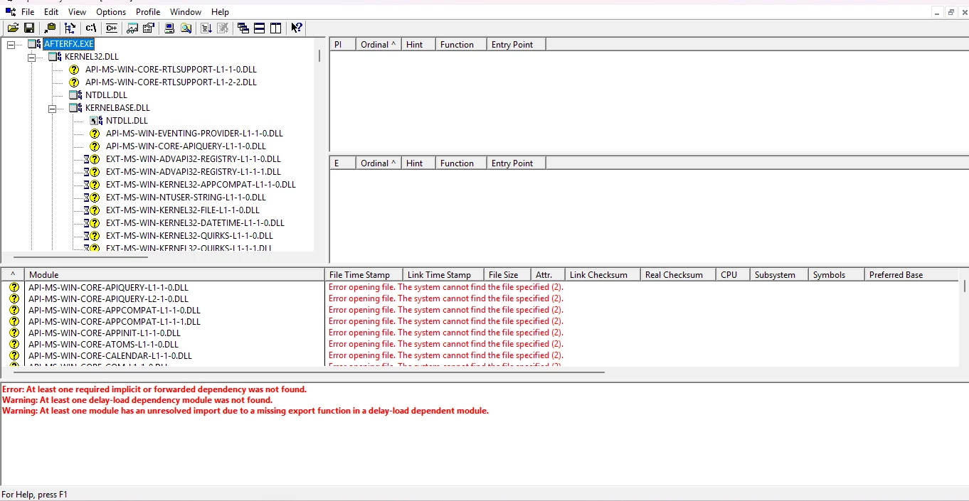

Jul 25, 2025 9:12 PM UTC
Great, that's heading in the right direction. The API- filenames are expected to show like that. Scroll the middle panel down towards the bottom and see what else is showing as missing.
Alkali_Author
Jul 25, 2025 8:08 PM UTC
Sorry for the late reply, I had headed to bed for the night. It was very strange when I tried to open it, and this popped up, along with an error message. Thanks again for the help, I've never been the best with tecnology so this has been increadby helpful.

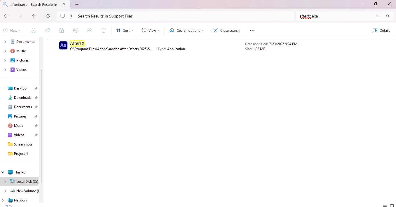

Jul 25, 2025 4:01 AM UTC
Run the depends.exe application (after unzipping the depends22_x64.zip file) and then from that application, drag the AfterFx.exe file into the depends.exe app. It should then result in something that looks like (this is just a sample from the dependency walker website). That middle section lists all the dependent dlls and it should show which ones are missing.
Alkali_Author
Jul 25, 2025 3:57 AM UTC
Not sure if this was the screenshot you were looking for, but I did download the files you sent 🙂
