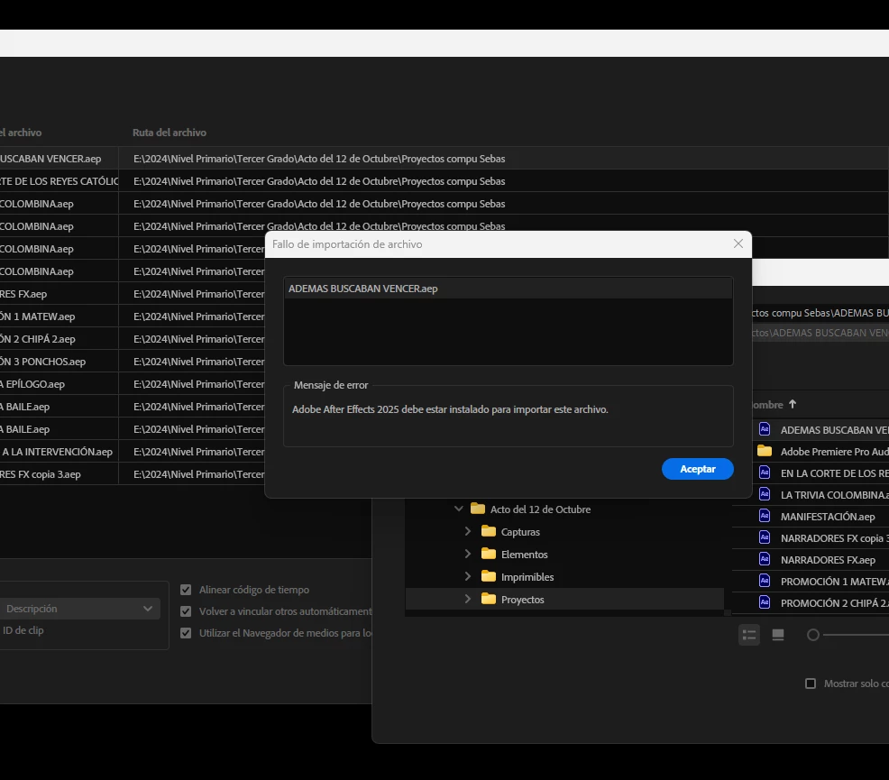

Acabo de actualizar el paquete adobe a la versión 2025. Tengo un proyecto de Premiere en el que importé composiciones de After Effects 2025. Al abrir el proyecto se rompe el vínculo entre Premiere y AE, y al volver a vincular los medios, un cartel me dice que tengo que tener instalado el AE2025, el cual ya tengo instalado, y con el que creé esa composición. Tengo todo el paquete Adobe, pero por algún motivo el dynamic link no está funcionando.

Jessica, thanks for your answer.
In fact, I have installed all the apps out of the default locations, so that could be a problem, and wether I had further problems, I will re-install all the CC suite at the right places. But I´ve found that the AE project that I was trying to relink to the PR project. was corrupt.  Thank you.

Hello @Sebastián Igareta
Thanks for reporting this issue. Are both 2025 applications that are installed the non beta versions of the applications?
Are the applications installed in their default locations?
If you haven't tried it already, could you try restarting your system? Sometimes if an application, say PPro, is running during the install of another, say AE, the Dynamic Link Manager (DLM) may not update state correctly. So closing all applications that use DLM and making sure DLM itself is shut down and then relaunching would be an appropriate thing to try. Restarting is the easiest way to assure you are in a clean state.
