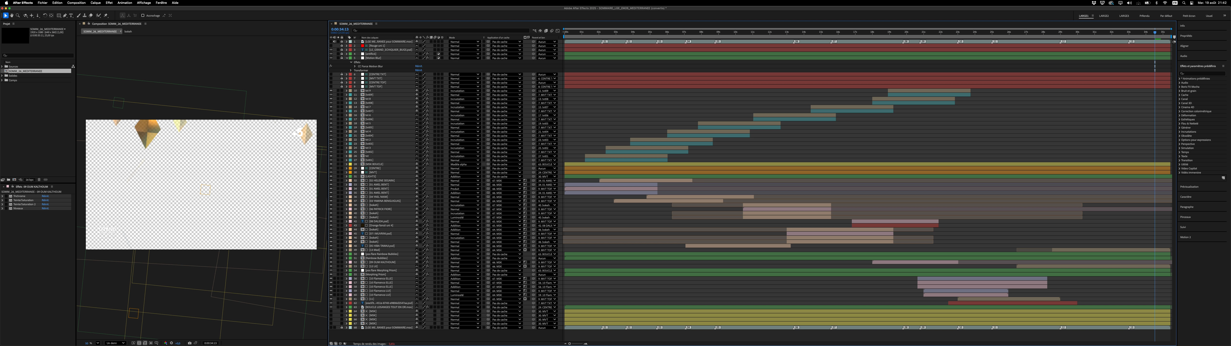

Thanks for that info. I see from the Composition Profiler at the bottom that you have a particularly heavy frame rendering time. If you show the Render Time column in the Timeline, you can start to profile which comp, layer, or effects are contributing to your render times. Check out this article to read how the feature works: https://helpx.adobe.com/after-effects/using/composition-profiler.html
If you reveal this column, purge the cache and then render a clean frame, do the times differ much between AE 24 and AE 25? In this case, purging the cache is necessary because that render time takes cached layers into account.
Also, are you able to collect and send this project to me? If so, it wouldn't be shared outside of the AE team, but it could help us troubleshoot the issue.

ALPIN
ALPINAuthor
Aug 19, 2025 8:07 PM UTC
Hi @David.Arbor ,
you're welcome (but it's also in my interest ;^).
  • Yep, any of the 3 projects I worked for this last week (but they are very similar).
  • Only in 2D (with no motion blur except a light CC Force Motion Blur used only when rendering).
  • Without any third-party tools (except for a few scripts used from time to time to facilitate keyframing).
info: I was able to easily make copies of my projects to open them in version 2024 of AeFx (24.6.8), in which the refresh rate is correct and stable over time (and I even have the impression that the rendering times are faster).

David.Arbor
Aug 19, 2025 5:01 PM UTC
Hi @ALPIN,
Thanks for the report and the info. It sounds like this is happening in every project? Is this with the Classic 3D or Advanced 3D engine? Or are you only working with 2D layers?
Can you please post a full-ui screenshot of your workspace? There are some third-party tools that do what's called "polling" which is a way to update their tool based on the clicks you're making (think of a third-party panel that shows you properties of a selected layer). This can often lead to gradual performance hits like what you're describing, but without more detail, it's impossible to say what the true cause is.
