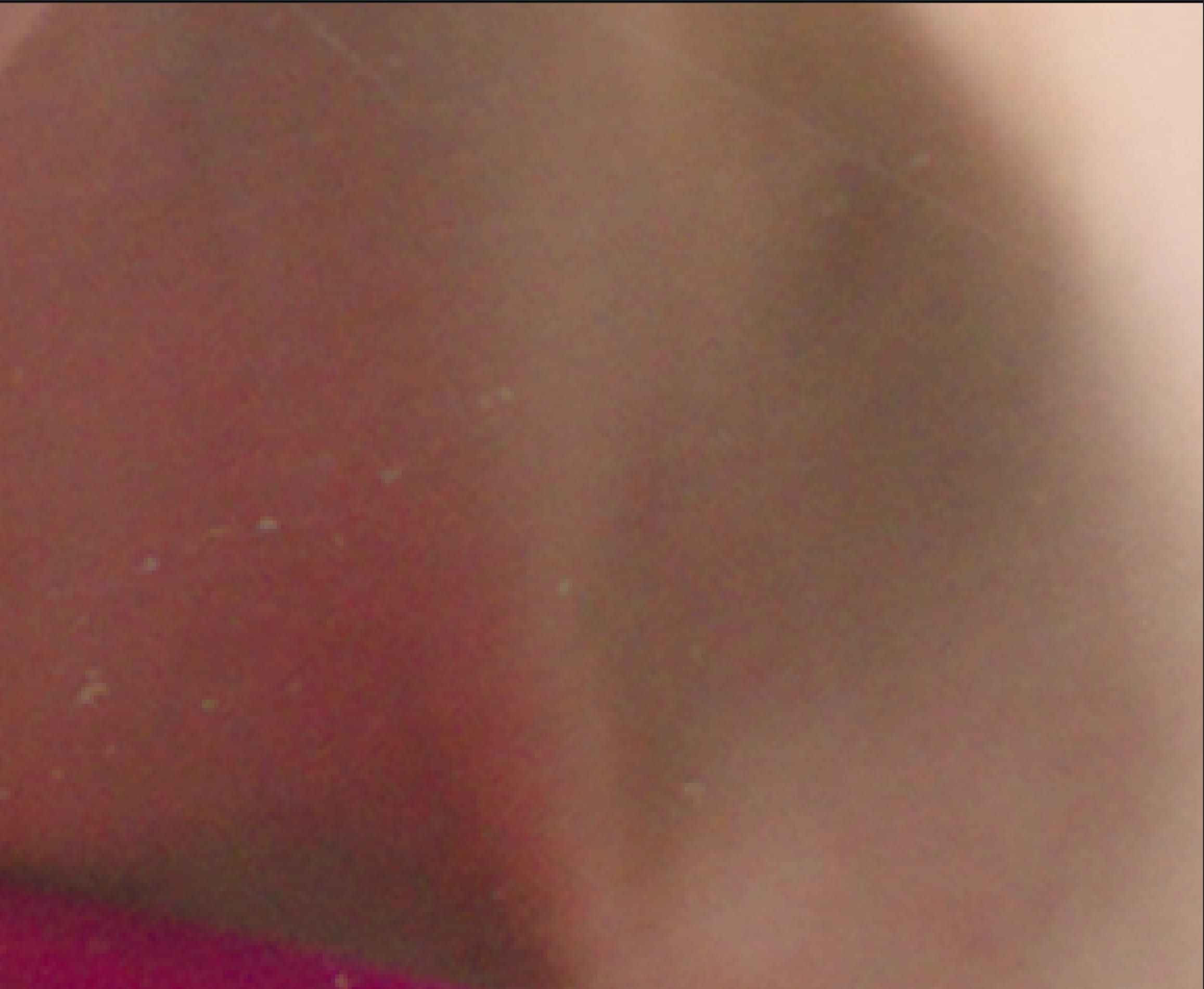

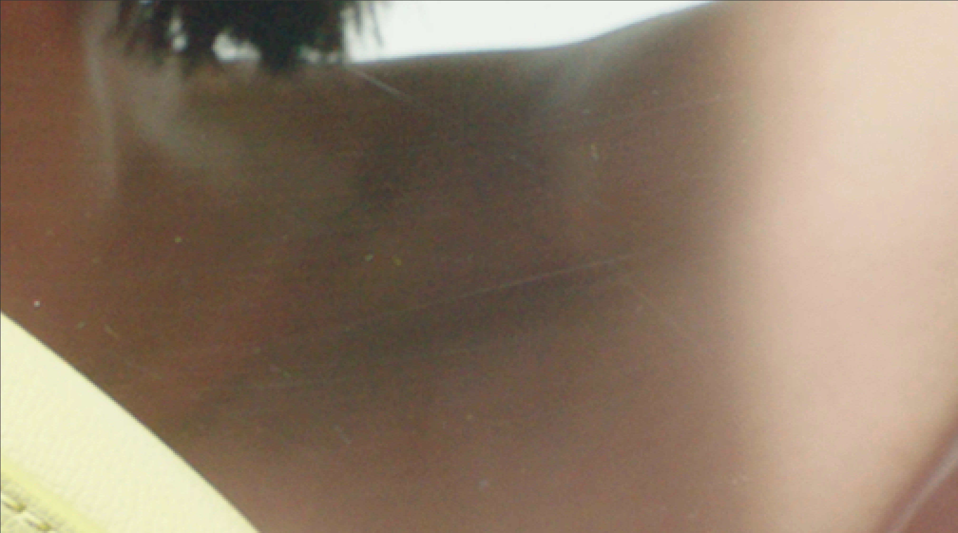

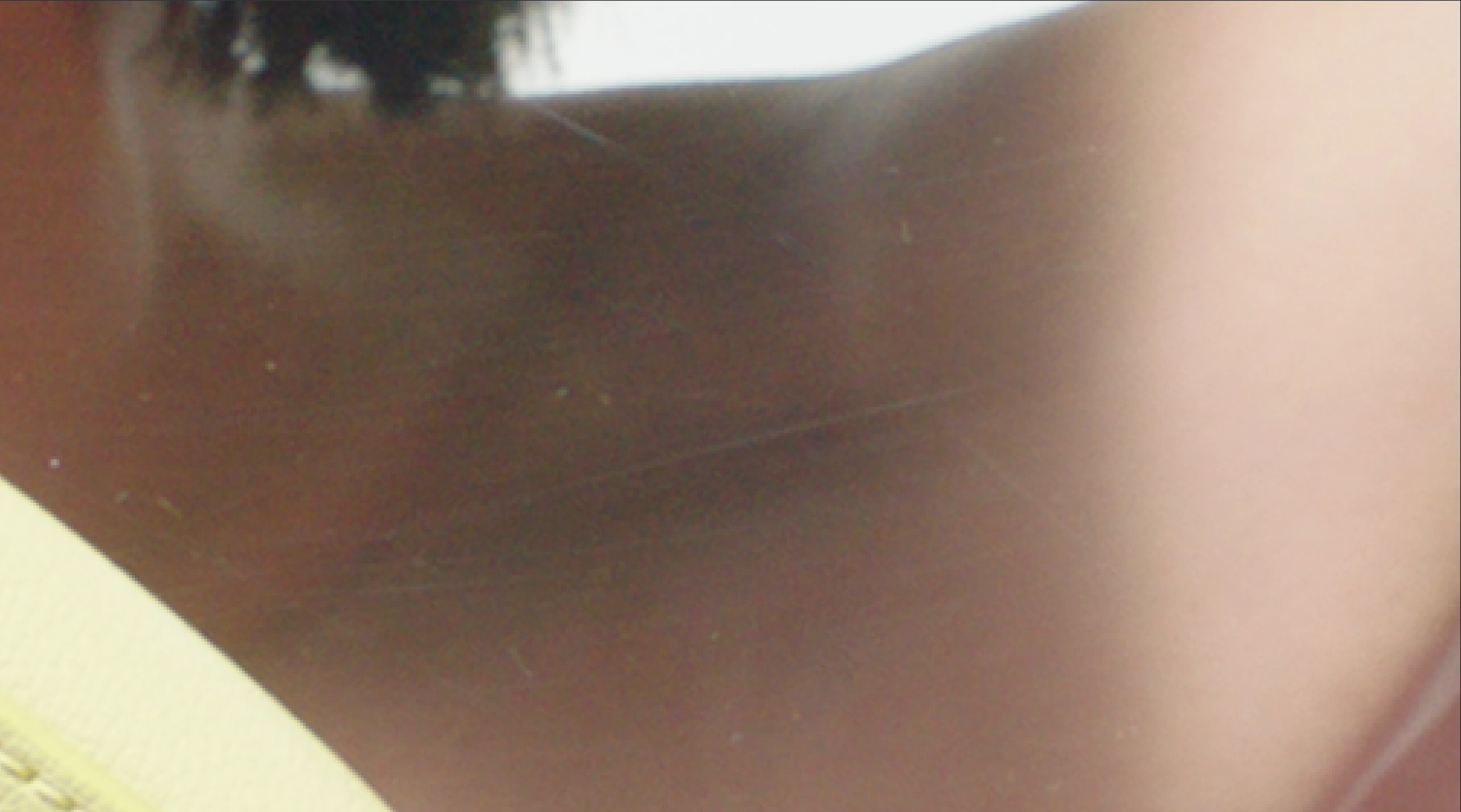

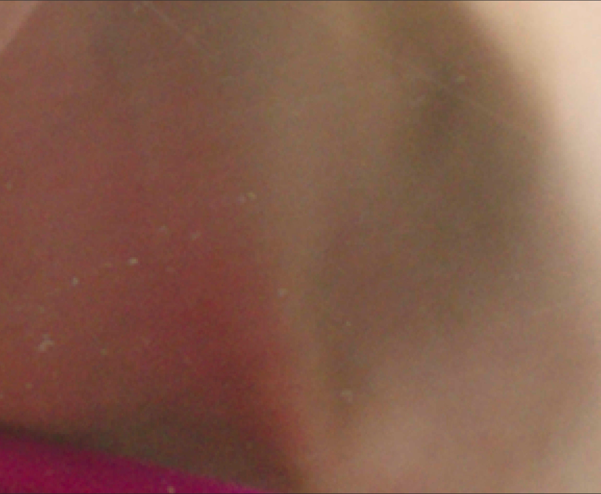

Oct 6, 2022 9:26 PM UTC
I came across this weird issue in AE 22.6 when working on post with master rushes. There appears to be a random flicker changing hue from magenta to green every now and then. It's very random though.
Does anyone have the same issue? I heard rumors about some bugs in AE with M1 macs involving ProRes files and some issues with bit depth when rendering ProRes but not sure if this is related?
I attach 2 frames for reference. For the best comparison please download and flick between images as it's very subtle but it's definitely there.
Opening the projects in the older version works fine and I didn't notice any flicker.
I'm about to test the new beta version and see if the problem persists.
Any idea how to fix this in latest version of AE?
It would be great to have this addressed by Adobe team please!
