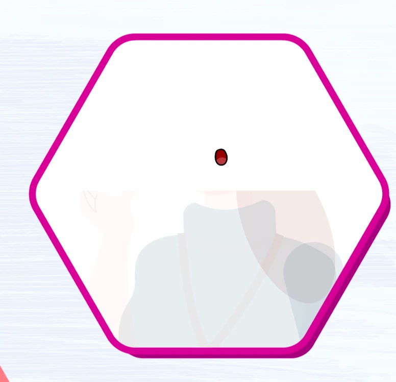

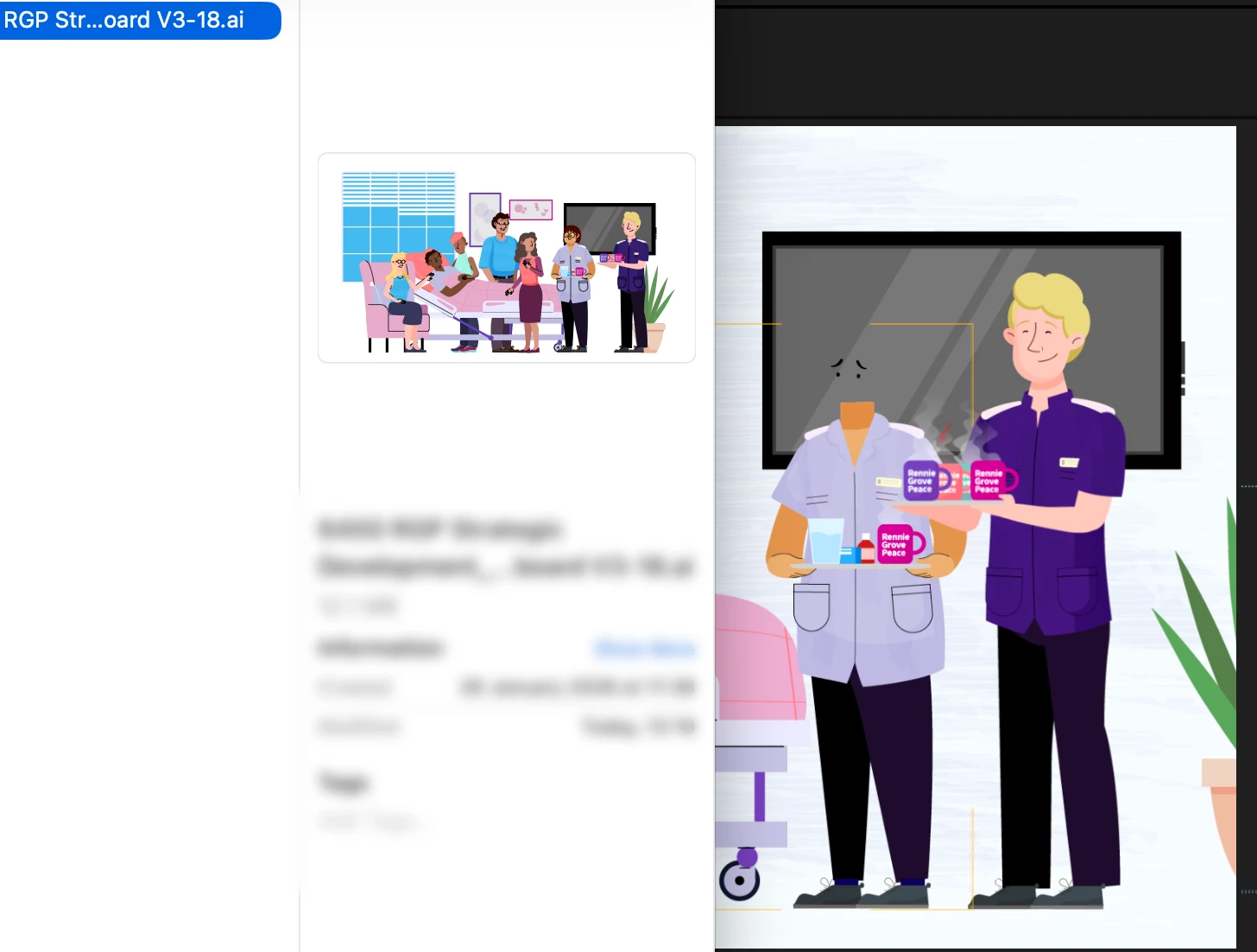

I noticed after the latest V26.0 update this issue kept popping up. Case in point, after I've imported my illustrations into AE, random layers seem to disappear even though they are still there in the illustrator file. As you can glimpse from the thumbnail the head of the character is still there but disappears in the AE comp.
The solution is for me to open the illustrator file, click save again and wait for the link to update in AE. Trouble is random layers from other illustrations would again disappear every time I open my AE file again to start my animation.
Another issue is that the blend mode from illustrator is not pulling through to AE, for example the neck shadow is multiply 40% but in AE it’ll just be Normal 100%. Then randomly it’ll correct itself or reset every time I restart my AE.
The obvious solution is to create shape in AE but I have textures in my illustrations and it’ll be chaotic to redo the illustration just for 4 seconds of animation.
Hope there’ll be a patch soon for this issue!

    Can confirm the mere act of opening Illustrator causes the glitch. I opened an .ai file to quickly do something unrelated to the linked files, come back to my still running AE to discover a different missing layer, except this time the opacity is also affected.
    This issue goes away after I’ve restart the AE. But it has made me very paranoid and I'll have to make sure to close my AE before working on Illustrator, finish up illustrator and close it before starting my AE projects.
