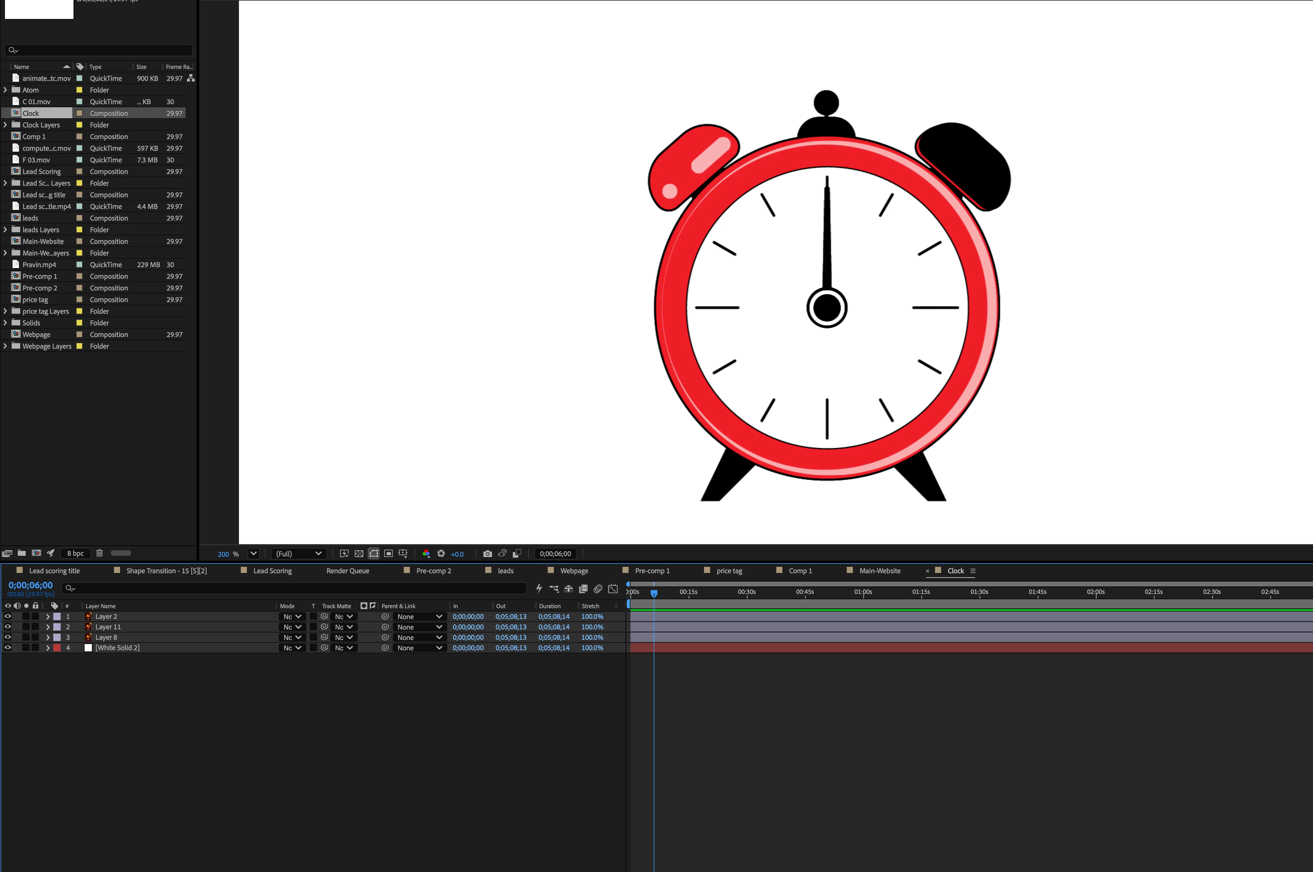

Importing bug with latest After Effects/Illustrator
Since updating apps last week, any Illustrator files imported to After Effects include duplicates of each layer that are blank 1x1px. As they also duplicate the layer names, this leads to layers "disappearing" later when reopening/editing files as they've re-linked layers to these "blank" layers.

I'm importing with "Import As:" set to "Composition - Retain Layer Sizes"
Nov 20, 2025 11:51 PM UTC
When importing Illsutrator files into After Effects as compositions (retaining layer sizes), all layers are duplicated and the first of each one has no content.
I'd like to know if anyone else has this issue with the latest update of AE (V 25.6.0 (Build 101)).
