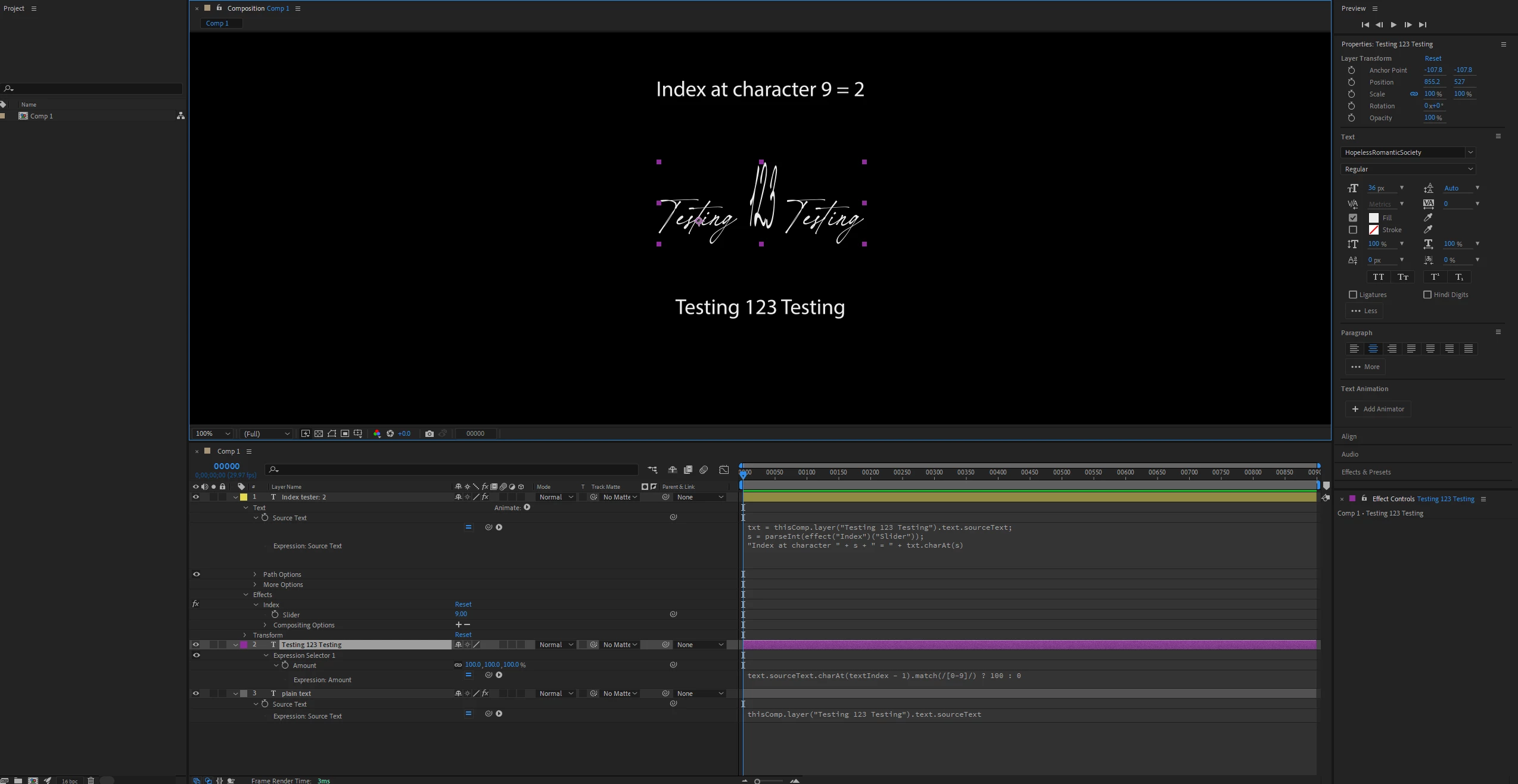

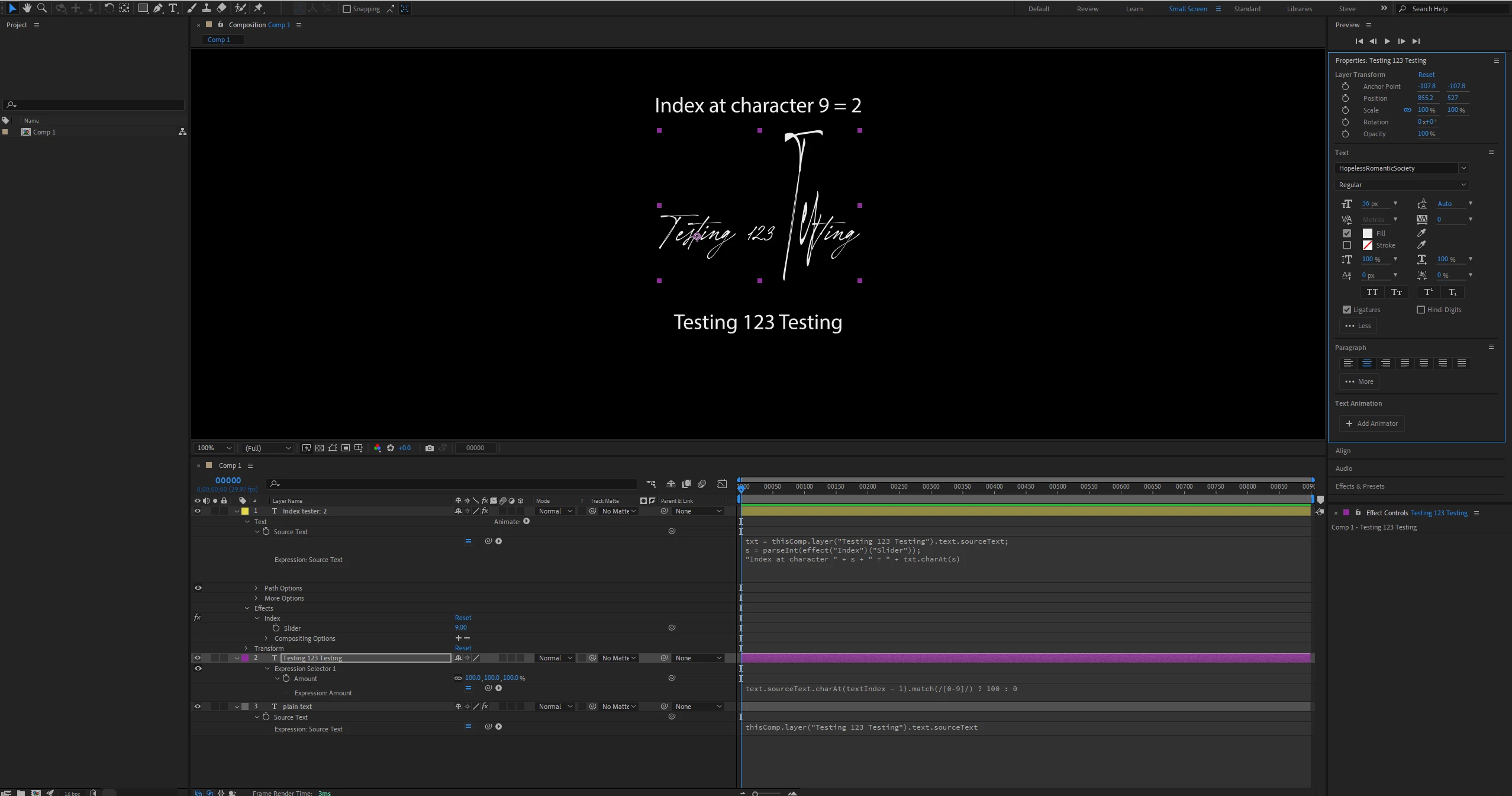

Herbie444Author
Jun 1, 2025 4:12 PM UTC
I swapped to a different machine and made a new test with screenshots of what's happening before and after the ligatures checkbox is enabled (AE 24.6.6).
As you can see, the indices aren't changing (yellow layer) when enabling or disabling however that expression is not reading the textIndex correctly (purple layer).
New machine specs are:
AMD Ryzen 9 9950X 16-Core Processor
192 GB DDR5 RAM
Nvidia GTX 4090
Windows 11 Pro Build 26100.4061
