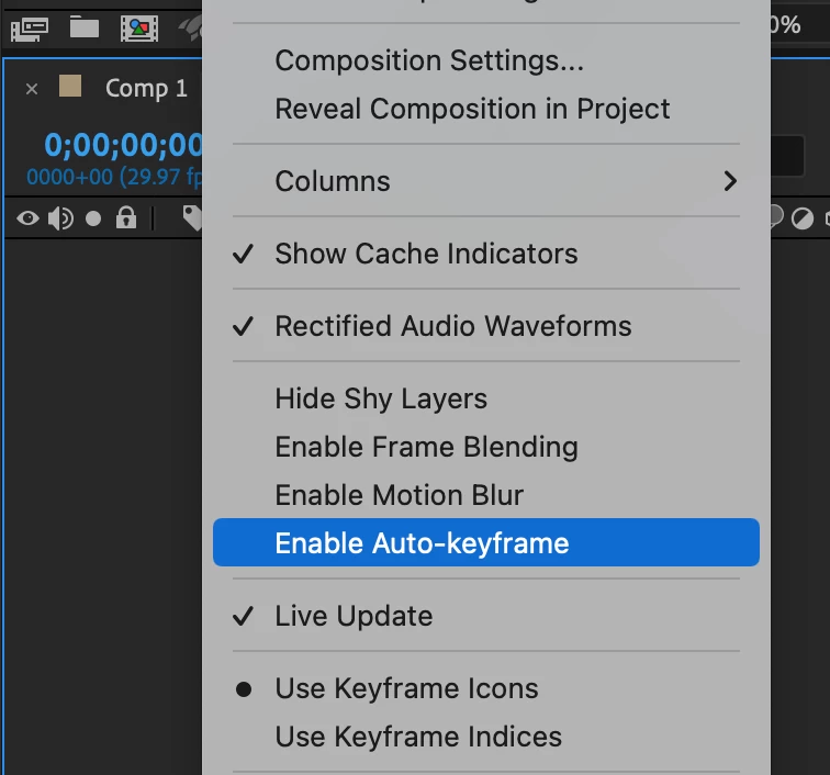

O auto-keyframe não desativa com clique como antigamente.
I haven't used this feature in a while, but I remember that it was possible to simply click on it to activate and deactivate it. This was very practical for work. I'm sure it worked, and I still see it in tutorials and courses. Now, to deactivate it, you have to go to the display configuration and remove it from the bar, otherwise it is always on. Every time you use it and stop using it, you have to go to the display configuration. Why did they change that? Or is this a bug? One of the reasons, I think, for the tool was the practicality of programming animations quickly, for any transformation... changing the mode with just one click. As it was once possible to turn it on and off with just one click, it seems to me more like an unresolved malfunction, rather than a purposeful change. Is there anything to do? Thanks

Hi @Maiko16B8,
Thanks for making this report. Yes, the Auto-Keyframe mode was removed from the Timeline intentionally several versions ago. It can be accessed in the menu in each tab of the Timeline:
Once enabled, it will show up in the Timeline. As mentioned, the majority of customer feedback we received indicated that the feature was not in common use and so it was moved to the menu to allow more room for other elements in the UI.
Thanks again for your feedback,
- John, After Effects Engineering Team

Nov 3, 2022 4:02 PM UTC
People hated it and thus the auto-keyframe button was removed and the option turned off by default. You're literally one of the few people who actualyl seem to have used and loved it.
