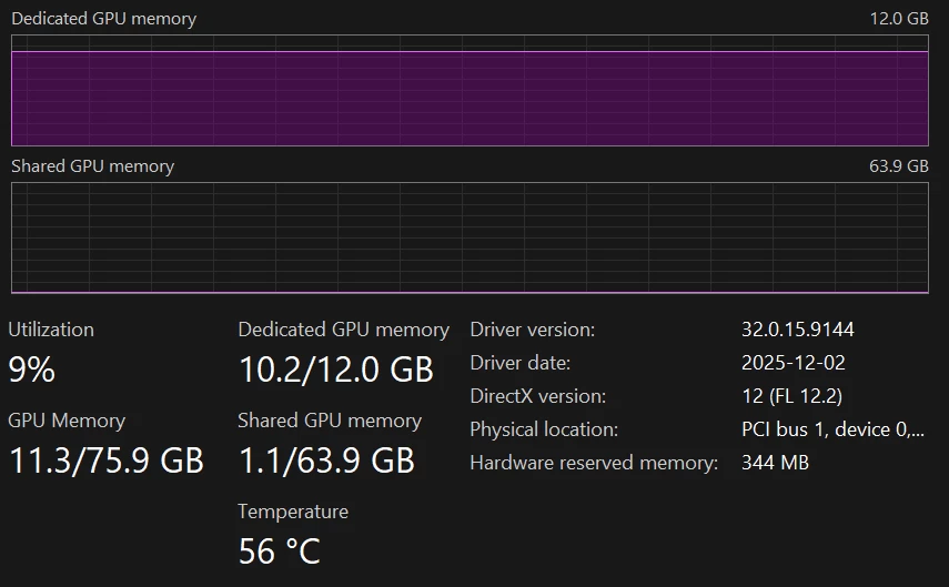

Problem: A project from 6 months ago suddenly crashes upon render and during previews from out-of-memory errors. (May 2026)
Suspects:  Nvidia driver update, Win11 update, AE2026.02 update
Current conclusion: Dedicated GPU memory is not getting cleared. This results in an immediate crash the next time I try to render again. Screens start to go black, workspace won’t preview.
Current workaround: Open Process Monitor and watch the dedicated GPU memory. I have 12GB on my Nvidia 5070.  Then, open your project in Media Encoder (just because it seems faster to me this way) and render a PNG sequence so you can capture the partial render. Start the render, watch the memory peak out at about 80%, and the render fail.  GPU memory doesn’t release until I quit AME. Re-open AME, try to find an approximate frame where I crashed (where are the frame numbers?!) and restart the process.

What OS are you on? If you’re on a Mac, the memory management and usage differers considerably, so it’s hard for me to comment. On Windows 11, take a look at your Dedicated GPU memory. (CTL-SHF-ESC, then Performance tab).  Your Dedicated GPU memory should vacillate up and down as garbage collection does it job.  If it goes up (esp during render) and never comes down unless you crash or restart AE, then you have the same issue.
Note that this is not related to the different purging we can do for disk caches and RAM (as far as I know.)   You’ll know you definitely have a problem if switching projects (without restarting AE) provides no garbage collection (release of and decrease of the dedicated GPU memory).

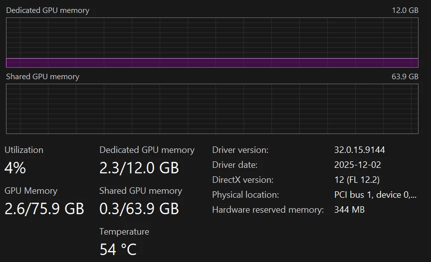

I opened AME to verify that the problem exists there as well. (AE is still open).
AME crashed the render, but didn’t crash the app.
Closed AME. GPU ram released!
But… back in AE I now get black screens despite closing/opening the project, clearing all cache, etc.
And GPU memory is back down to 2.6 (supposedly)!   Not healthy!
