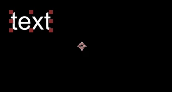

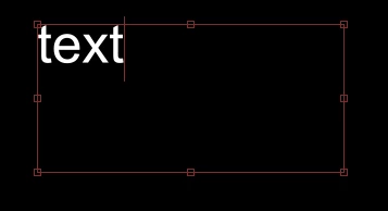

Why do you think it's old code ? Are there other ways to do the same thing ?
The use case is to control the position of the paragraph programmatically.
In fact I just found out there are 2 ways to create text layers, regular text layers (just a click with the text tool), and paragraphs (click + holding) and that they behave differently on the anchor point management.
Controlling the anchor point of a regular text layer is accessible with the help of sourceRectAtTime().
For the Paragraph, I figured out there was not only the anchorPoint but another data which could be seen as a (2nd/sub-)anchor point (boxTextPos).
I was searching ways to move programmatically this anchorPoint, and found boxTextPos here https://ae-scripting.docsforadobe.dev/text/textdocument.html#textdocument-boxtextpos .
In AE 23.6.2, I couldn't set boxTextPos with negative components ([-1, -1] = crash), but when we create a paragraph layer, the anchor is by default with negative components ([-250, -50] for example).
It was fixed since, in AE 24.4.1 negative and positive values do work, but doesn't work with [0, 0].
