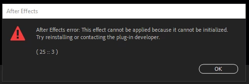

I got upgraded to 24.5. Can anyone confirm if any plug ins have stopped working for them?
I'm getting an error using the Red Giant 11.1.9 Keying Suite plugins (Edge Blur, Light Wrap, etc.) saying that they can not be applied to a layer.

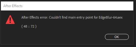

Downgraded to 24.1 and got the following error on startup.

What version of AE were you running previously that worked with these plugins and was it on this same system? Did you change other things about the system, like updating your OS?
It could be that something AE installed before with our application, or the OS installed, like a windows runtime component, isn't installed anymore if AE or the OS itself doesn't need it. It might need to be installed independently now or bundled with the plugins that needed them. An example of a component like this, is the Visual Studio Runtime.
You could try reaching out to Red Giant, as they might already know if there is a specific component that needs to be installed, and/or you could try installing older additional Visual Studio Runtimes, though that may not solve your problem.

I did already remove and reinstall the plug ins to,unfortunately, no avail.

but if you get that from trying to start up a project that you opened, even briefly, in a newer version, but you can start a new project in the new version and use the plugin normally there, there could have been changes applied to the project's internal format by AE's version checker and "mediator" which would corrupt it if you roll back, as previous versions have no concept of new versions, and AE unlike blender or similar, will throw errors instead of telling you "hey bud, we had to delete these unknown data blocks that are from a newer version". This is part of my gripe- and the likely issue you're having- file corruption due to opening in newer or older versions, is why larger production teams avoid adobe despite its excellent workflow and team tools- lack of acceptable version control tools and lack of acceptible legal terms for support on old versions. TL;DR- most likely it's not a bug, it's a feature, or intended lack thereof.
In the case that you can still open it in the new version, and at least view the affects that can't be applied in the panel;
you might be able to write them down, and copy the keyframe data to another software or window of AE. After that you delete the offending effects, then "reassemble" it in the old version.
(In the case that the plugin simply does not work in the new version, or the bug really broke things, you may need to uninstall the plugins, then reinstall after opening the "cleaned" project in the older version once.)
