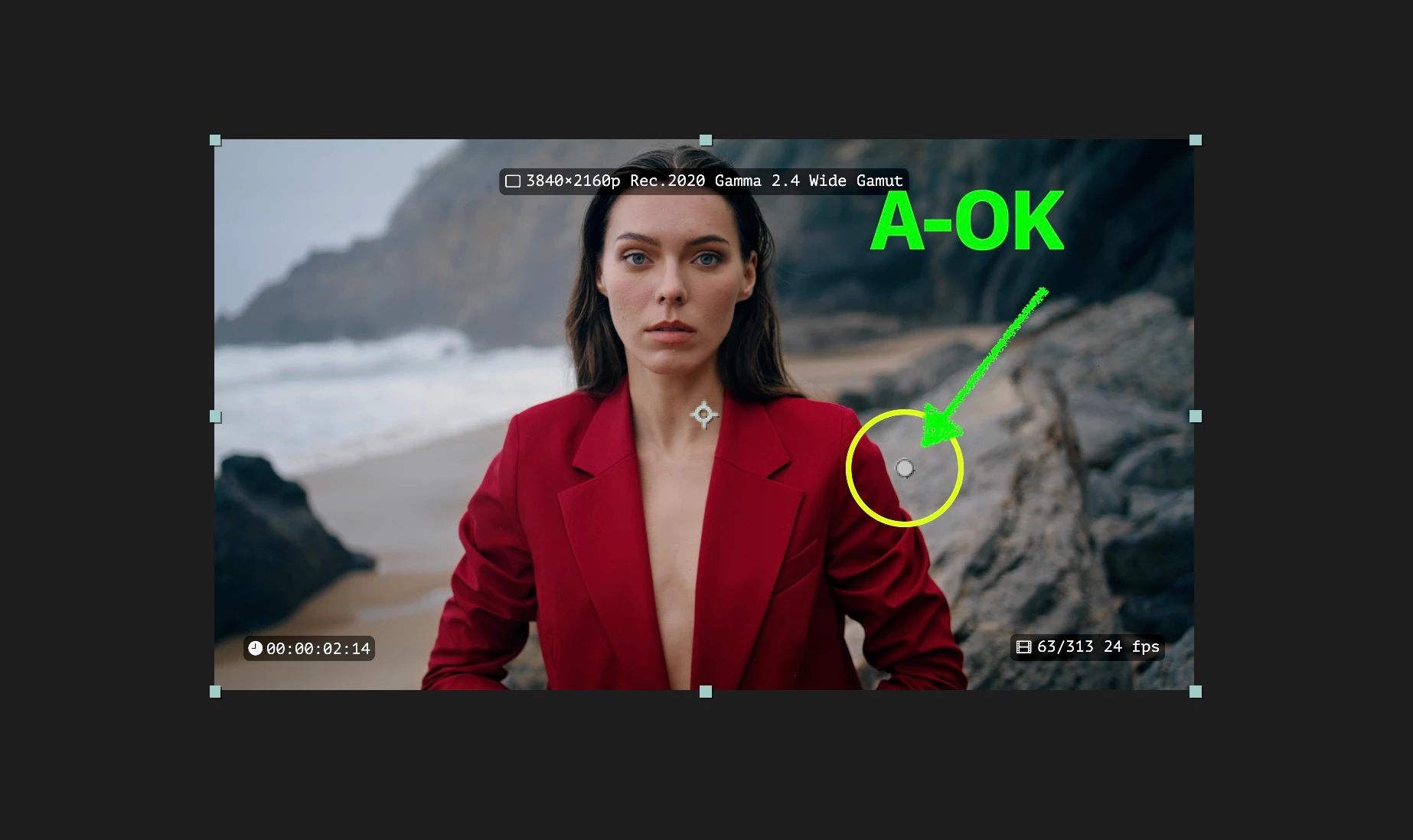

Here’s an example that works as expected. The following screenshot shows a plugin applied to a clip with the same dimensions as the comp. I'm using a couple plugins: Frame Info to display the frame size as seen by the plugin, and a Circle generator (under FxFactory Pro Generators) to render a yellow circle at a location specified by a point parameter. It checks out:

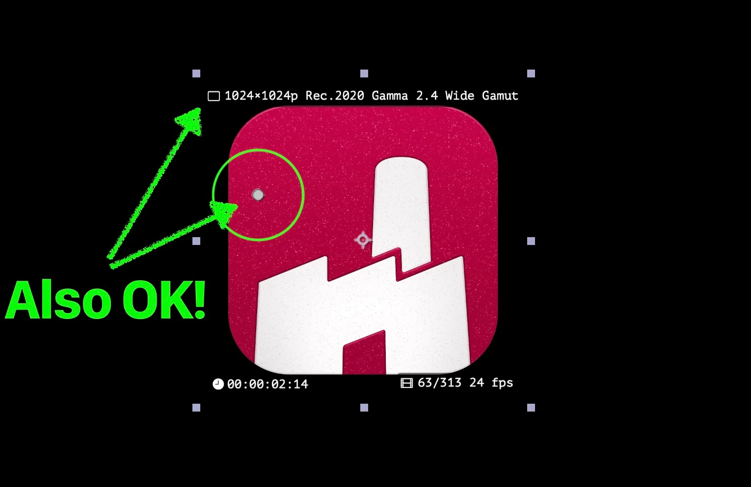

What if the plugin is applied to a still-based layer with different dimensions? Things are still OK. Layer dimensions and point coordiates are still what they should be:

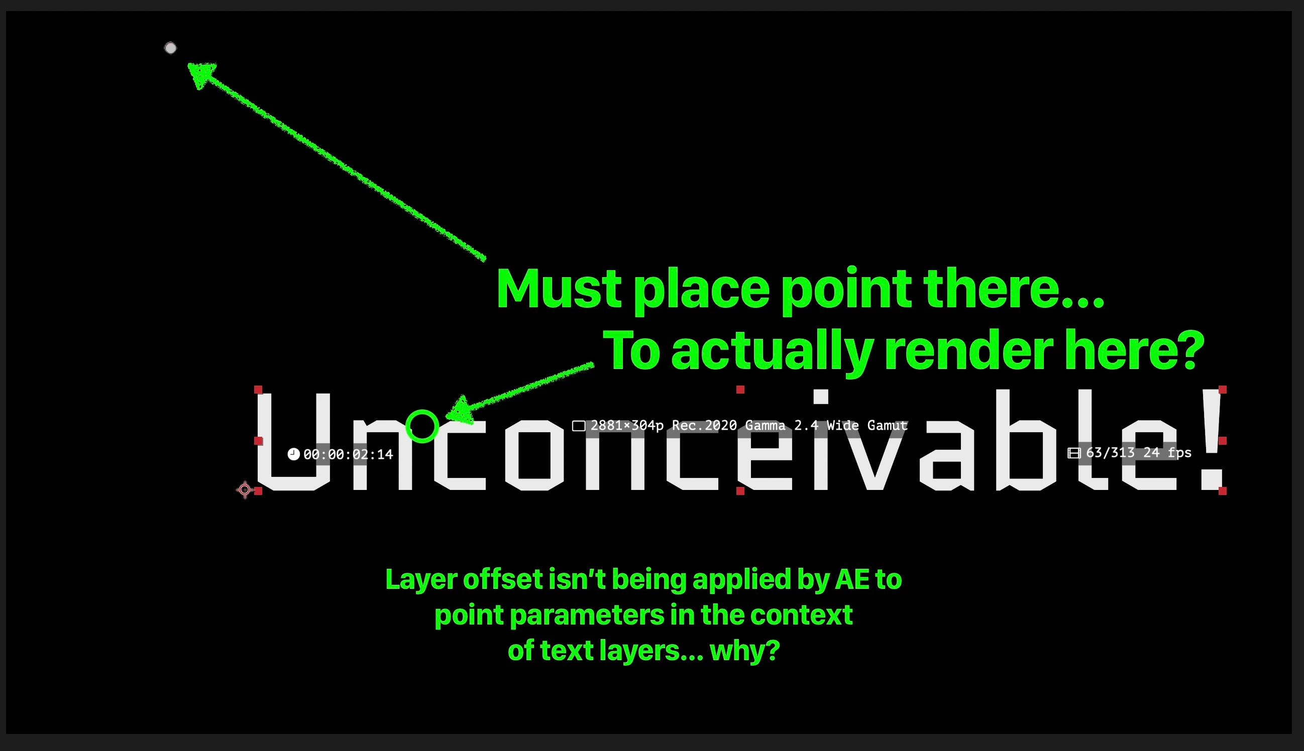

...and here’s where the confusion begins. When applied to a title, the layer dimensions are correct, but the point coordinates are relative to the top-left corner of the frame. They should be relative to the layer, but they are not:
Under all these scenarios, AE appears to be setting the origin_x/_y members of the output PF_LayerDef correctly. But whereas the offset appears to be automatically applied to point coordinates in the first two cases, AE is not applying the offset in the third case (title layer).
Am I seeing this correctly? Is this expected behavior? Shouldn't AE report the 2D point coordinates relative to the layer under all scenarios?

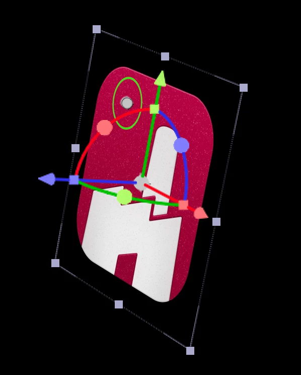

Things get extra wacky if you turn make these layer 3D. Again the first two scenarios work perfectly. AE correctly applies any 3D transform both to allow the user to interact with the rotated 2D layer... and conties to feed the correct coordinates to our plugin.

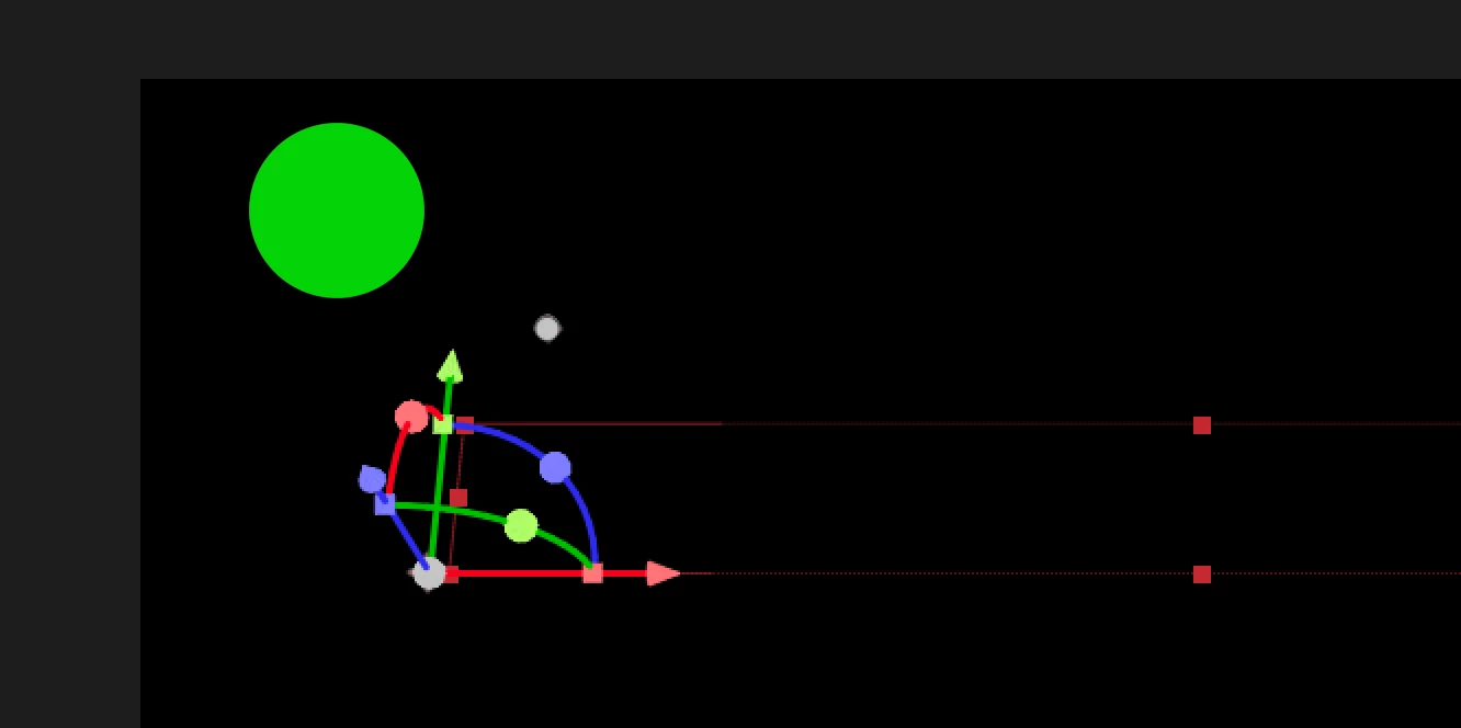

When turning the text layer to 3D, the results are downright baffling. The green circle, rendered by our plugin, doesn't even appear within the layer! How would it even make sense that the 2D title, rotated in 3D, suddently renders completely outside its actual area?

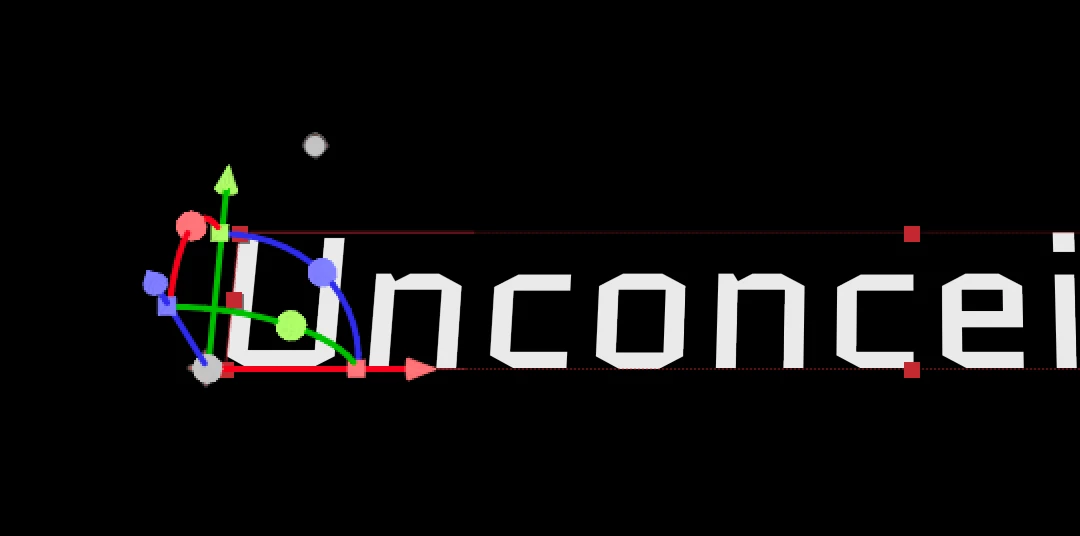

For reference, here is that same layer with the Circle generator disabled:
