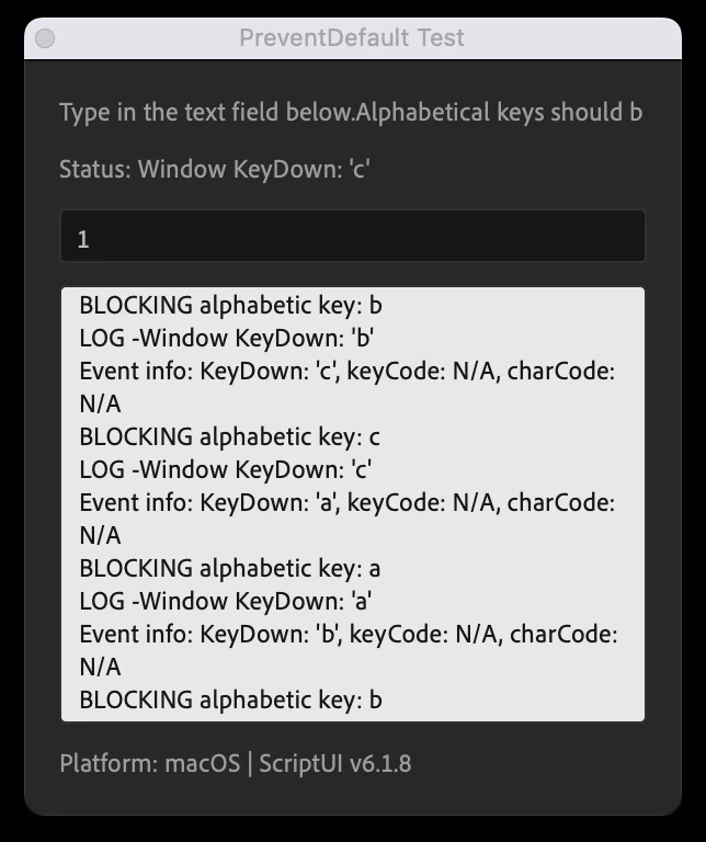

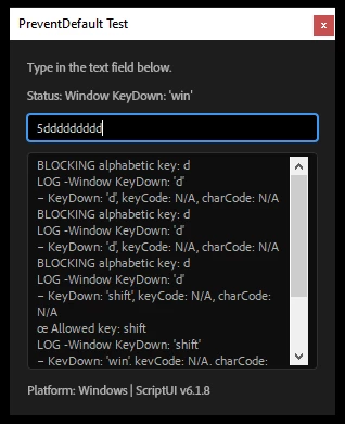

Hello.
I'm building a script UI panel as part of an extension that involves keyboard controls. I believe I've encountered a fundamental bug with the .preventDefault function/method, at least when assigned as an event listener to an edittext control object. In short, it only works on Mac—the method appears to be non-functional on Windows.
I've built a stripped-down derivative of the script I'm building that you can use to reproduce this bug at will. Below are screenshots of the panel on Mac and Windows and the differing behaviours.
Mac:
After Effects 24.6.1 - Ventura 13.7.3 (Intel)
Windows:
After Effects 25.1.0 - Windows 10
Example .jsx Script UI Panel:
 * PreventDefaultTest.jsx

    // Log window creation
    $.globals.preventDefaultTest.logMessage("Window created successfully");
    // Add keyboard event listeners to the text field
    textField.addEventListener("keydown", function(e) {
      var pressedKey = String(e.keyName || "").toLowerCase();
      var modifiers = (e.shiftKey ? "Shift+" : "") +
                     (e.ctrlKey ? "Ctrl+" : "") +
                     (e.altKey ? "Alt+" : "") +
                     (e.metaKey ? "Meta+" : "");
      var eventInfo = "KeyDown: '" + pressedKey + "'" +
                     (modifiers ? " with modifiers: " + modifiers : "") +
                     ", keyCode: " + (e.keyCode || "N/A") +
                     ", charCode: " + (e.charCode || "N/A");
      $.globals.preventDefaultTest.logMessage(eventInfo);
      statusText.text = "Status: " + eventInfo;
      appendToEventLog("Event info: " + eventInfo);
      // Close with Escape key
      if (pressedKey === "escape") {
        $.globals.preventDefaultTest.logMessage("Escape key pressed - closing window");
        appendToEventLog("Escape pressed - closing window");
        e.preventDefault();
        win.close();
        return;
      // Check for alphabetic keys and block them
      var keyIndex = indexOf(panelNS.alphabetKeys, pressedKey);
      var isAlpha = keyIndex !== -1 && !e.ctrlKey && !e.metaKey;
      if (isAlpha) {
        $.globals.preventDefaultTest.logMessage("BLOCKED alphabetic key: " + pressedKey);
        appendToEventLog("BLOCKING alphabetic key: " + pressedKey);
        e.preventDefault();
        return false;
      } else {
        appendToEventLog("Allowed key: " + pressedKey);
