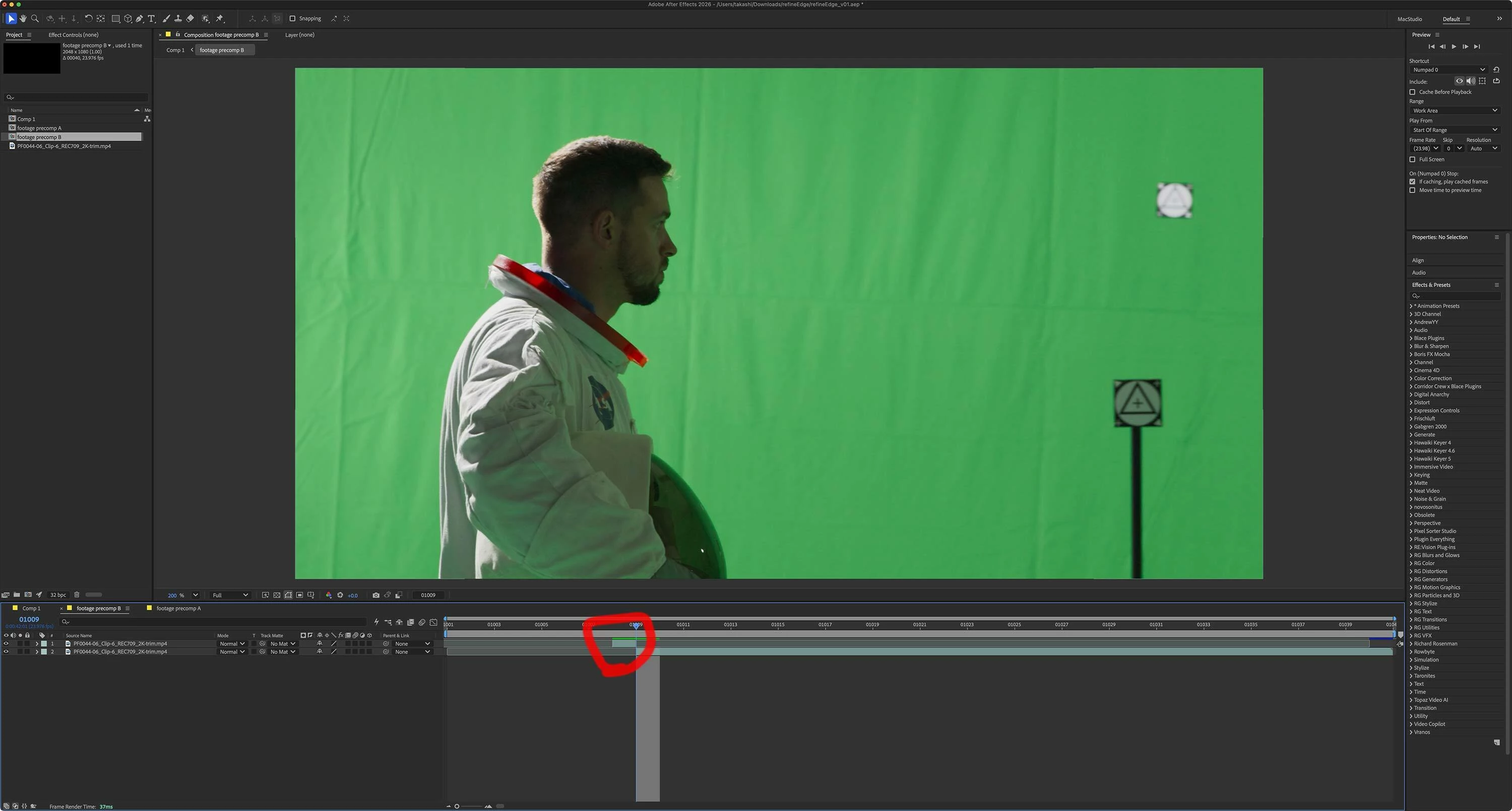

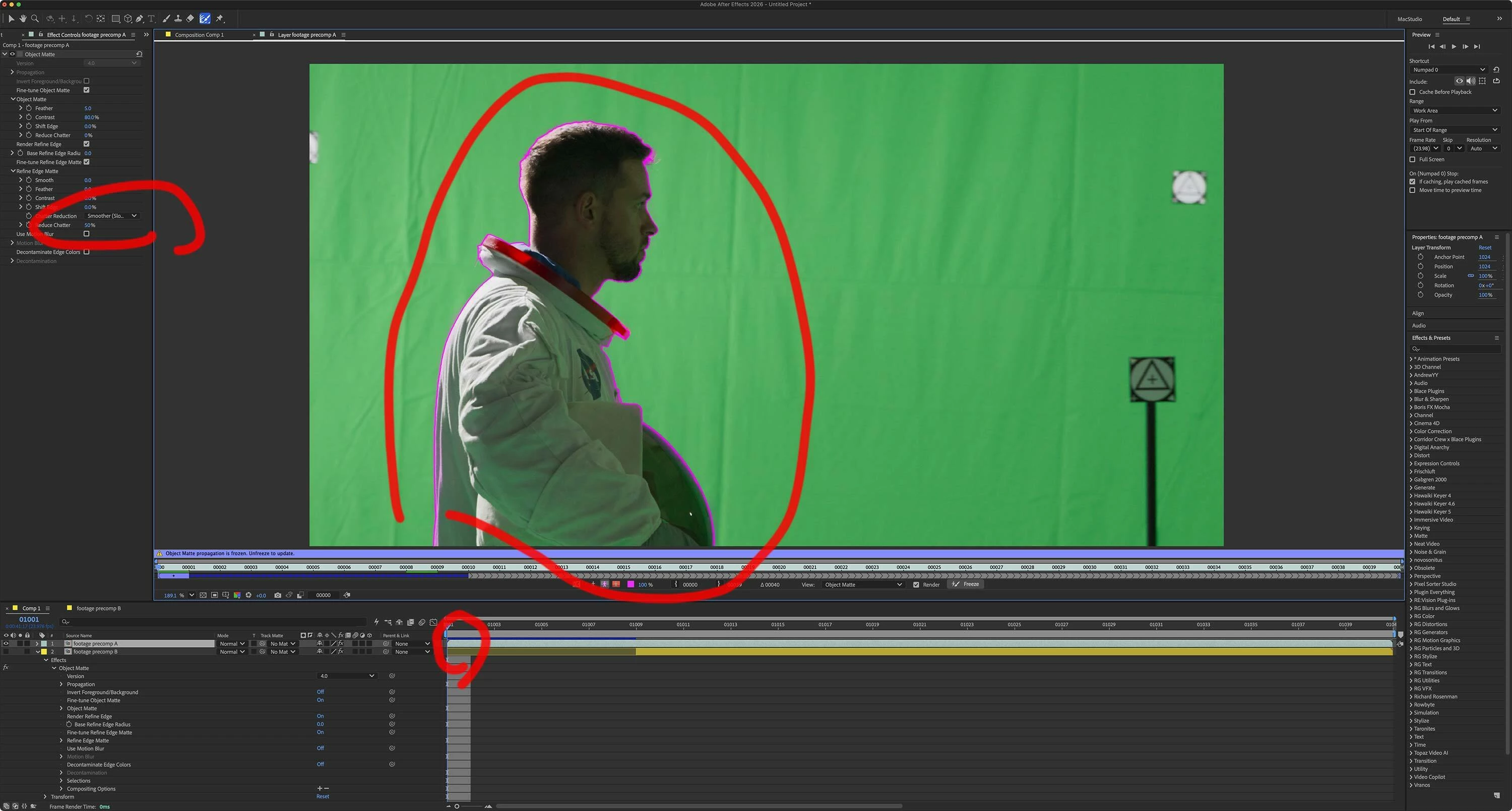

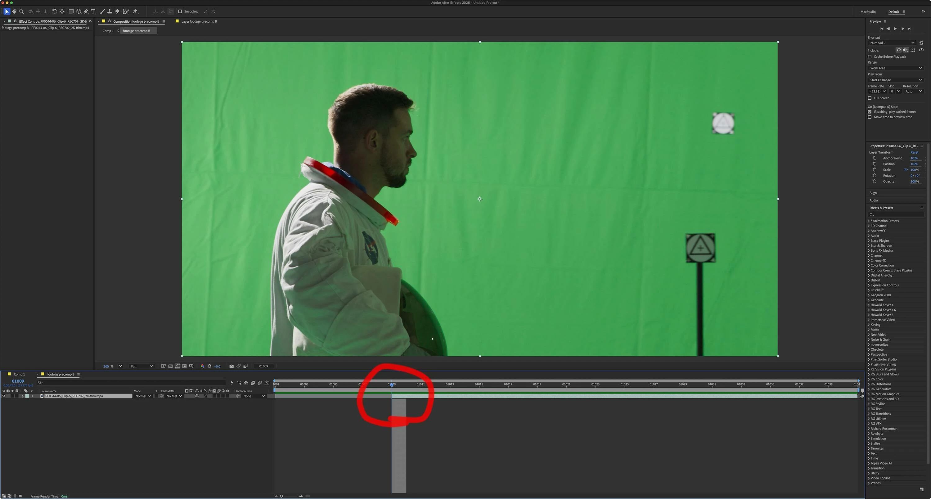

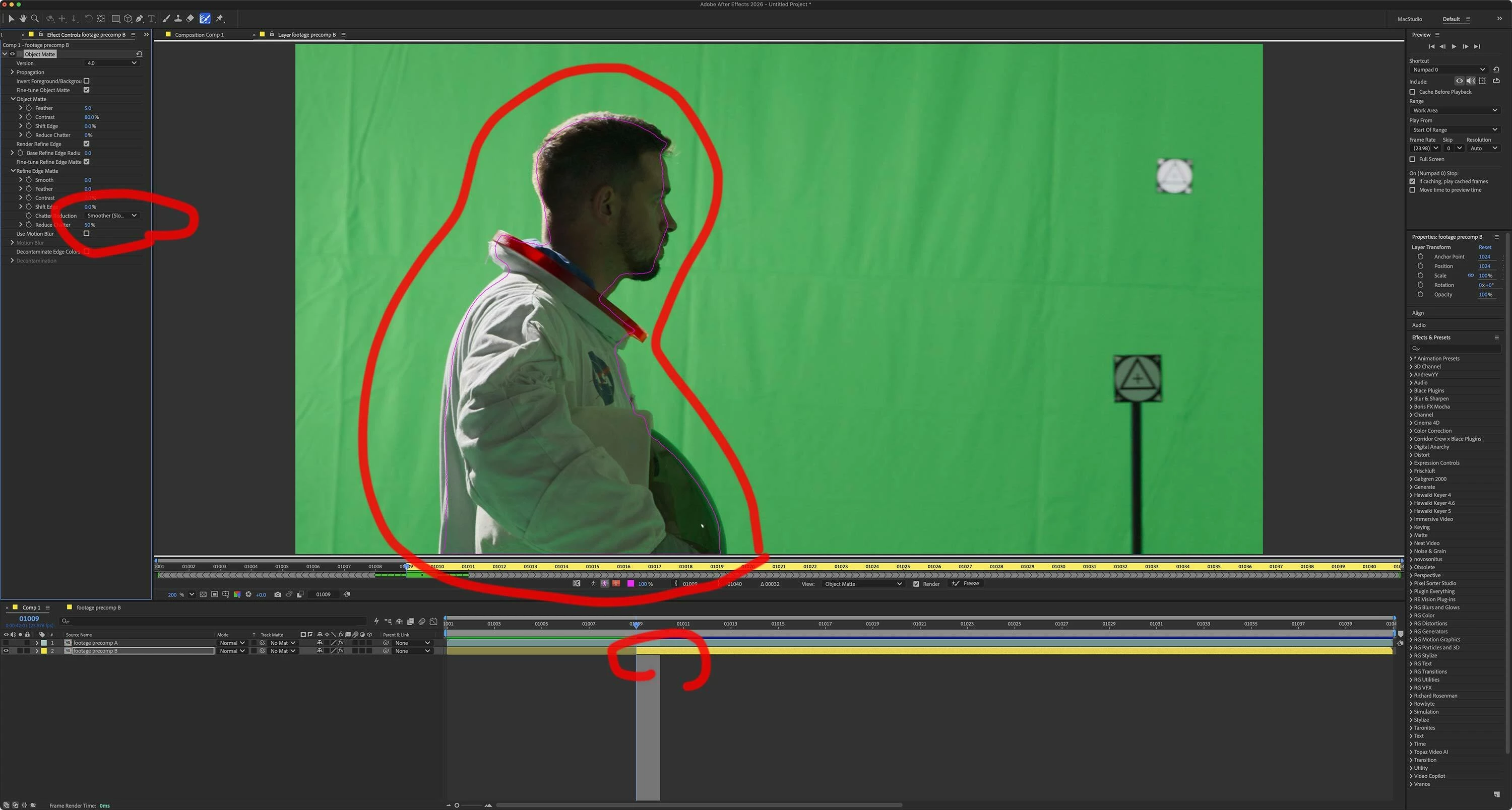

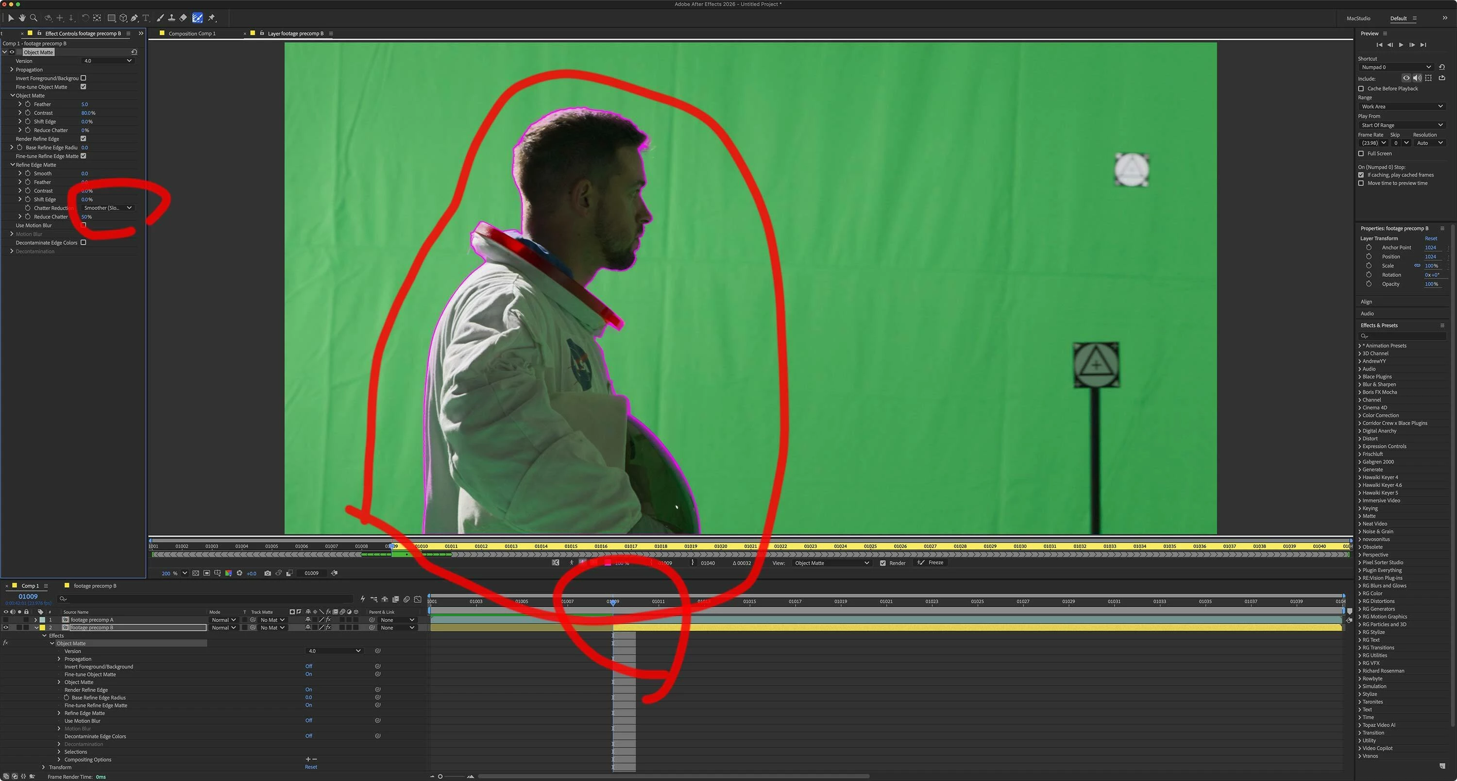

roto brush v4 Refine Edge Matte with Smoother first frame glitch if the precomp frame prior is blank
there is glitch in Refine Edge Matte with Chatter reduction Smoother selected.
it’s only happens if the precomp layer has blank frames. I'm guessing that Smoother option look for before and after frame for Chatter reduction. there is no issue if the roto brush is applied at the 1st frame or apply directly to footage that trimmed but frames exist,

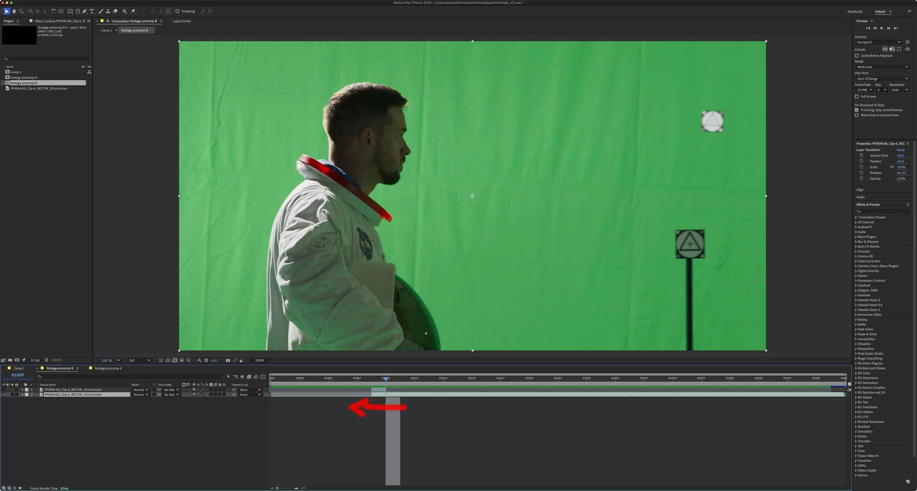

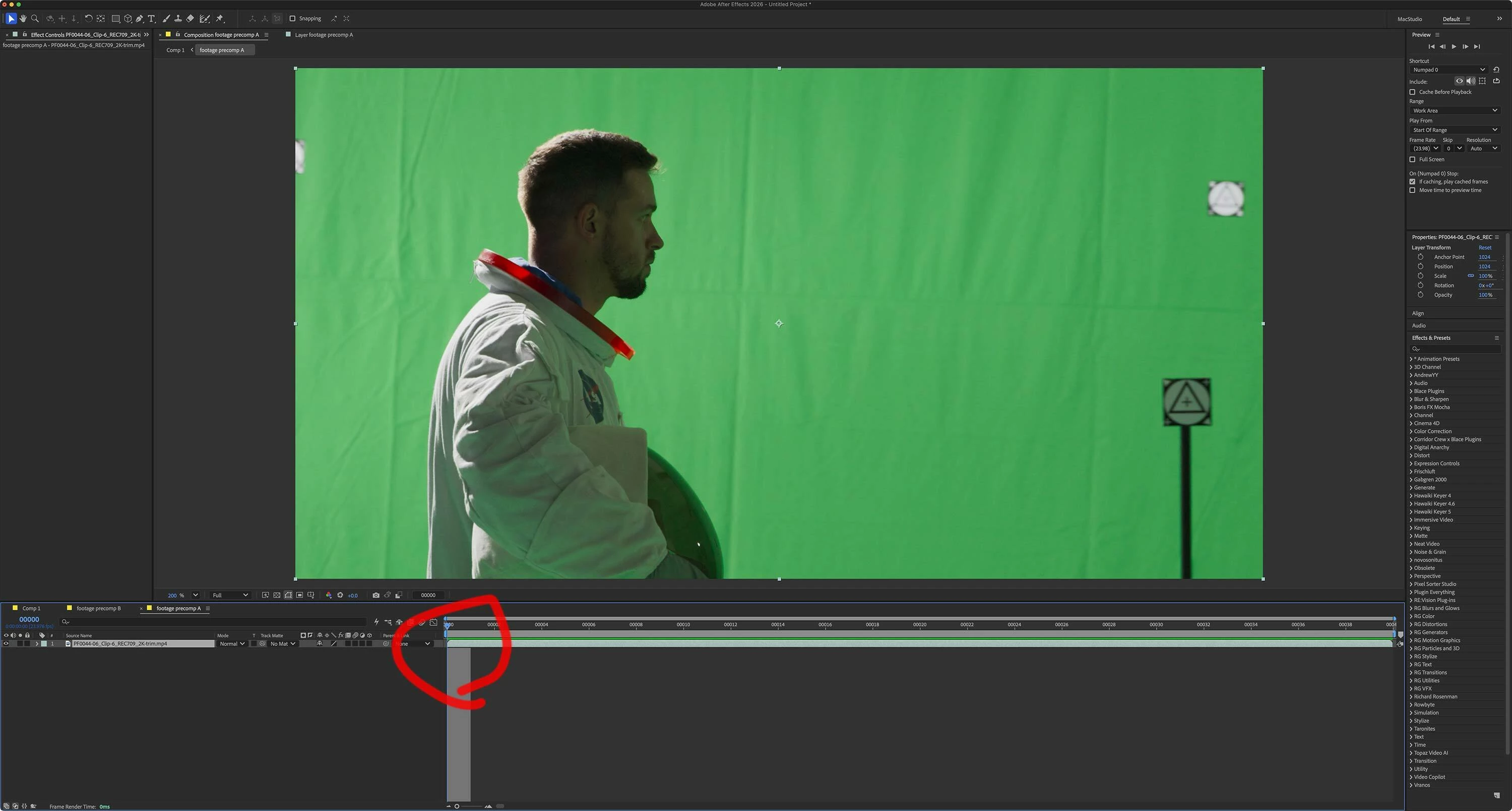

solution now is trim the precomp to footage length, add duplicate frame at frame before, extend head frames if you have.

    Hi ​@takashi vfx,
    Thank you very much for reporting this issue with Refine Matte in Object Matte. We are also able to reproduce this in our testing and we have now have a ticket open to investigate potential fixes.
    Thanks again,
    - John, After Effects Engineering Team
