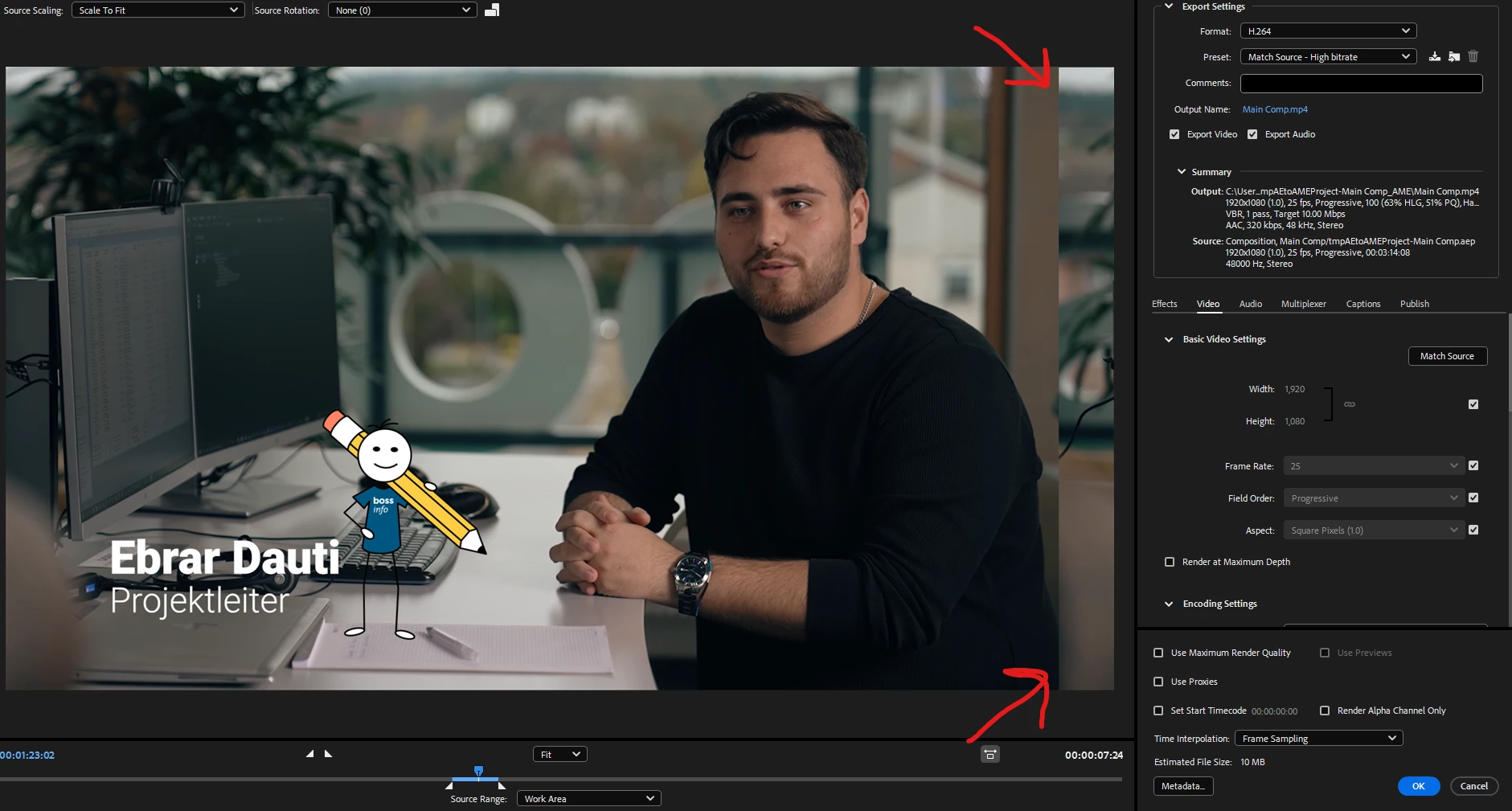

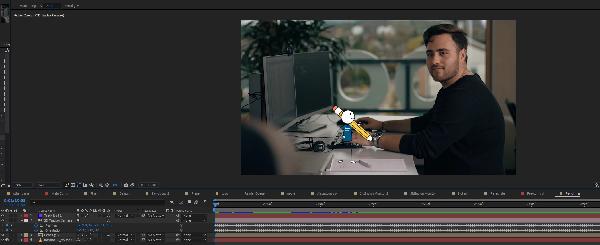

For some reason media encoder changes the position and repeats a section of my composition when exporting.
After effects Preview
Media encoder output
This issue occured when I tired to render the composition in Quicktime Format. It affects the output of the video, and when I try to switch back to H.264, the updated position+repeated edge persist.

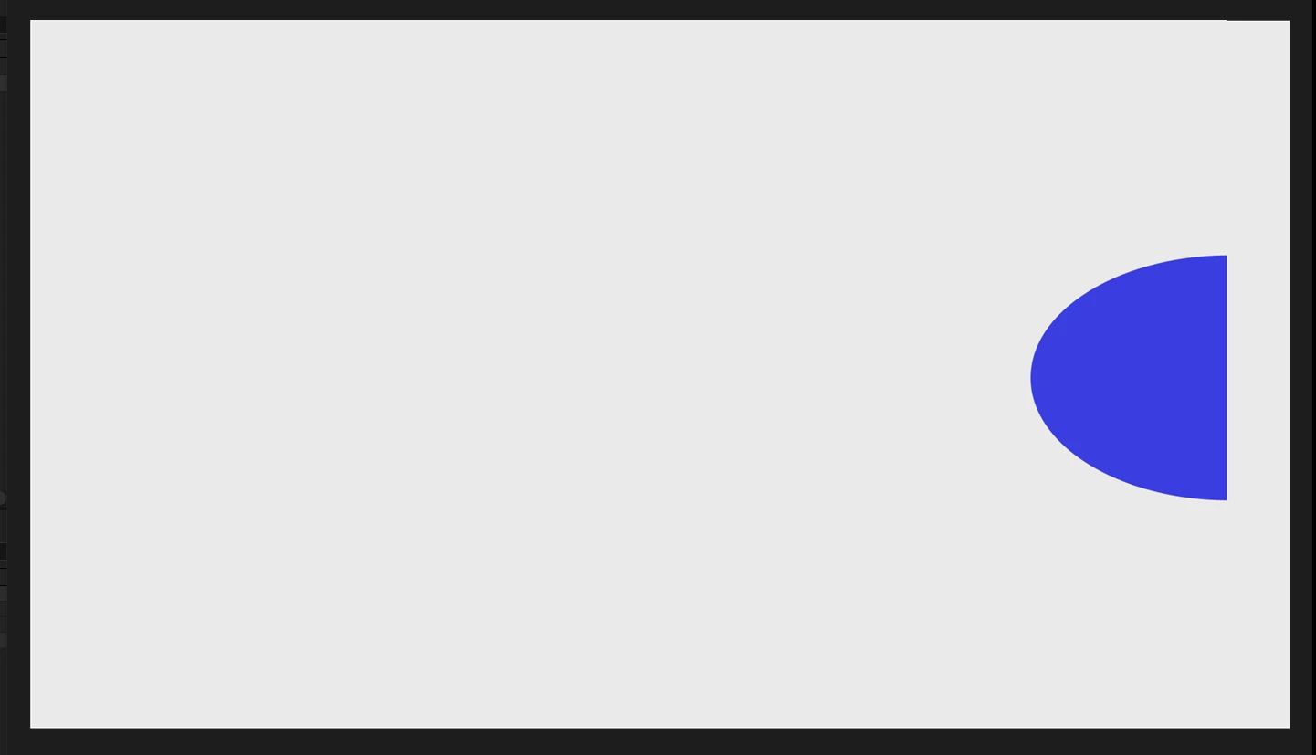

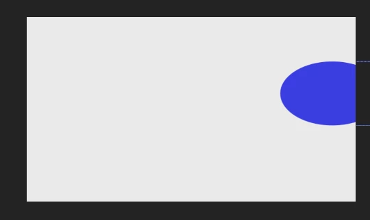

Here Is also a brand new project, with nothing but a solid & shape layer.
-As it appears in After effects
-As it appears in media encoder preview

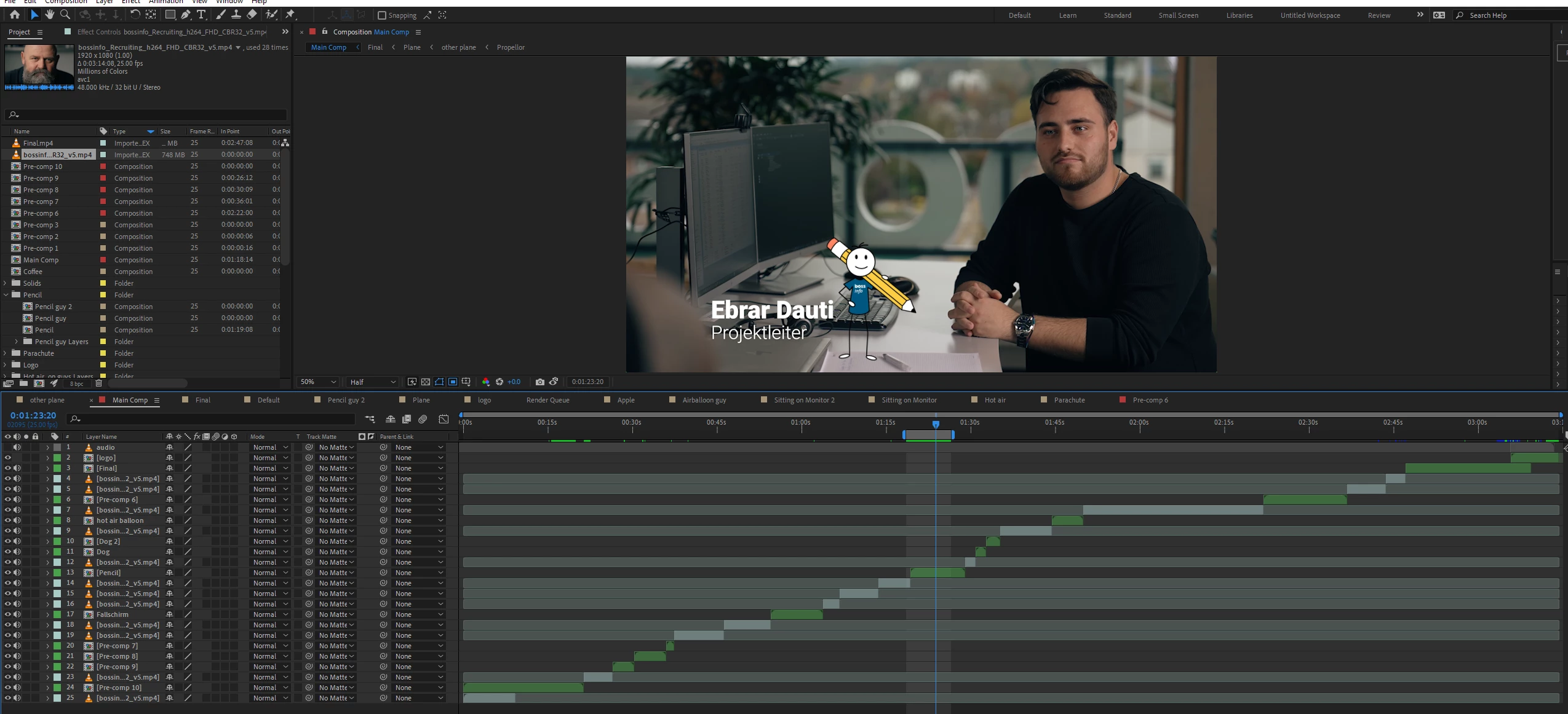

Hi Rick,
The aqua are unchanged video files, and the green are precomps with little animations tracked into the footage.
You can see that when viewing the same moment in Media Encoder, the edge mysteriously appears.
It appears over every single frame whether it's only the video or a nested comp.
I've discovered that the same problem is persisting in projects that i haven't opened in days too. Every export is messed up.  I appreciate your help.
