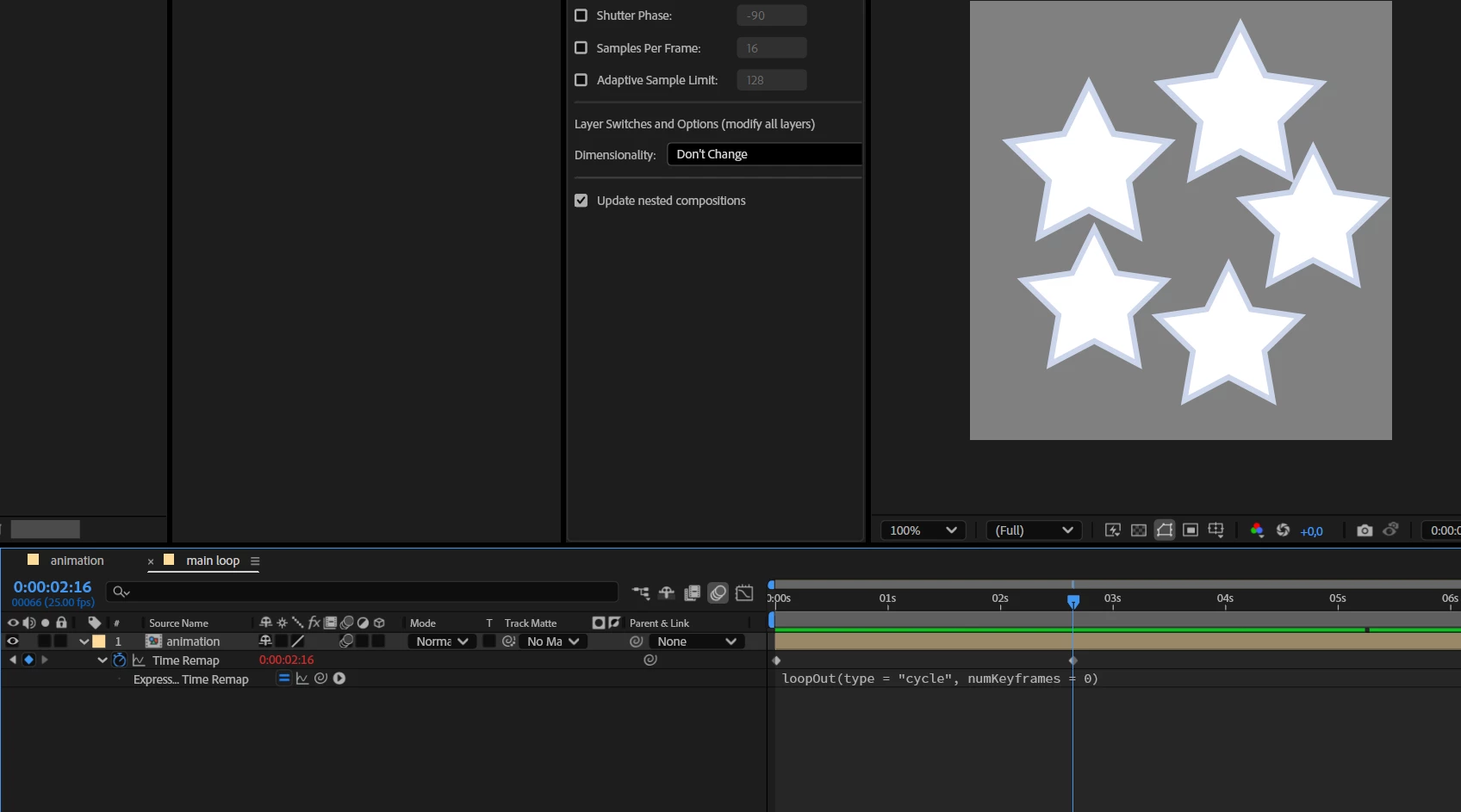

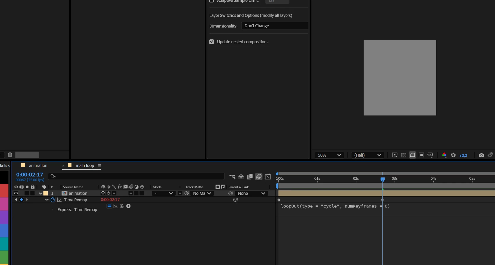

I found really interesting (and annoying) bug in simple use case of time remap loop.
When I use loopout on precomp with animation and there is NO continuous rasterize, AE make glitch at last timeremap keyframe which describes loop area. It shows frame somewhere from middle of animation instead of last-first one.. So loop is unusable, because it always have this oneframe glitch at the end of cycle. There is no timestretching, no effects, the same framerate.. just really simple animation (without any keyframes, just offseted layers) which need to be looped.
When you enable "Mr. Sunny" (continuous rasterize) switch on, everything is OK and loop working like a charm.
I prepare simple project where you can test it. Just put playhead at 2nd keyframe of loop and switch the switch, you will see..
It was tested in all latest major AE versions (23,24,25) and result is the same.
I attached screenshots without and with rasterize switch on and also project file (AE 25, but as I said, it does not work in any AE version from 23)

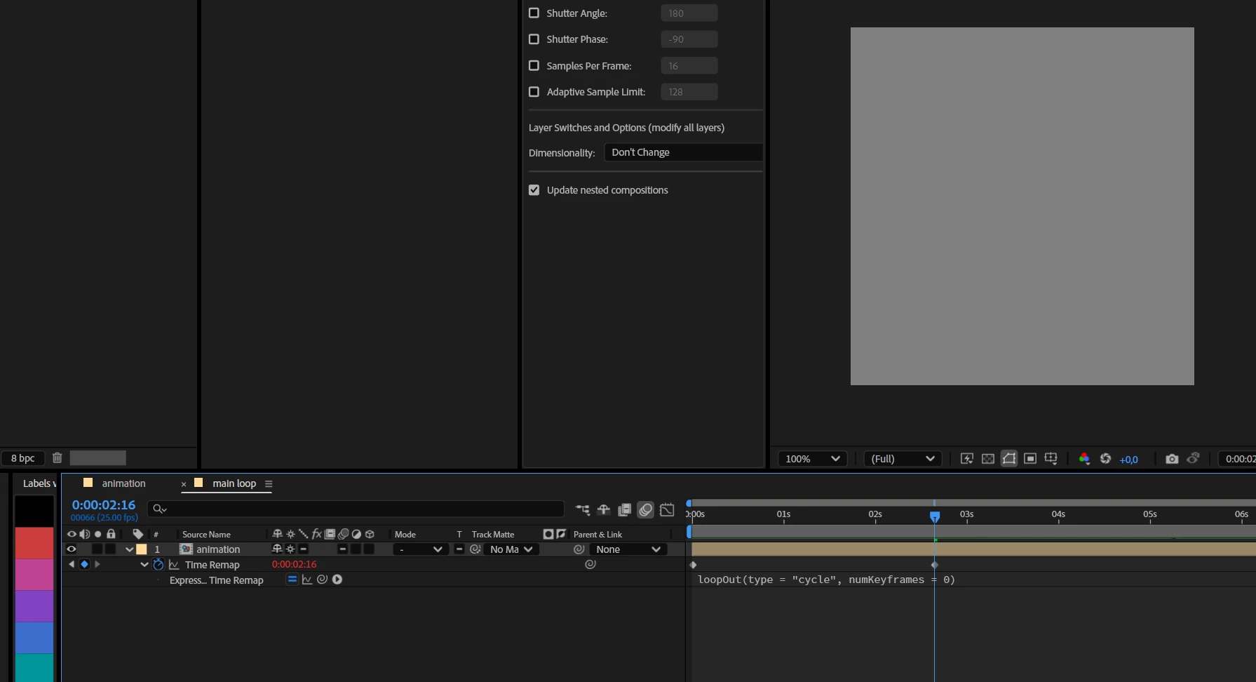

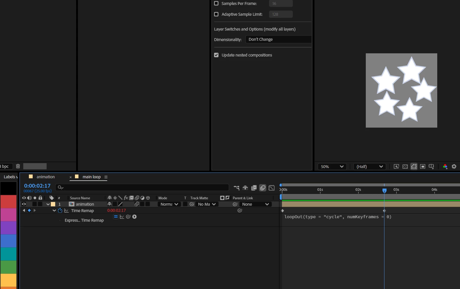

I tried exactly solution you mentioned, it was first thing which became to my mind. But it did not work. It always shows five stars at last keyframe, no matter where in timeline the keyframe is... There should be frame with no stars.
So it looks like it is bug. It does not make sense why to show at stricly defined time frame from middle of the composition. There is no logical reason for this behavior by my opinion.  you can try what you suggest. I bet it will not work. (I tried it again, screenshots attached)
It also not make sense why it works when "sun"  switch is on (it shows empty picture as was inteded) and not work, when you disable it (shows five stars what is state from middle of precomp).
And, yes, it is really as I told you..
I put new keyframe to 2:16 and then deleted one at 2:17. It seemed to be OK.. for a while.. 😄

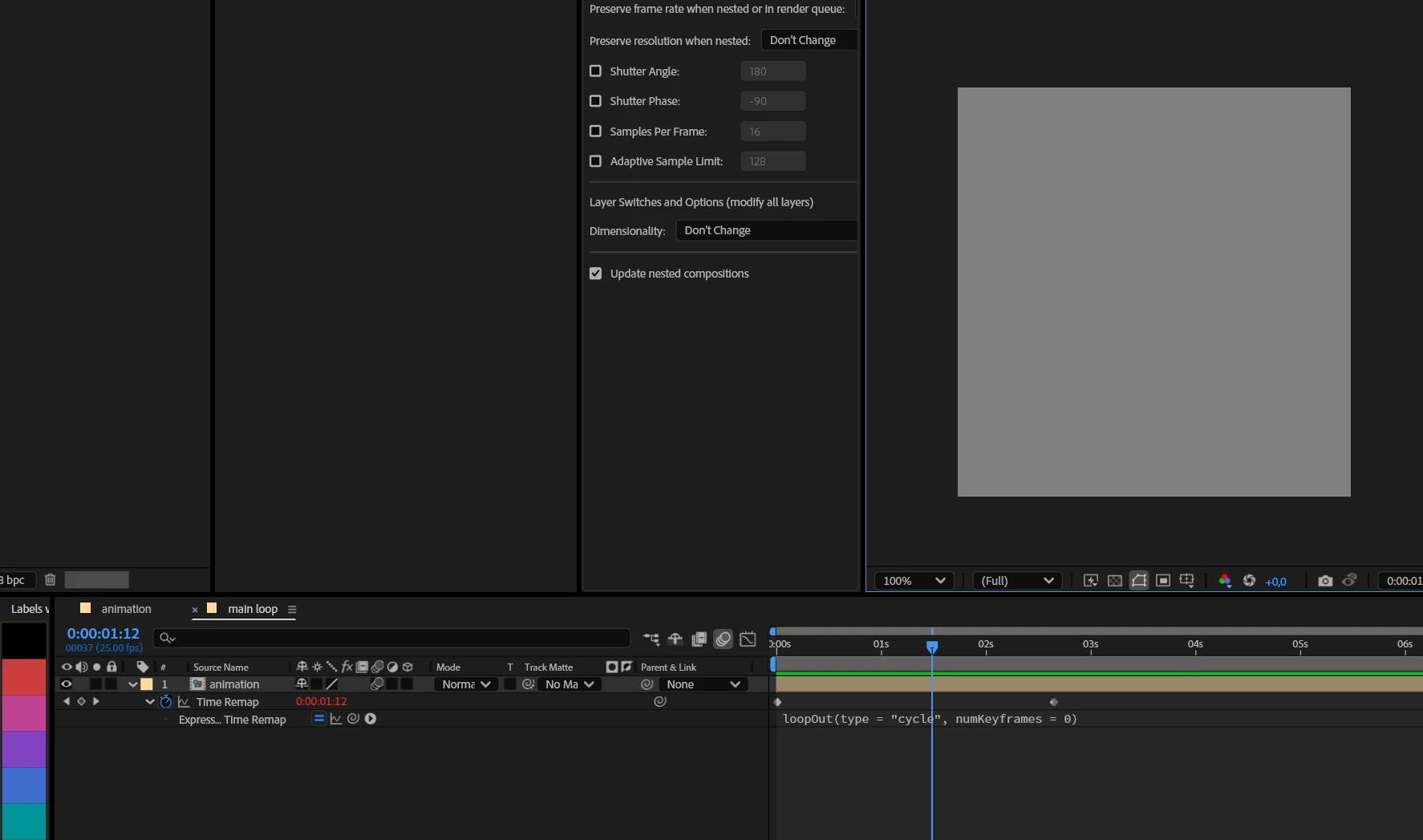

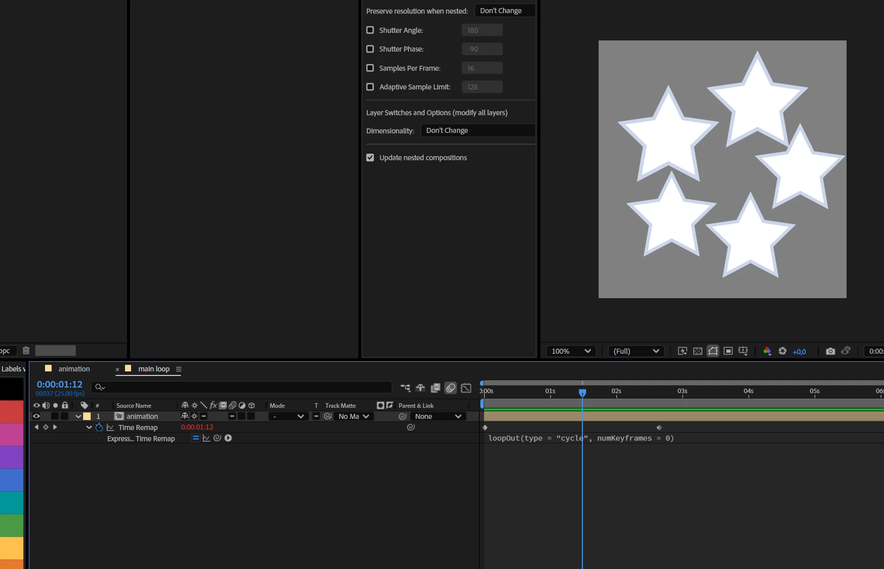

there appears another funny glitch (screenshots 3 and 4).. In the middle of composition just dissapeared all stars for few frames.. Just blink for two or three.. So I cleared cache and now.. Voila.. The old problem which I reported is here again..
Look at screenshots.. you can try it too.. If you will think it works, just clear cache and will see that it is not.
