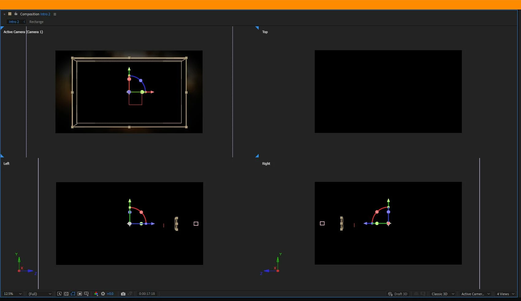

I'm a little unclear on what's still missing. In your screenshot of the 4 Views, it does seem like the Top view is missing content, but it's a little difficult to discern with this scene as whether anything should be rendered.
One thing: the Show Layer Controls option can be changed per-viewer, and it looks like maybe that's off for the Top view. If you click into that view and then choose View > Show Layer Controls, do you at least get the 3D gizmo and other layer controls?

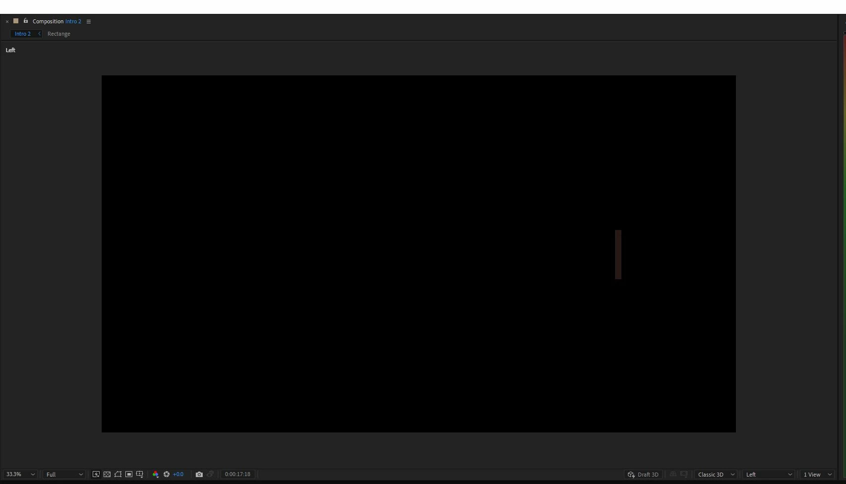

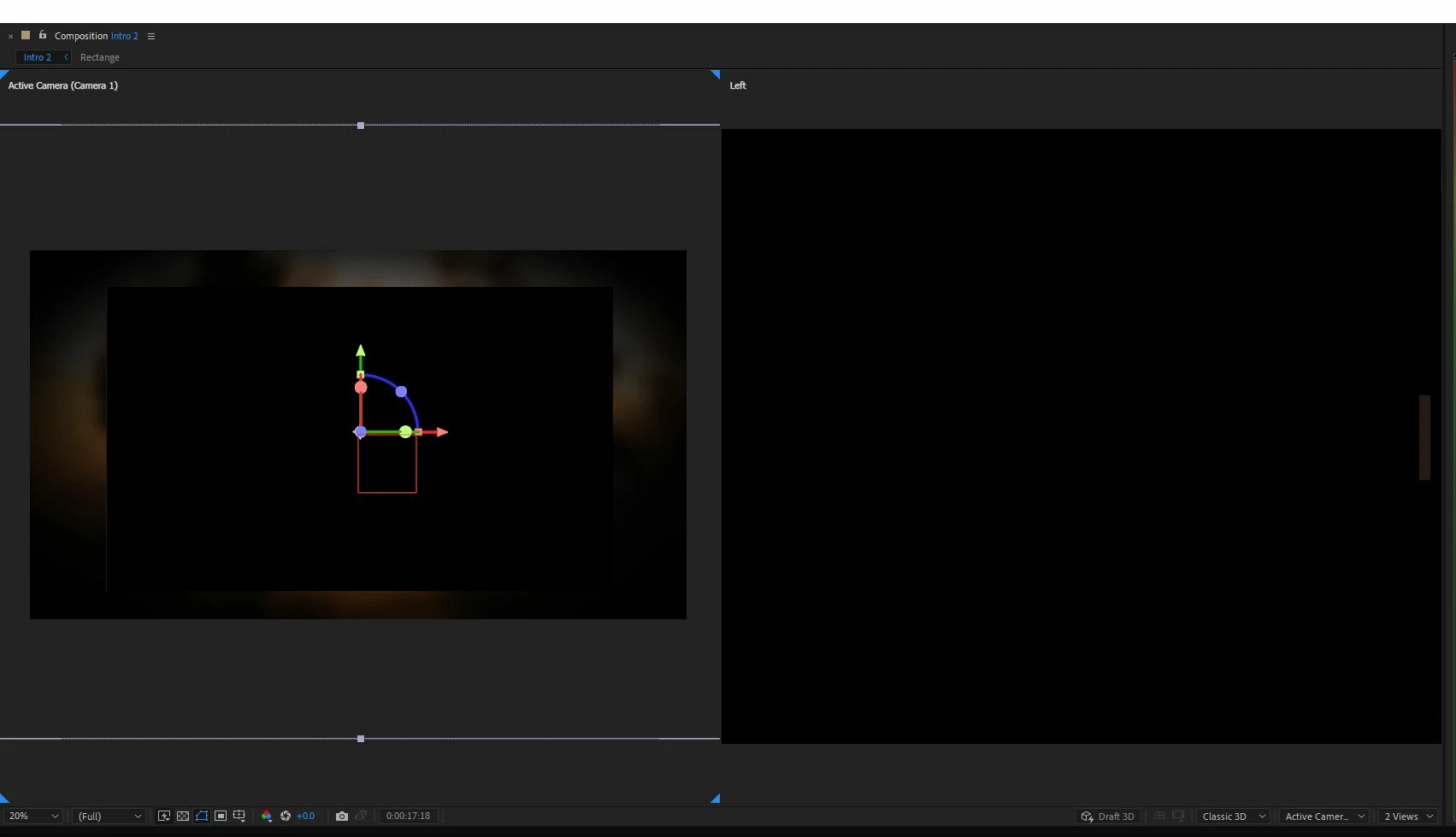

Last screen shot attached is selecting "4 views", where 3 of the 4 views show elements-- but top/bottom views still will not.  I also noticed that when I put the top view on the left side of a 2 view mode-- it "will" show elements.  However right side of a 2 view mode does not ever show scene elements-- very odd.  And left/right/top/bottom will not show any scene elements when in a single view mode.

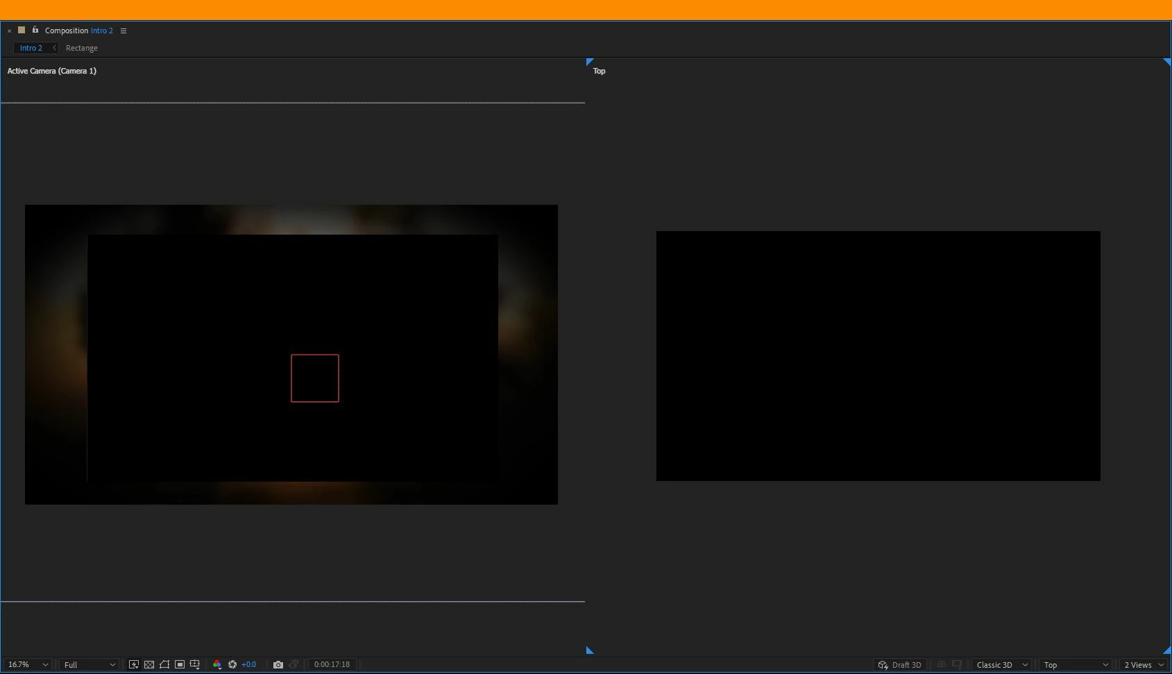

corrected upload for "active and top"
mjv-videoAuthor
Apr 20, 2023 10:28 PM UTC
Sure-- see the basic examples attached.  In "active and top", it shows the empty view on the right side (top view).  It is the same as with bottom.  In "left only", it shows that left (right does the same) does not display elements like camera on the screen when it is the only view selected-- as opposed to having two or four.  Thoughts?view mode.
