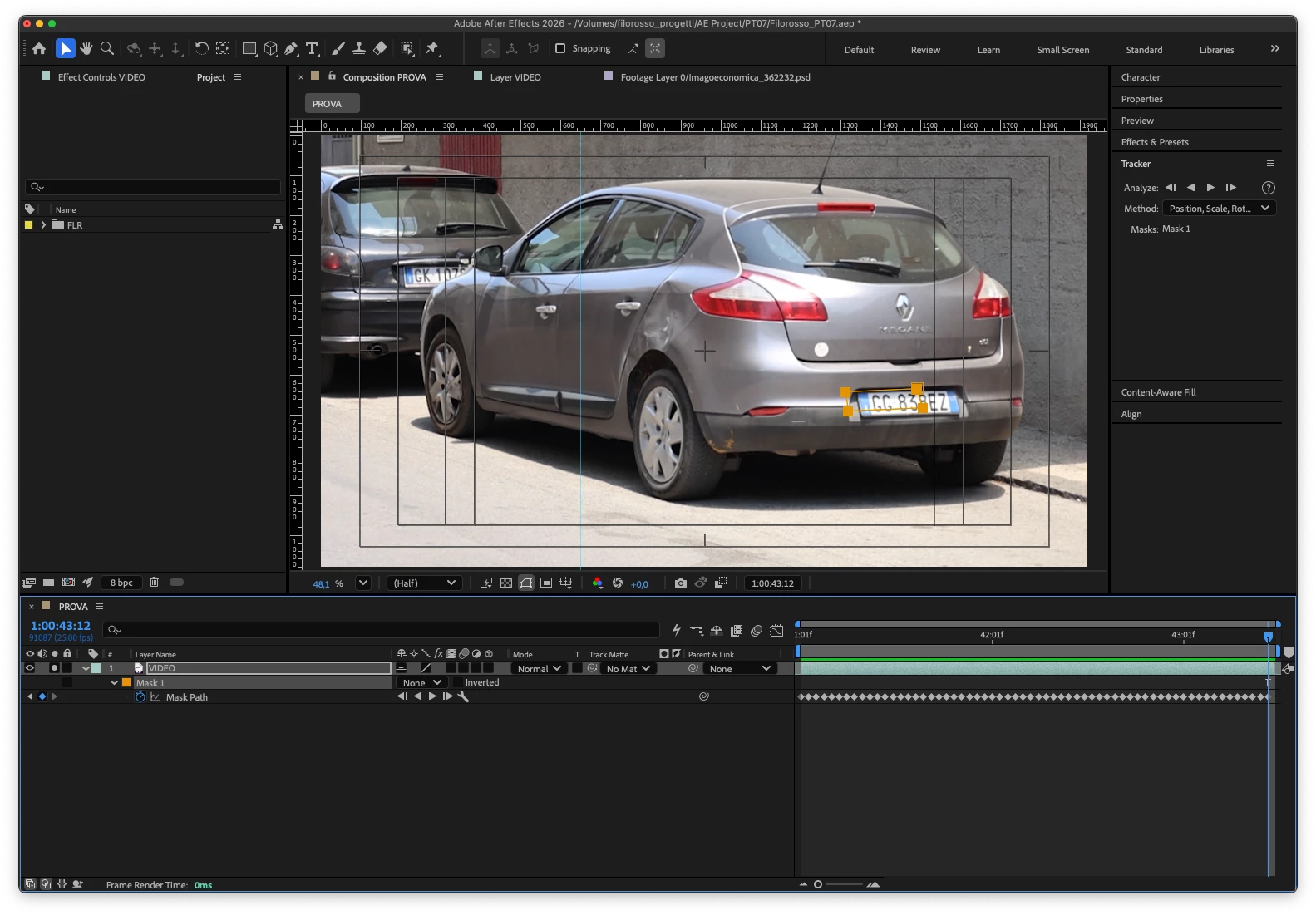

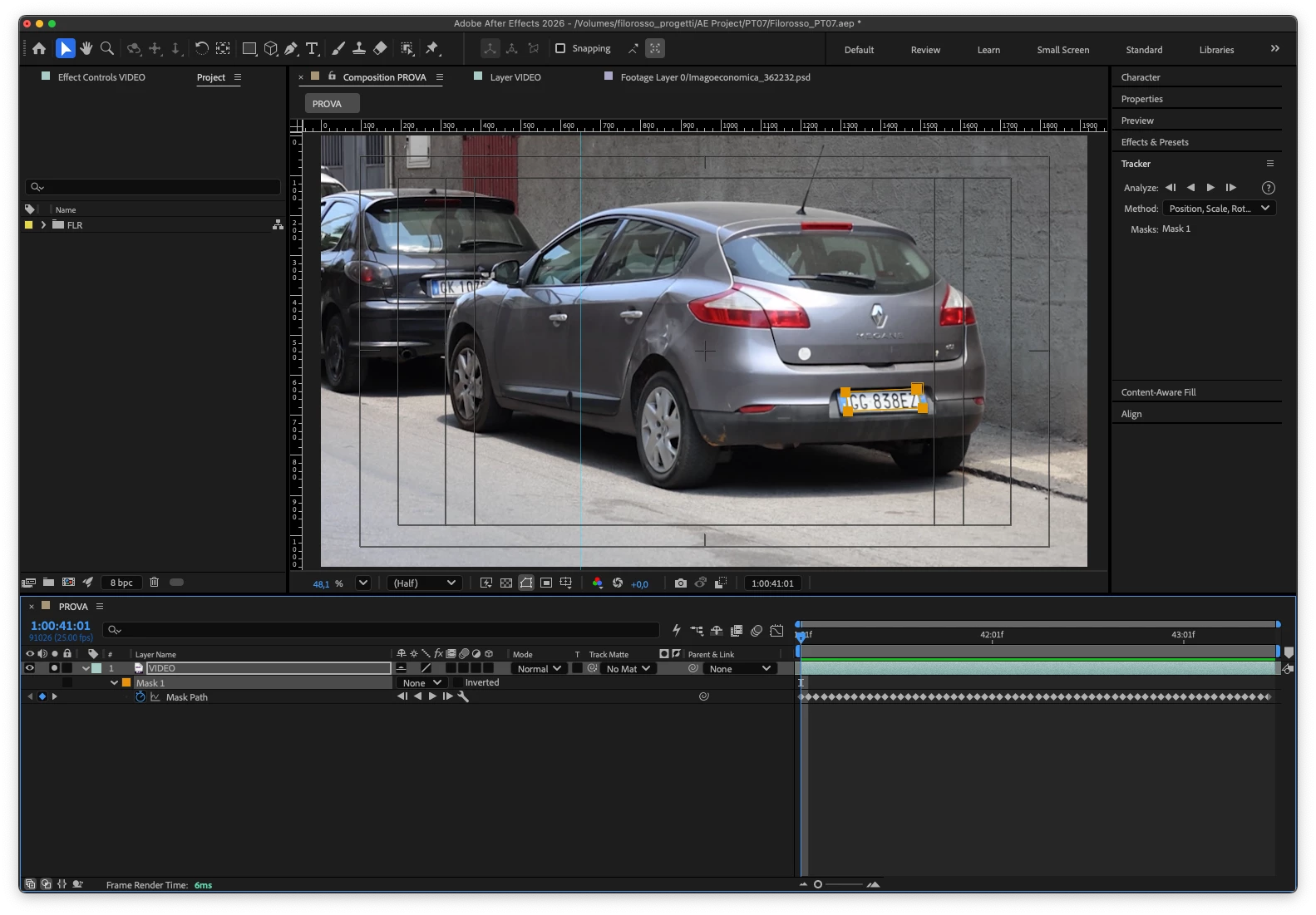

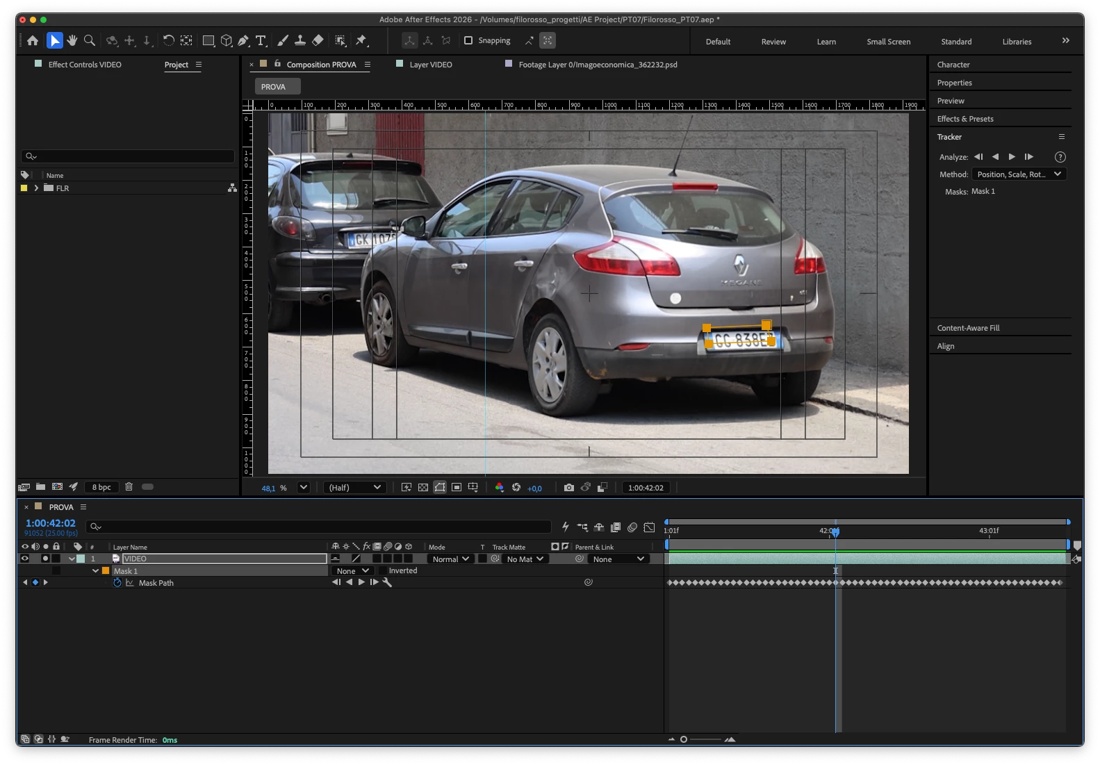

    I am writing to report an issue I encountered in After Effects version 26.3.
    Issue Description: When using the Mask Tracker, the mask fails to follow the tracked movement properly once the tracking process is run.
    My Steps:
    1. Create a mask on a layer.
    2. Open the Tracker panel and analyze/track the mask forward or backward.
    3. The mask path does not follow the tracked object correctly during playback.

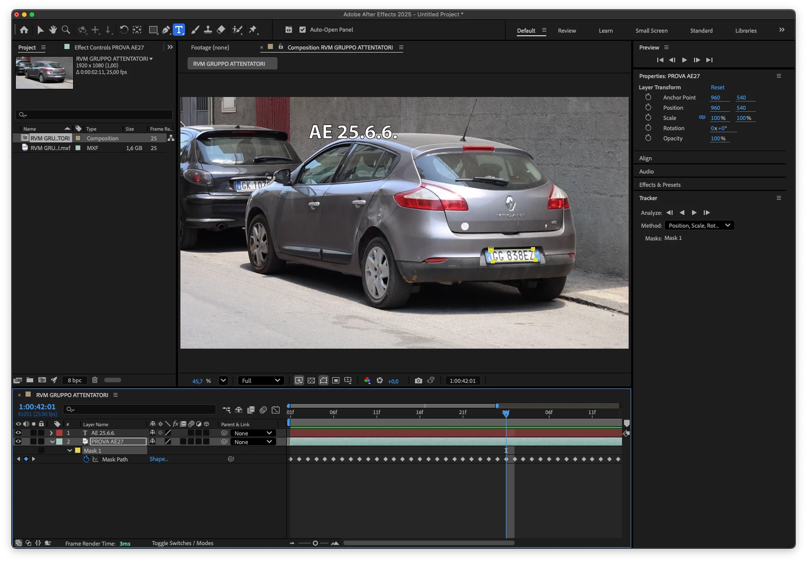

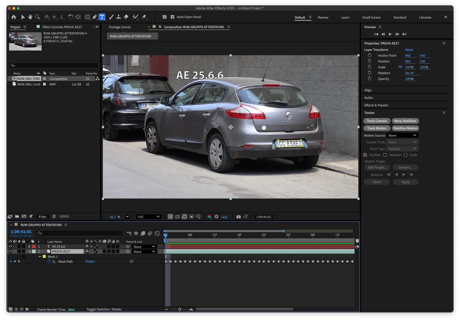

    I would like to point out that this feature was working perfectly fine in version 25.6.6, so it appears to be a regression introduced in the newer release.
    HERE 26.3
    HERE 25.6.6

    Hi, tracking works only at full resolution. However, in version 25.6.6, it worked at other resolutions as well.
