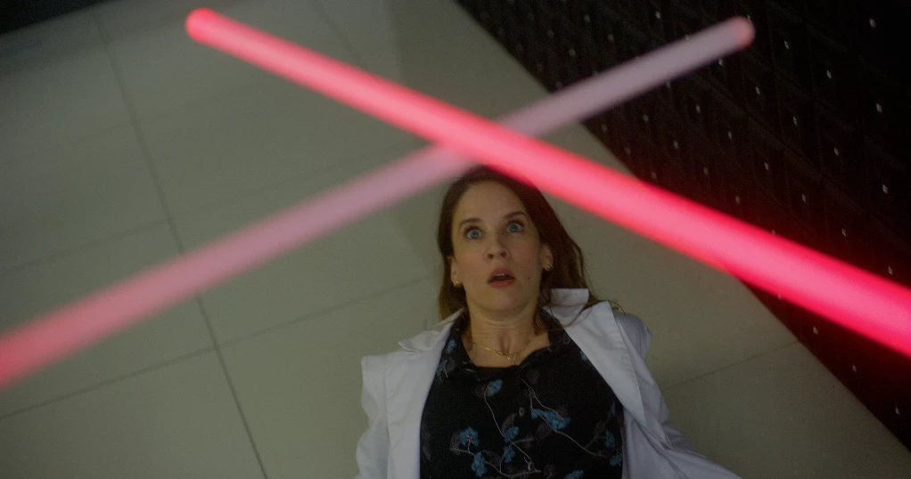

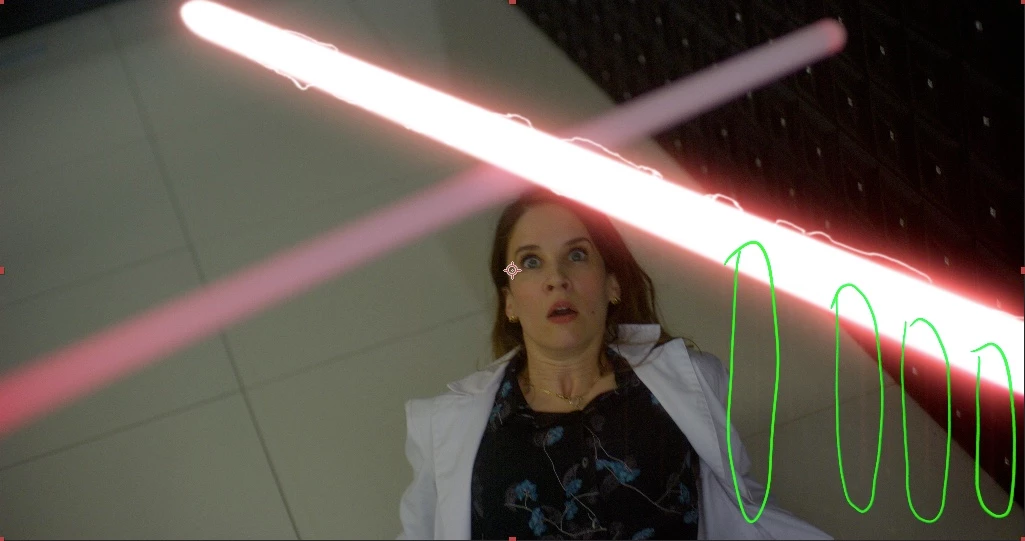

My issue is this: In some scenes, I am seeings vertical banding lines being rendered when the saber plugin is turned on. I have not been able to replicate the issue continuously. It only shows up occationally. I have attached a screen shots for reference:
Original
Saber banding
I've changed every option I can think of in Saber, but nothing works to remove it. My only option is to restart the AE file from the beginning which is not a resonable option at all. The first time I noticed this happeneing was in Nov 2022. I thought it had something to do with the footage being too bright and that was somehow causing Saber to blow out the screen causing the banding, but this current scene I am working on is conciderably darker.
Has anyone else encoutered this issue?
Mar 5, 2023 1:35 AM UTC
Check to make sure that the project is sent to 16 or 32 bit color depth. If you are getting banding when you render to an MP4 try adding a little grain or noise to the entire comp.
If the banding is just in the display, then it might be your system.
Without a screenshot showing the modified properties of the Saber layer it's impossible for me to recreate the same look and check it on my system.
