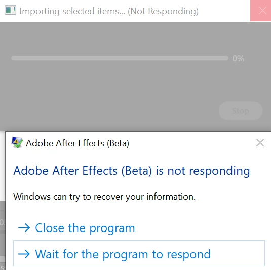

Ae Beta 24.5.0 (Build 38) importing files crash
Importing PSD files freezes Ae and consequentially requires forced closing the software.

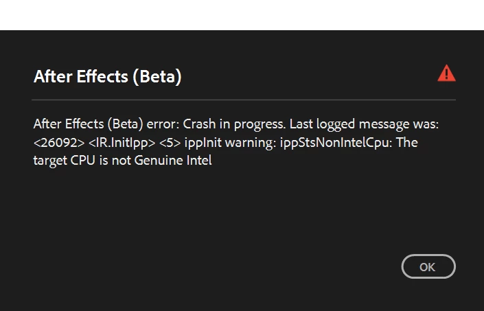

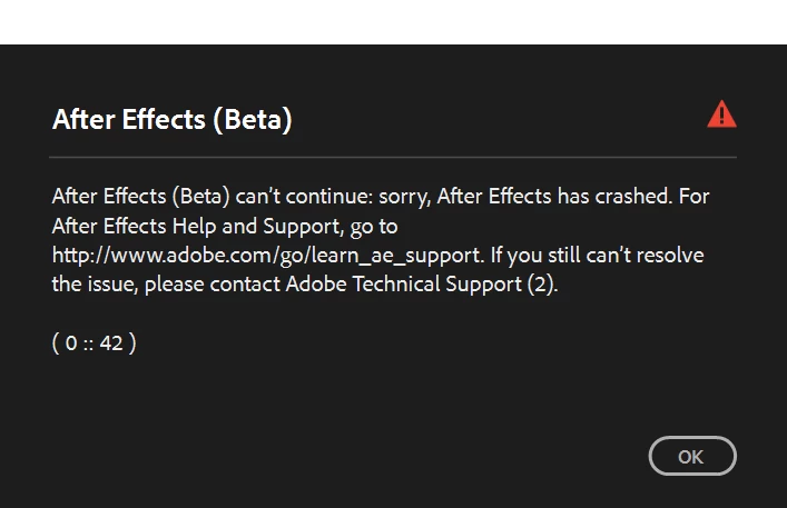

May 16, 2024 8:23 PM UTC
When trying to circumvent this bug and import PSD file in 2024, save it and then open the aep file in beta here's what happens upon beta launch.
