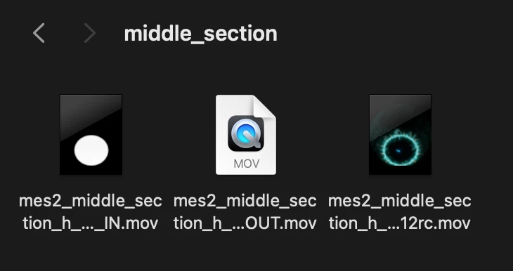

How to check: if you have a project that contains ProRes files, and you're finding AE hangs only when starting a queued render, check whether Finder on that particular machine is able to display a thumbnail for those source files. If not, you may need to recompress them before using them in AE.
These ProRes files show thumbnails correctly on an Intel mac:
... but when viewed on an Apple Silicon mac (same version of macOS etc), one of the files doesn't display a thumbnail correctly:
... and while all three files will work correctly in other apps on the Mac (FCP etc), if you try using that middle file in AE you may encounter problems.

I've attached that particular problem file above to this post if someone wants to experiment. It'll work fine in FCP, and on AE on Intel macs, but you'll likely have issues trying to use it in AE on ARM.

    Hi @howiemnet,
    Thanks very much for posting about this and for including the problematic file. It does appear to be some issue with hardware; if the hardware decoding in Preferences > Import is disabled, the file renders just fine on an M1 Mac, but it hangs if that preference is enabled. I'll forward that file to our team that works with formats and see what we can do about preventing that hang.
    Thanks again, the info and file are much appreciated,
