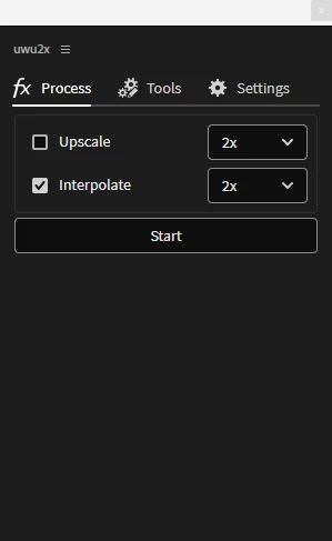

hello, i might've found a bug that makes multiple 3rd party scripts unusable. I've found the issue with a script that lets me interpolate short clips and automatically replace them in my timeline. The script has 3 tabs of which the most important one - the settings tab - is just blank on the new beta UI. Ive got 3 pictures to make things more clear.
This 1st picture shows the normal panel of the script (Ae beta 2024-03-26)
A very basic script (the 2nd tab works too).
This is how the script looks after clicking on the settings panel (Ae beta 2024-03-26):
As you can see, its just fully blank. No respond on any clicking or anything, just empty.
And this is how its supposed to look like (Ae stable 24.2.1)
This settings tab has got even more stuff as you scroll down the panel.

I've tried it out what the article said about retriggering the Firewall. I accepted the request from Windows but it still wouldn't fix the problem. Its still empty. Does it work on your Computer? I really can't think of another cause anymore. The last thing i would want to do is resetting my Windows... I appreciate the work your putting into this problem and the help.

I've tried out manually giving Adobe CEP access to both private and public network over my firewall because i didn't get any "Permission Request" to begin with. I tried out opening the settings panel, still blank. I reached out to the creator of the script too and he said:  "it is empty because the extension can't build the settings tab, it happens when the extension can't get the render templates, models names... I never managed to reproduce this error. When, for me, the settings tab is empty, every other tabs are empty (not only the settings tab)". I tried resetting the preferences and reinstalling the whole beta software but it still doesnt show anything. Its a weird problem and i have no clue where the core to it lies.
