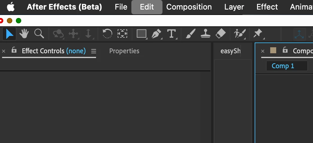

In AE 22.4 Beta updates since March 17th on my Mac M1 Macbook Pro Max, I can't pull down menus any more.  When I click a second time, the dropdown flashes on/open for half of a second and sometimes I can quickly click on something with the mouse button held down but they are not working correctly.
I was lucky after a few attempts to even be able to click on the Beta Feedback button's pulldown menu
