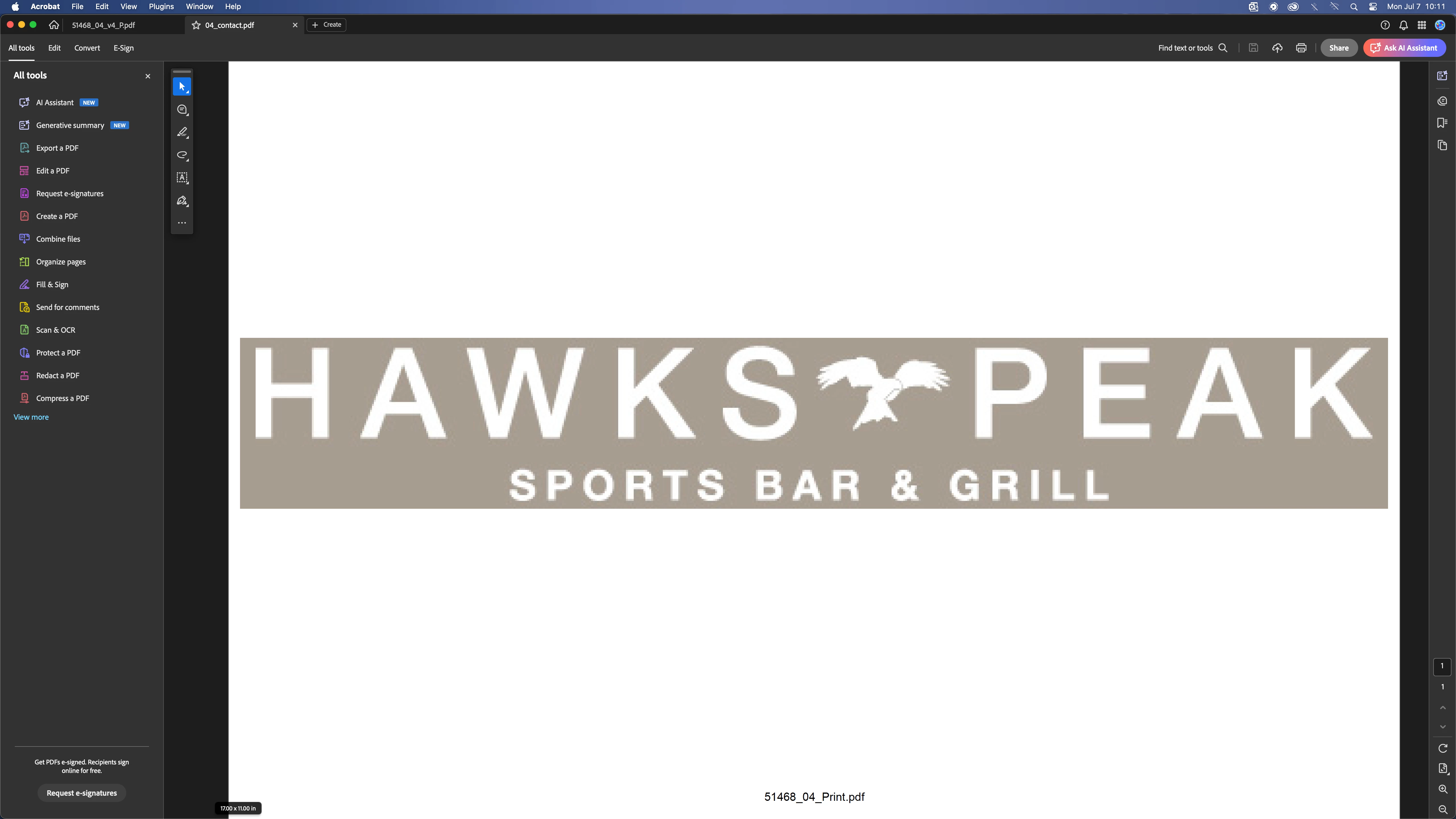

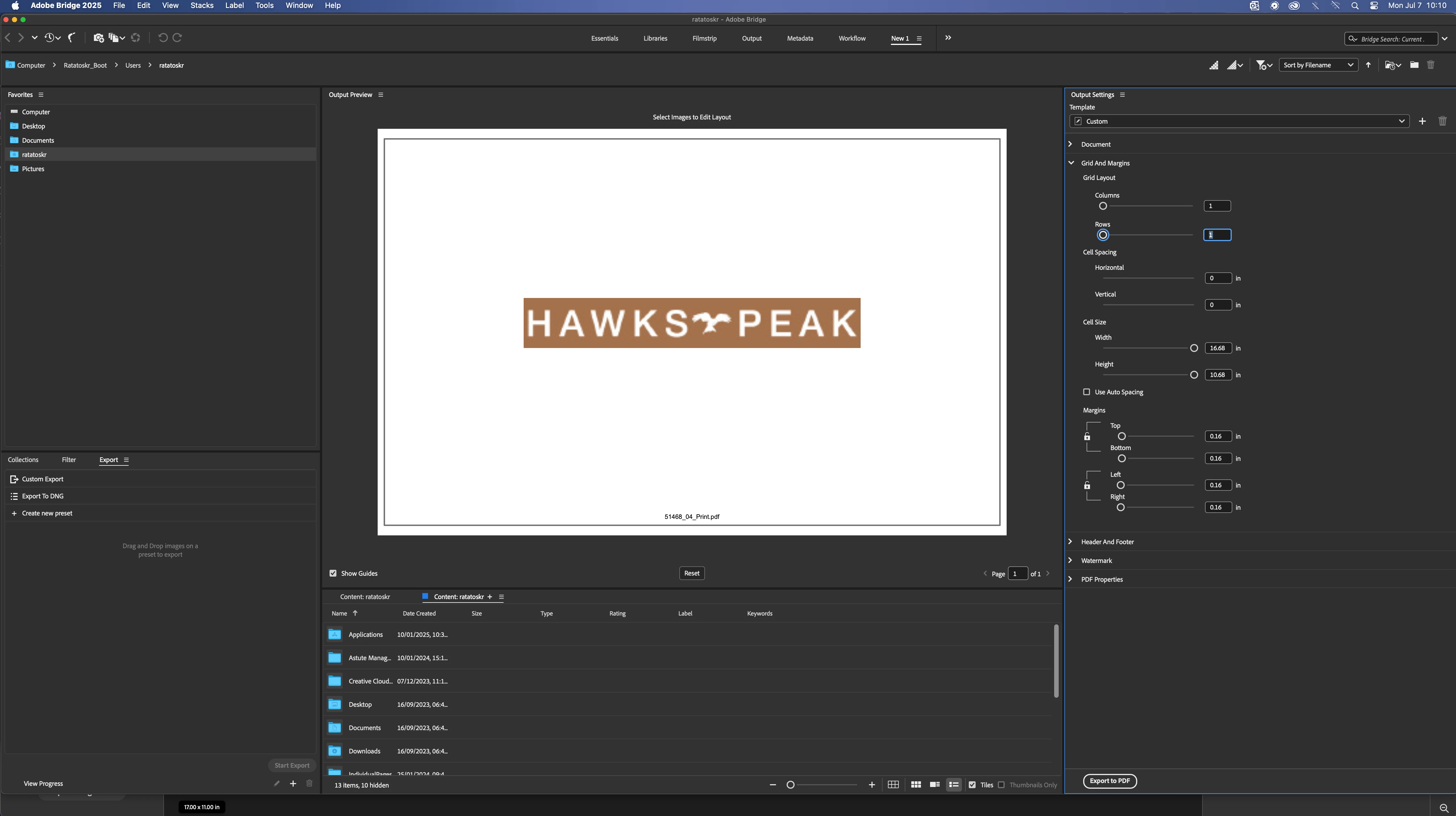

I have an ongoing issue with Bridge. Almost every time I use it to make a contact sheet, it'll display an image incorrectly. not something like greyscale vs colour etc. but an entirely wrong art file.
I'll drop in two files, one with print art and one with finishing/cut files etc. The preview will show two print files, but usually output the contact sheet as expected. Sometimes though, it'll output the preview and I get two copies of the print file.
The only thing I've found that fixes it in the short term is to quit and reopen, but that's just a temporary fix as the problem comes back after about 10 minutes.
So, what's going on and how do I fix it?

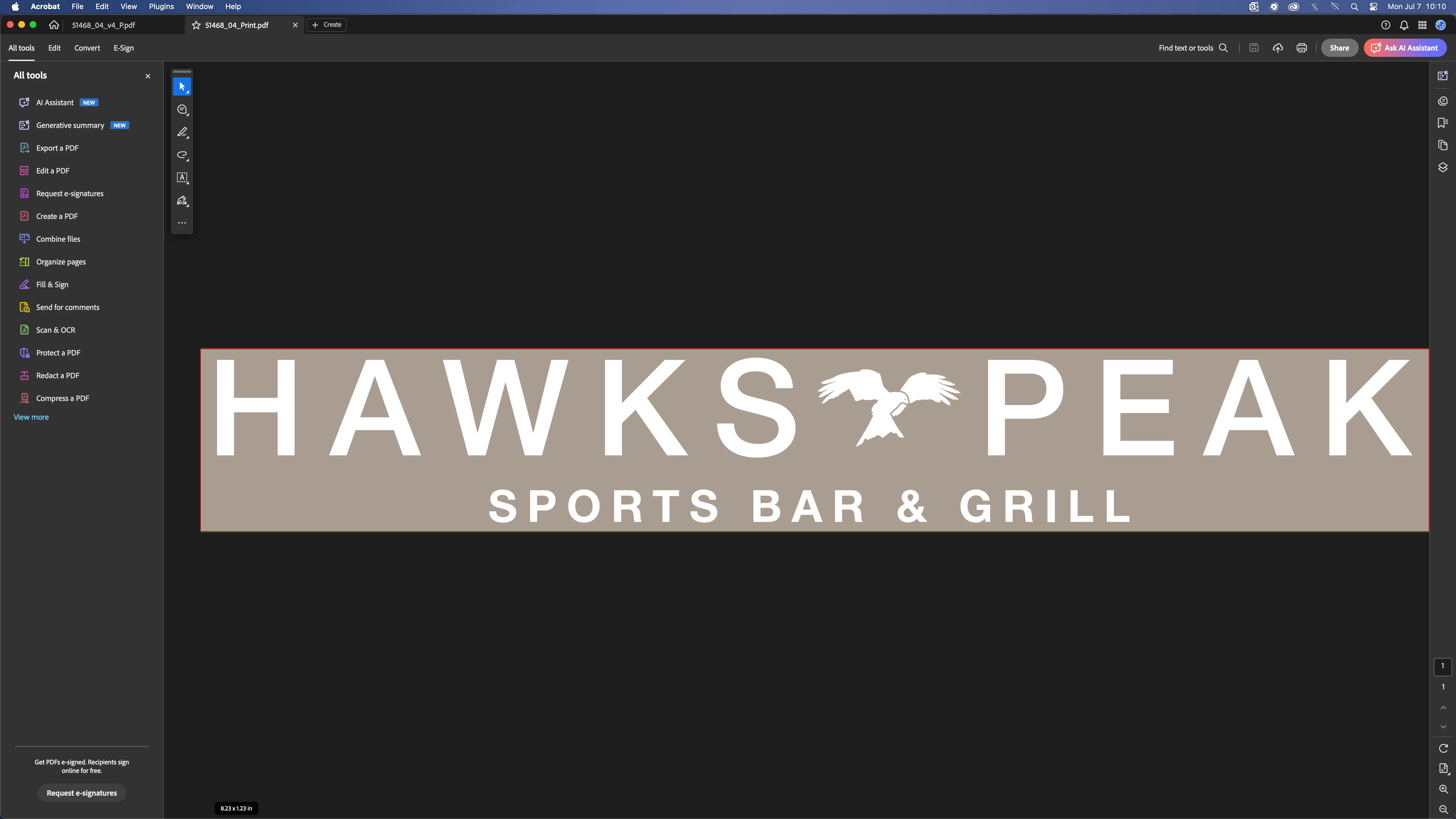

Attached are the Original Ai file and the PDF saved from it for print. That PDF was used to create the contact sheet with the attached settings. Bridge seems to be referencing an older version of the PDF (labelled as _Old here, originally it would have said _Print.)

The original file is created in Ai and saved out as a PDF.
 The pdf is then placed into Bridge to create a reference contact sheet.
In this instance, the file Bridge displays is approximately 7 days old, with my computer being switched off for 3 of those days. Bridge was used to create similar contact sheets with different files, all PDFs, without issue, but in this case, it references a file that no longer exists. And, whilst the output file is correct, I cannot be certain ahead of exporting to PDF from Bridge because the display file is wrong. Quitting and restarting Bridge is a partial solution and works temporarily before whatever causes this issue starts happening again.
