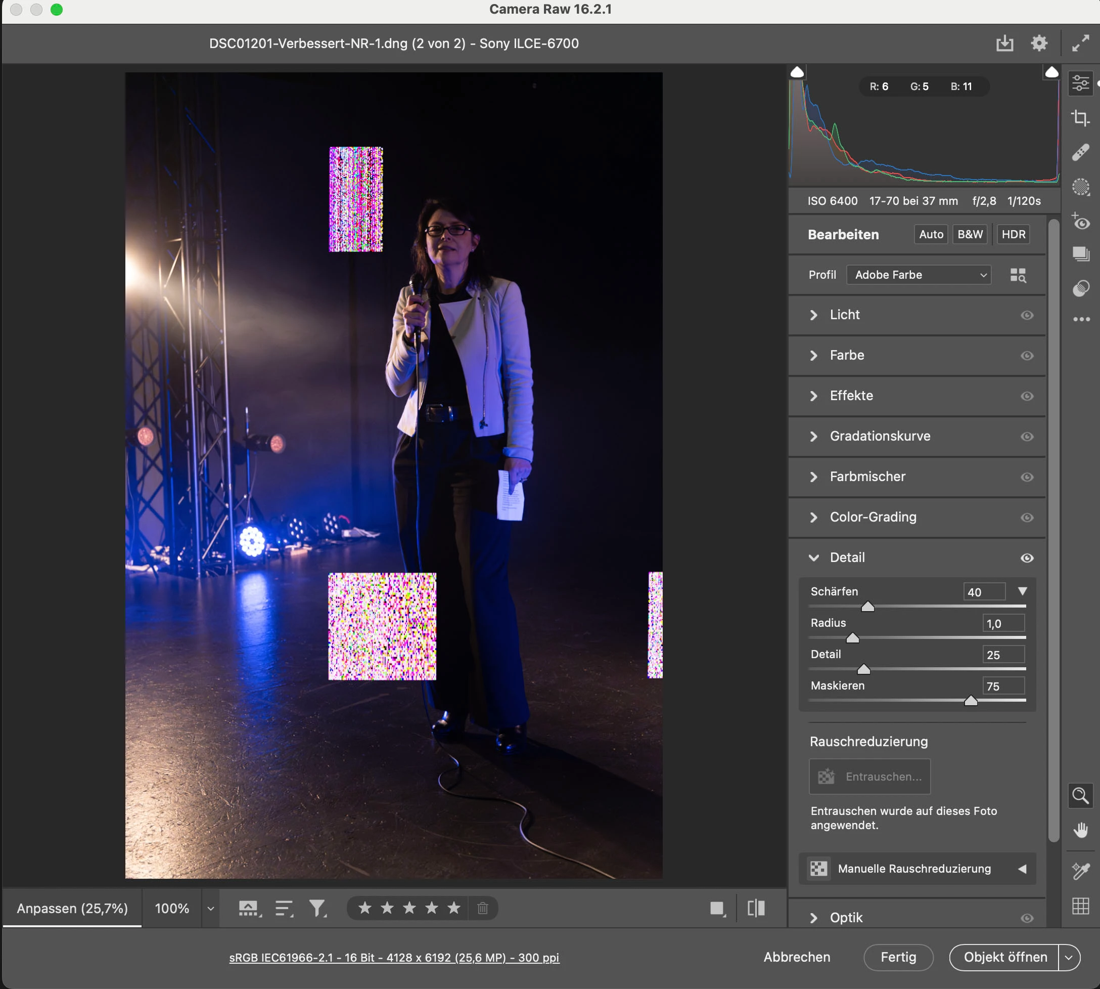

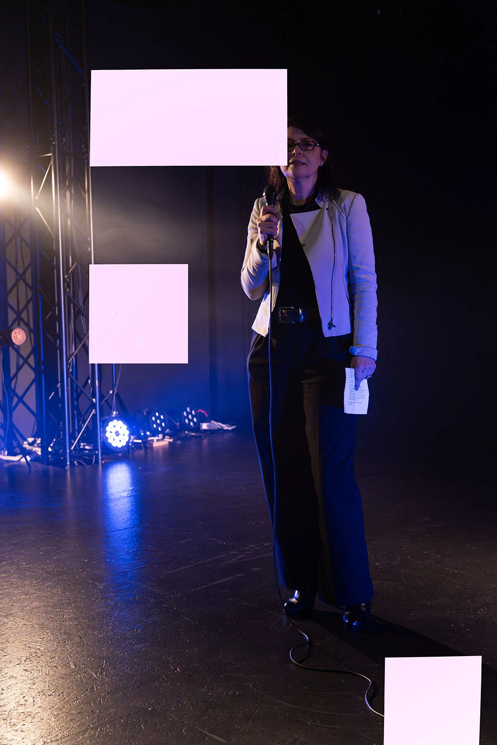

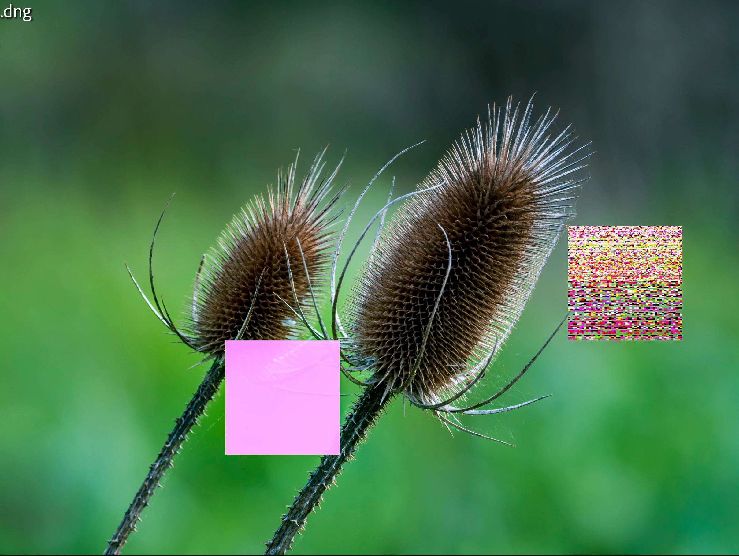

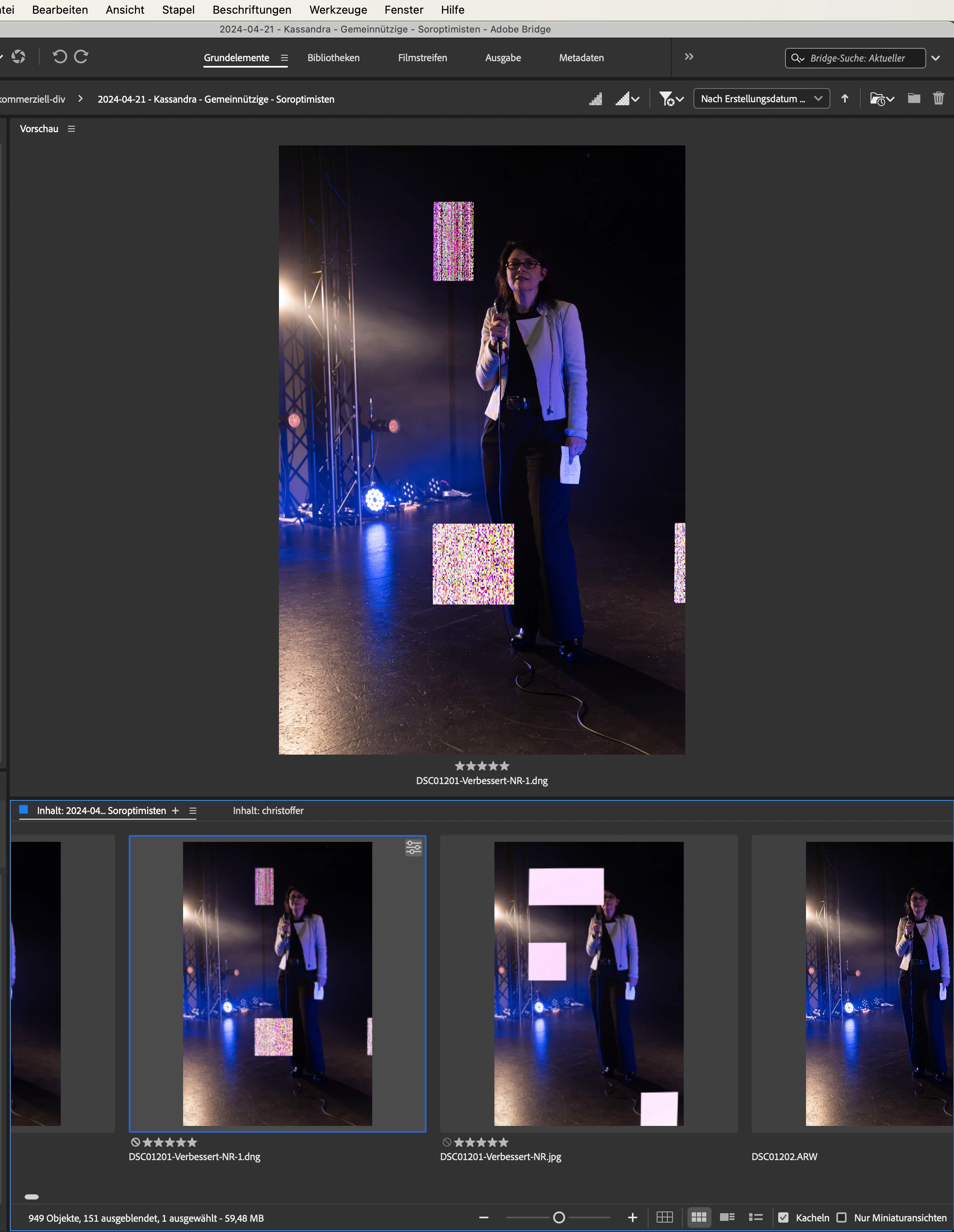

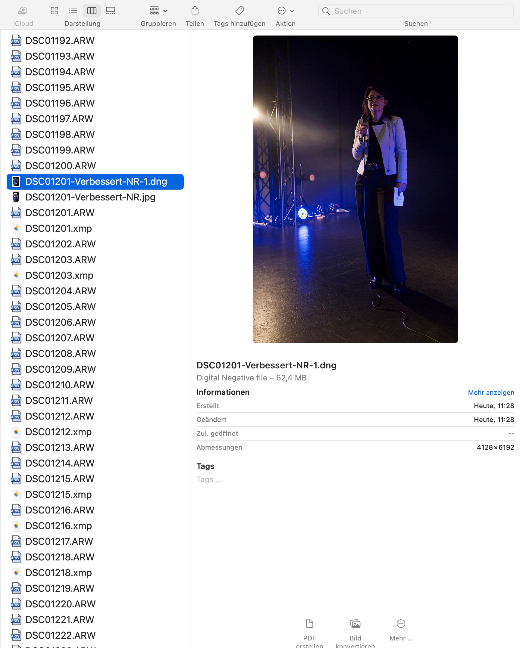

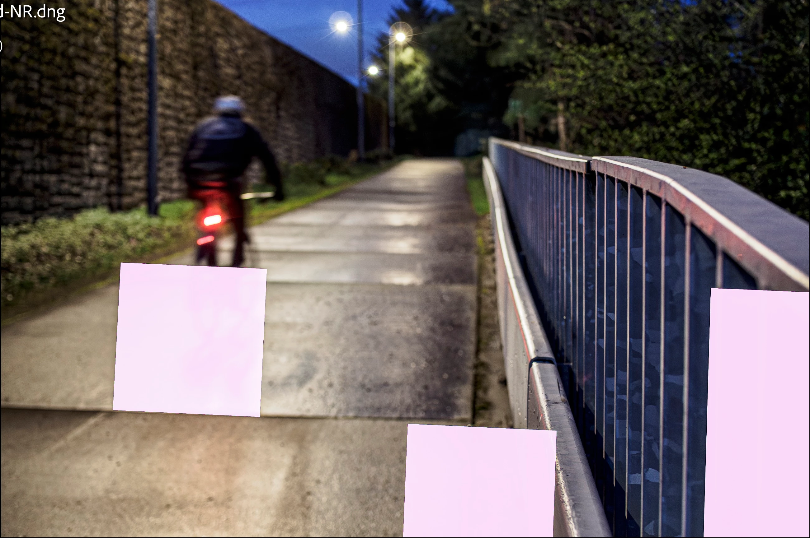

P: Denoise - large artifacts with AMD Graphics Card
When I use Denoise on RAW images, the images are putting strange squares on the DNG once it is created.  this was after the latest update on both mac and adobe lightroom.  I've spent HOURS on adobe customer service, don't know how to fix this.  I love that feature.

Yes, i restarted several times, no change... I just tested it with a MacBook Air 2022 M2 8GB: Bridge, Photoshop and Camera Raw have the same version, but macOS is still Ventura not Sonoma. It works great. I will edit my photos with the MacBook and after that i may update to Sonoma to check if it still works or if the bug is somehow related to Sonoma. But... maybe i have to keep the MacBook in this working configuration...!?
Memory is not the problem, my Intel-Mac has 64GB RAM and memory usage isn't going even up while AI Denoise is "thinking" und with the 8GB MacBook its working fine...

I#m using an AMD Graphics card, compatability check is OK, turning it off doesn't change anything.
Heres the system report:

When I open a Sony a6700 RAW fIle and use AI Denoise, the generated DNG Image has big white rectangles on it, sometimes with RGB-Patterns in it, sometimes lightly transparent or with a purple hue. When i view the image with macOS Preview, everything is fine, no rectangles, but when i open it with Bridge or Photoshop, there are those rectangles...
I expect a denoised image, not one with those rectangles.
History: Some days ago everything was fine. macOS auto updated to 14.4.1. Then this bug occured. Then i updated Bridge, Photoshop (and Camera raw), but the bug still is there.

I did, at first it seemed to work, but the problem now persists with GPU off as well
Apr 21, 2024 5:51 PM UTC
I have the same problem with an Intel iMac and an AMD Radon Pro 5500XT by GPU. At first it seemed that disabling the GPU (as suggested in this forum) solved the issue, but rather quickly it started to occur with the GPU off as well.
Apr 21, 2024 5:29 PM UTC
Started as bug report, but was reclassed by admin. GPU off (or custom) solves this new issue for now. For one or two images the speed penalty is not noticeable, but for large batch jobs it might be a different story.
Prior to last week that problem never occurred, so something changed (I update OS an LR frequently). But after 4+ years of largely trouble-free use, Apple apparently thinks it's time to buy a new box🙎
Apr 21, 2024 3:59 AM UTC
Denoise In LR used to work fine , but all of a sudden it produces strange rectangles in the DNG file.
Curious about fixing this issue which has occurred only recently.
LR 13.2. CR 16.2
iMac 3.6 GHz 10-core Intel
OS Sonoma 14.4.1
