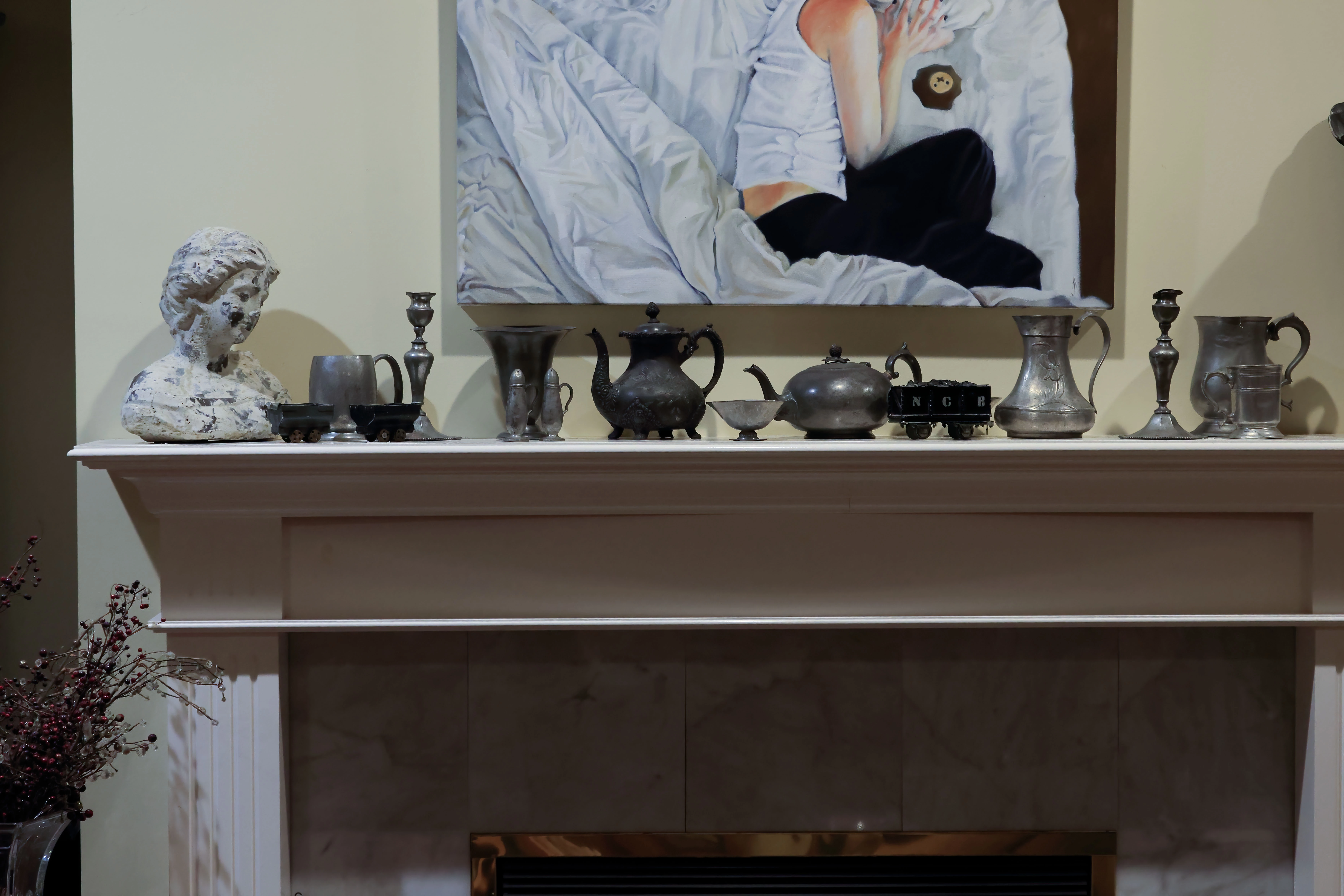

P: Vertical bands in low light areas with Canon R7, using Camera RAW not with Canon DPP
Using Canon R7, CR3 RAW files: I have discovered vertical bands when I shot in low light using higher ISO (ISO 1600 and up), when I process using the latest Camera RAW Using Windows 11. When I process using Canons latest DPP software the bands are not there.  This is with standard settings, no exposure change or other changes except standard sharpening.

What this bug report is about that the lens profile of certain (but not all) lenses + sharpening introduces banding in lower exposed areas when used with the new Canon R7. when using Canon DPP for Post processing for reference it does not happen as far as I can tell.

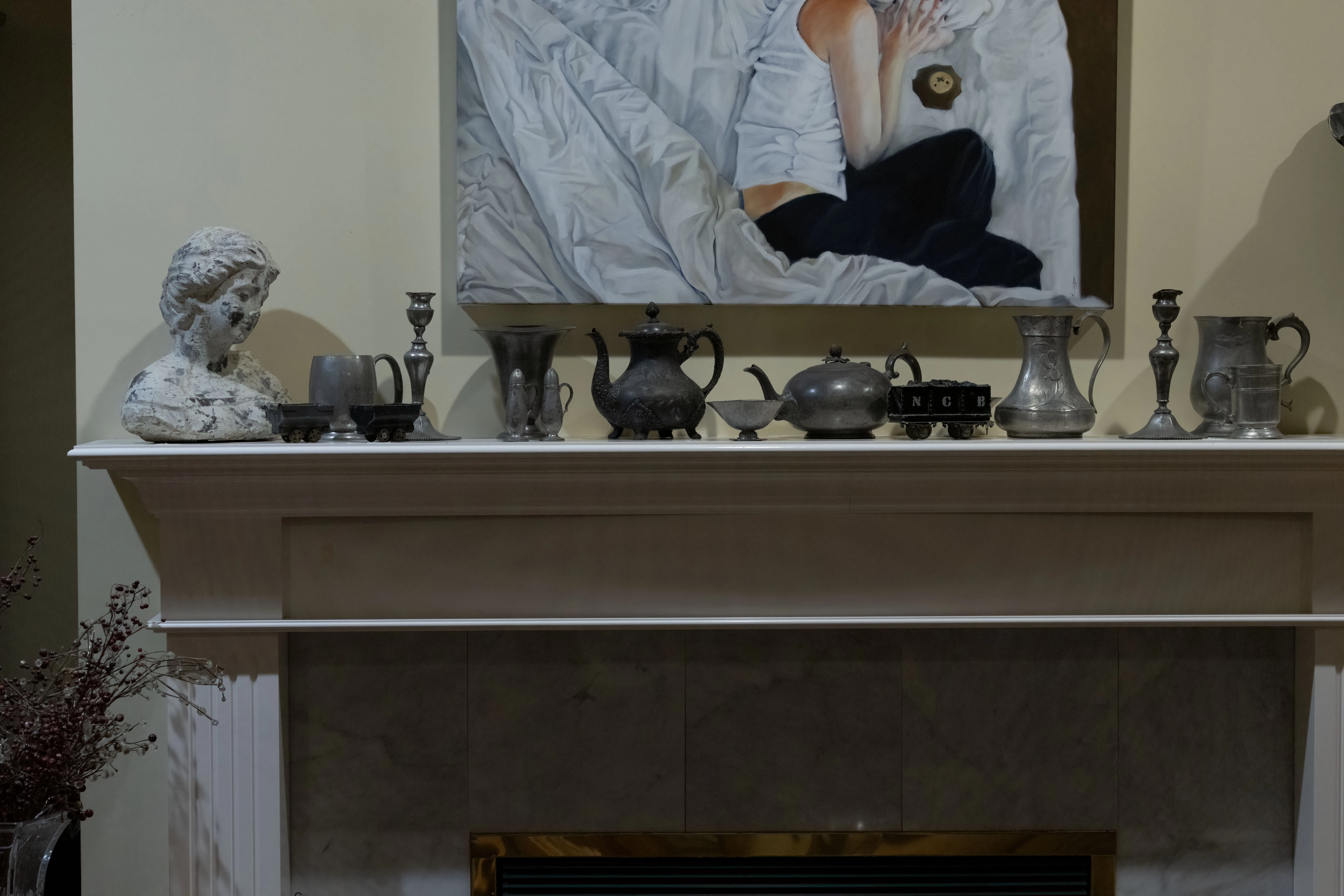

I downloaded the 880.cr3 file,  and what looks a bit like banding in the top right corner is caused by a combination of underexposure, oversharpening, too little masking, and lack of Luminance noise reduction.
I'm guessing that the lens profile accentuates the effect of your edits, because the corners have been stretched.
Underexposure will inevitably introduce noise in the shadows, particularly with high ISO images.

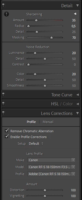

You have set Amount to 70 for sharpening, which is way too high, and Masking is set to only 6, which is not nearly enough.
In addidtion, you have to use Luminance noise reduction.
Always work at 100% view when applying sharpening and noise reduction. Any other view will be inaccurate and misleading because the image has been scaled. (if you have a 4k or higher resolution monitor, you may need to work at 200% view, because the pixels are so small)
Below is a screenshot of your edits and mine, and my settings. I also set Exposure to 1.00 for both versions.

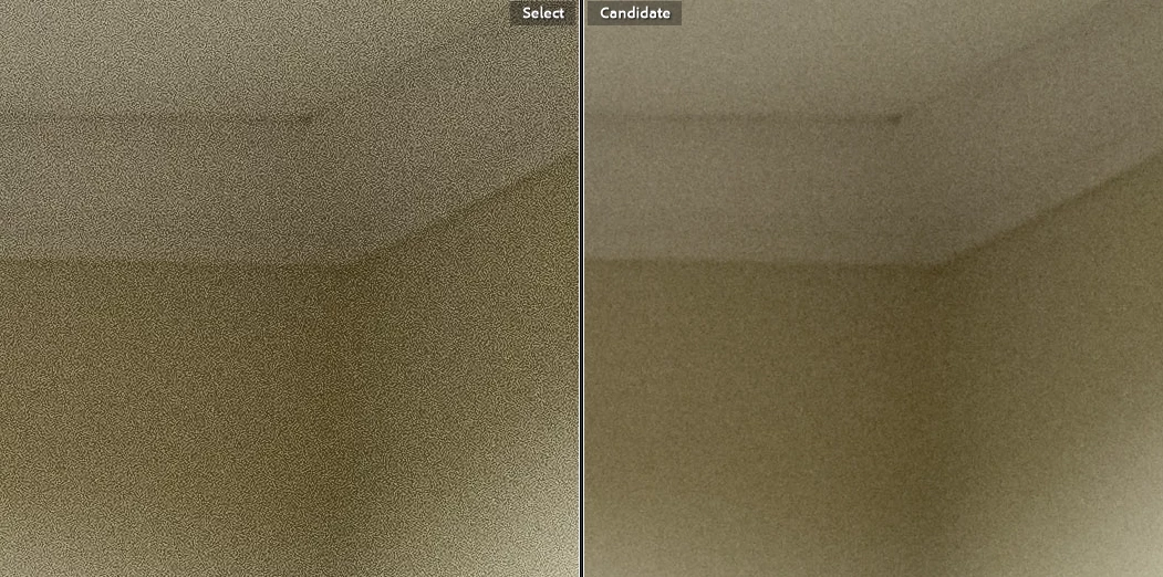

This is actually a moiré pattern, you can see the concentric circles. This has been known to happen with certains lens profiles.
But first rule out a screen resampling artifact! Make sure you view at 100%.

Wether its moire or not I have no idea. However it does not exists in the Canon generated built in JPGs om the Raw, nor in the Canon DPP generated JPG from the RAW. Therefore it must be an issue in ACR's rendering. I have tried on three different computers with different screens. My conclusion is that this is some sort of bug in ACR's handling of these files. I tried to report this is a as a bug, if this is not the right place - where do I report it?
