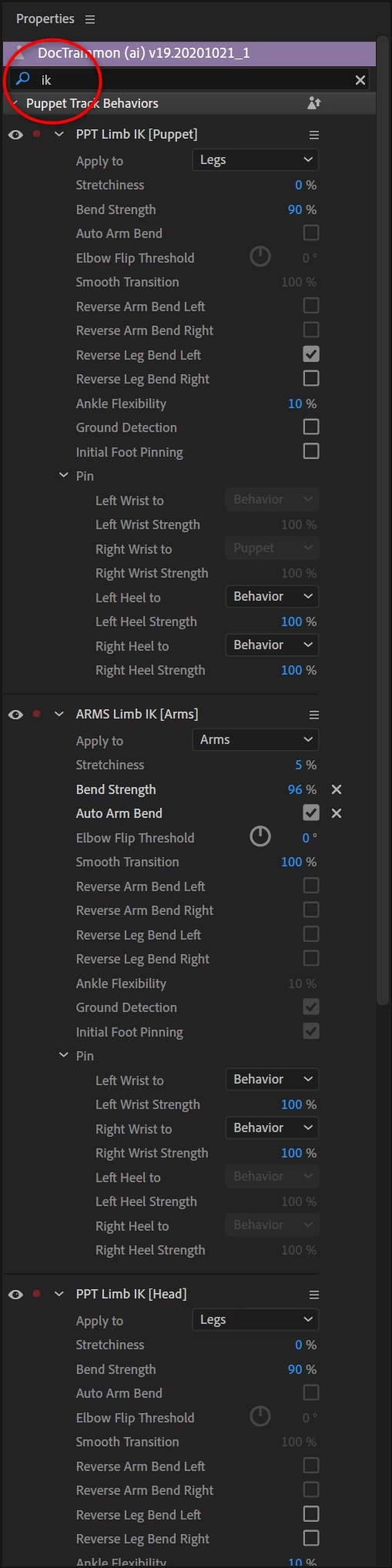

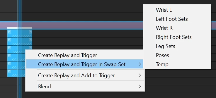

Defect while Filtering Properties and Create Replay and Trigger in Swap Set
Properties was filtered with "ik", I created a 2-frame snapshot, then selected the tracks I wanted to create a replay and trigger set for and right click, "Create replay and trigger in swap set"-> picked the set to add it to, and received the attached error.
I tested with and without filter and consistently (in this file so far) I get the error when filtering properties and don't get the error when it's not filtered.
