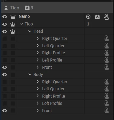

Hello again, I have made the adjustment and moved the swap-sets into the Head and Body groups. But unfortunately, the exact problem persists.
Truth be told, I was just recently getting back into using Character Animator after more than a year and actually have made similar puppets prior without any trouble. Pardon me if this turns out to be due to my outdated Character Animator knowledge as I might be oblivious to any significant changes on the software since the last time I used it a year ago.

TheOriginalGC
May 31, 2023
The first thing I noticed was that the head and body are not part of the root under the character name. You have them inside your front and profile views. The head and body should come first and then front and the other views. This way, you can turn the head without turning the body and vice-versa.
