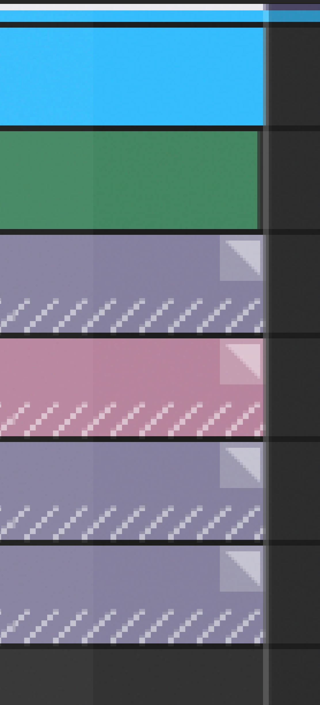

I was having a similar issue.  And when i zoomed in on the timeline with a MAGNIFYING GLASS I saw that my layer that was not sustaining was like 1% shorter than the ultimate edge of the replay timeline (see the green bar in this image).  My solution was deleting the green bar and re-recording it, ensuring it snapped properly to the EXACT end.
Hope this might help anyone else suffering from the same thing!  Feels like a bug… layers should NOT snap to 99.99999% of a frame.
timeline (see image).
