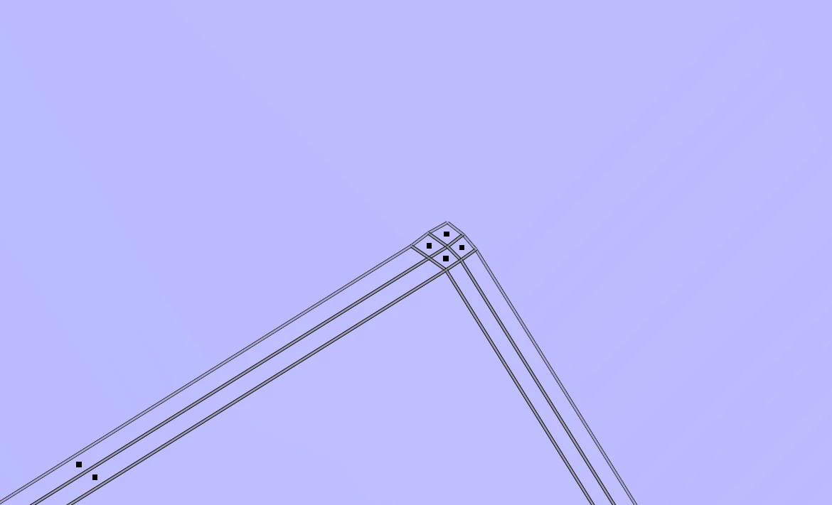

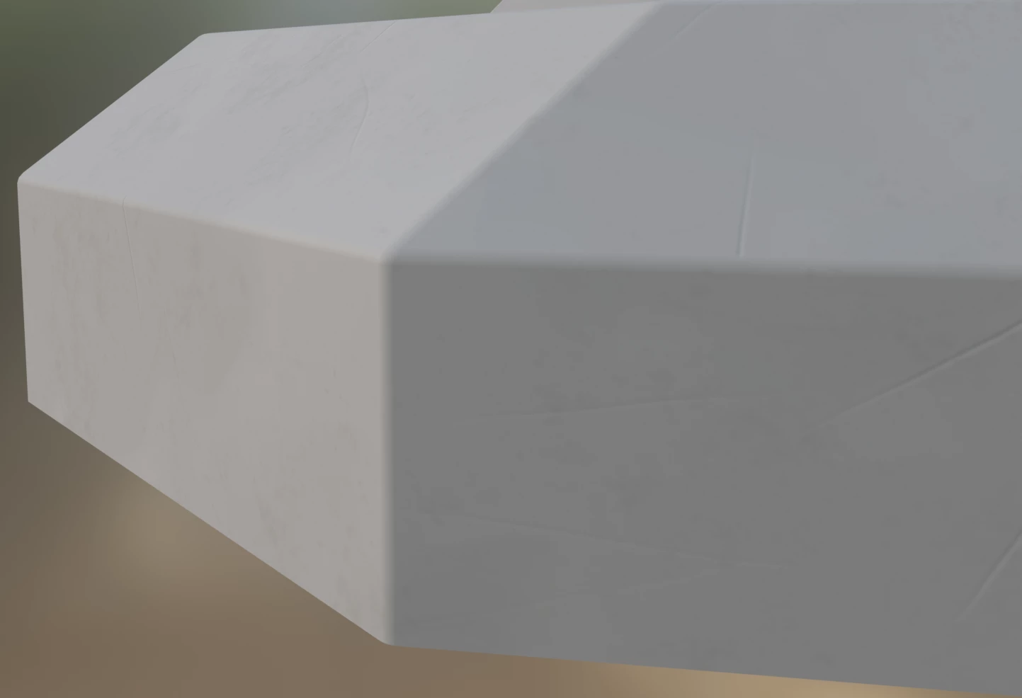

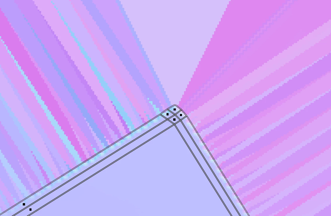

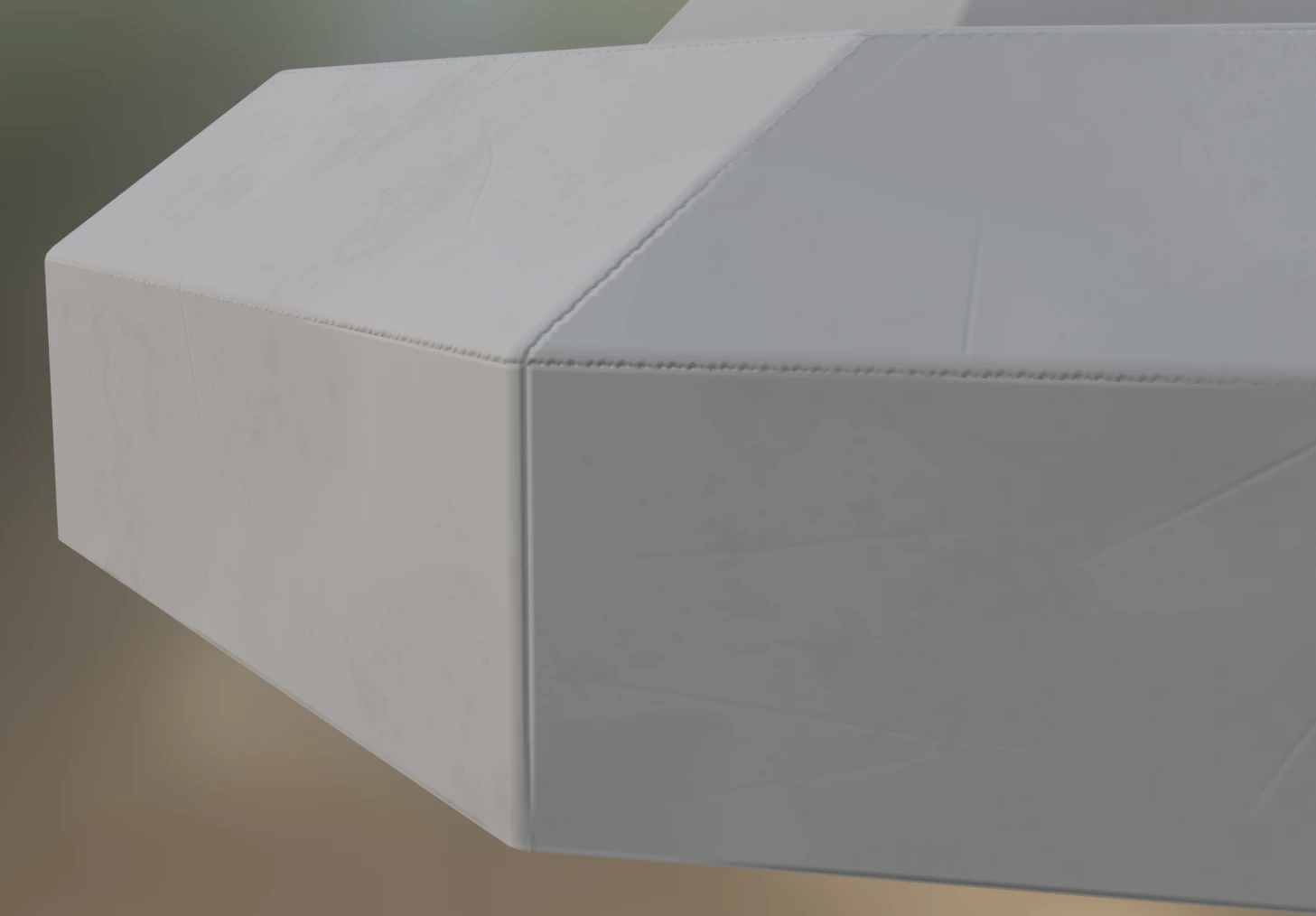

8K export corrupts live generator-driven height; rasterized generator output exports cleanly.
8K export re-evaluates live generator-driven height incorrectly, contaminating exported normal maps. 4K export is clean, painted height is clean, and rasterizing the generator at 4K before exporting 8K produces clean normal maps. See attached PDF for more details.
Images:
Rendered normal map from live generator exported at 8K
Rendered normal map from generator rasterized at 4K and exported at 8K
Normal map from live generator exported at 8K (with UV island overlay)
Normal map from generator rasterized at 4K and exported at 8K (with UV island overlay)

    Here’s a DxDiag. Briefly, my system is Windows 10, AMD Ryzen 9 3900X, 1x NVIDIA GeForce RTX 2070 SUPER, 32 GB RAM, and an NVMe SSD (with at least 60 GB free when the bug occurred).
    From the SP About screen:
    Substance 3D Painter, version 12.0.3
    Build 5408 - b2eb59ee33f6ec3ff394db295f6cc1dadee14738
    Engine, version 9.4.3
    Build 0 - 840108d5 (Apr 27 2026)
    Bakers, version 3.22.2
    Build 0 - 96705c63
    Substance Abstract Layer, version 10.3.3
    Build 0 - Unknown
    Here’s a link to a stripped down version of the file that produces the normal map results I showed earlier when exporting at 8K:
    https://drive.google.com/file/d/1bKYZo8pnMHuVeAaiWO_yUWEOrJMQ-cKb/view?usp=sharing
