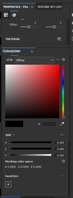

If the issue is that you don`t know what channel the colorpicker menu would be for then you could implement a dropdown for the channel inside of the colorpicker itself and make it dockable. By default most painting outside of masks will be done on the Albedo/Diffuse in my experience so having that set as the default sounds like it could work just like the viewport dropdowns work

heres a mockup of what i mean for that last suggestion
