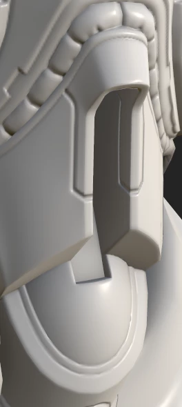

I am having an issue with hard edges when I have my normal map loaded into a layer. The exact same normal map (baked in SP) looks perfect when loaded in as a mesh map. But when loading it into the normal channel of a layer (with normal mixing changed to replace, and the blend mode set to normal), it displays with hard edges along UV seams.
I have triple checked everything is setup correctly regarding directX/openGL normal settings and the problem is still visible after exporting the normal map too.

First image is the normal map loaded in to the mesh map channel. Second image is the exact same normal map loaded into the normal channel of a fill layer (Normal mixing set to replace, normal blend mode set to normal)

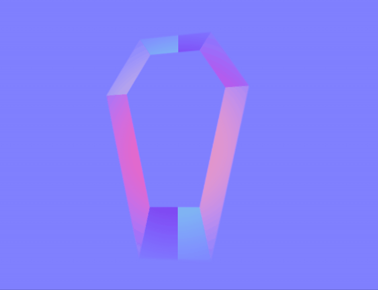

To be clear, a visible seam in your normal view isn't a problem as long as you don't see it in your material view. It is pretty common to have normal seams; this is due to the UV shells rotation. To make it simple, as the normals work in a tangent space, the purple (for example) will always comes from top to bottom (in DirectX format), regardless of the UV orientation. Therefore, if you paint something in between two UV shells, this may create a seam on the Normal map depending how the UVs are rotated.
In fact, these seams in the Normal map prevent seams on your Material.
