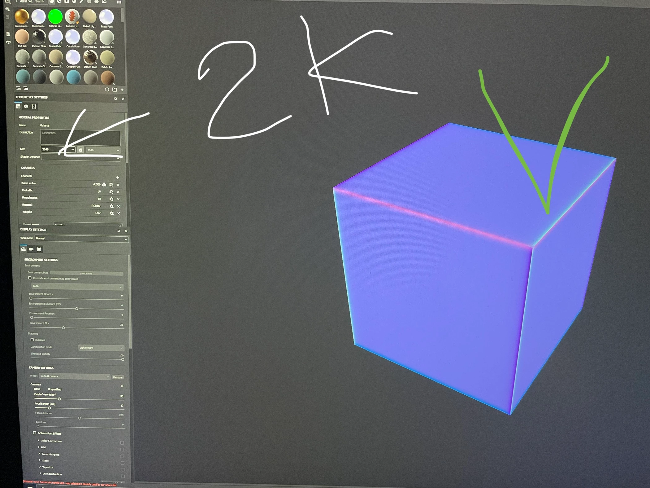

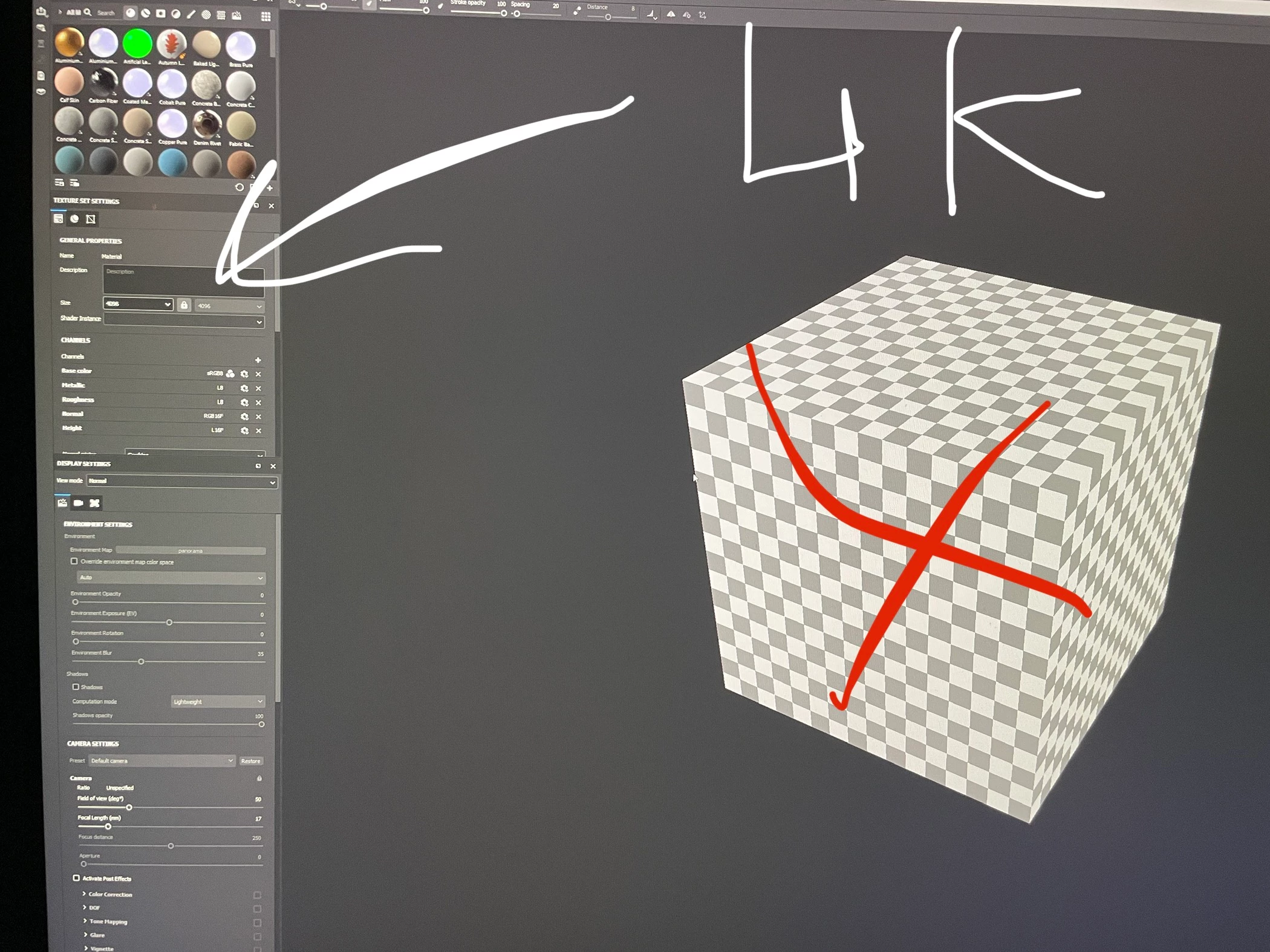

Good afternoon Faced a serious problem in S3DP. After baking with highpoly and saving the file, the normal map and several other maps are not displayed in the viewport at 4K resolution. After switching the viewport mode to 2K, everything is displayed normally. I'm used to working in 4K resolution and this problem gives me terrible inconvenience. Please help me find a solution and let me know in a reply message. Thank you very much in advance !

Hello again! Thanks for your input and support, I think I've solved the problem. I hope this will help you in the future as well. The issue was due to AMD GPU compatibility and was gone by rolling back drivers to version 22.6.1-win10-win11-june29. Everything worked as it should, thanks a lot again!

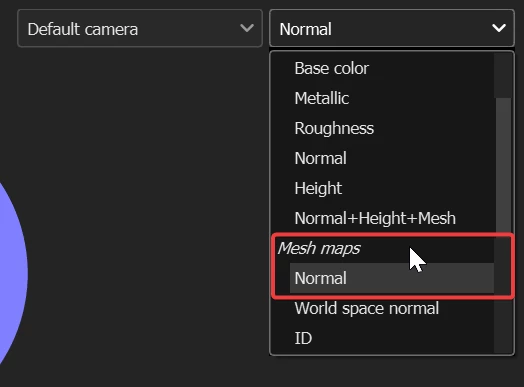

Does your baking also have issue ? When you switch your display mode to Normal (or any map from your baking), make sure it's under the Mesh maps section.
