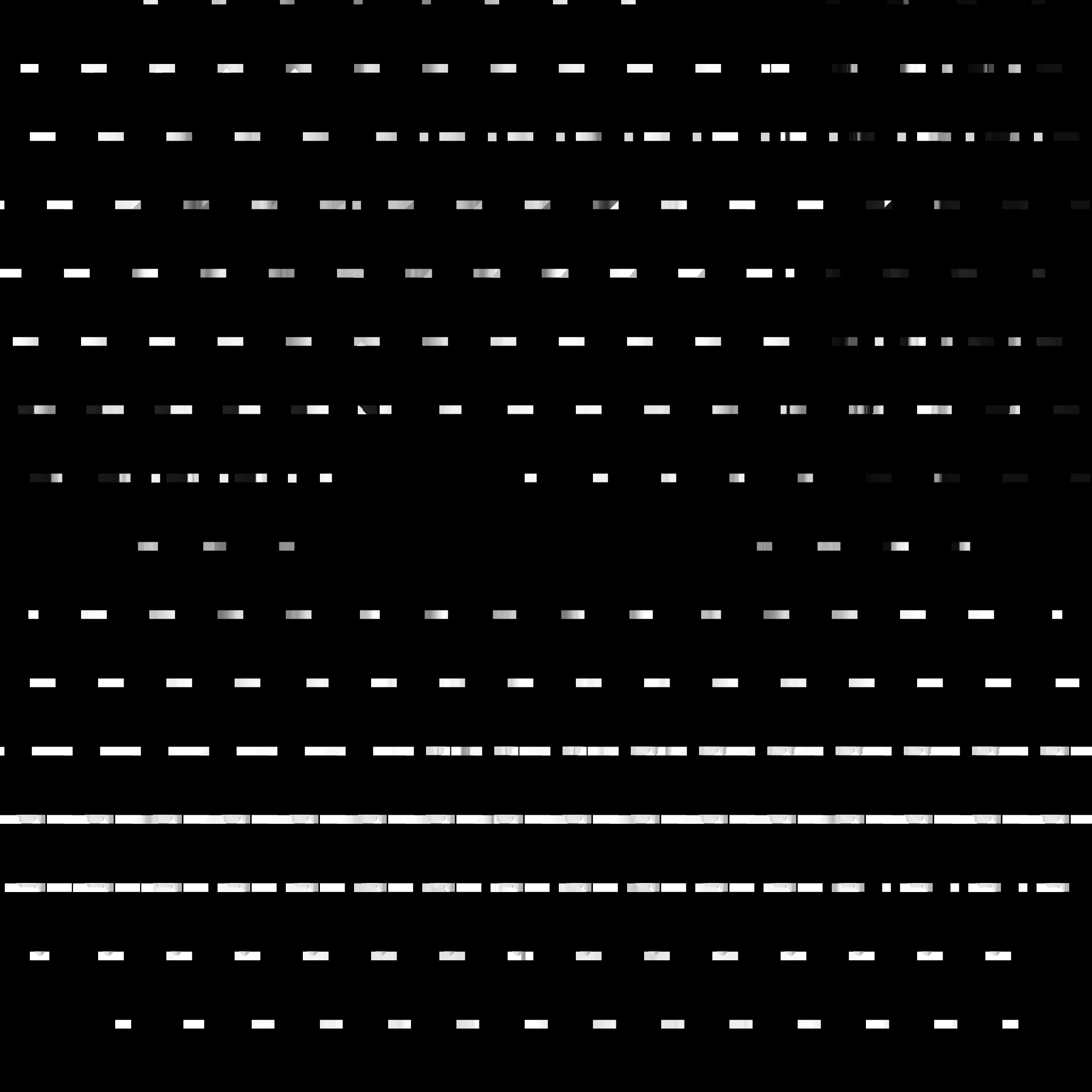

Issue with Ambient Occlusion
In Substance Painter, when I generate ambient occlusion maps, they don't work correctly. Instead of being created based on the model, they appear as white lines, completely ignoring the model's UVs.

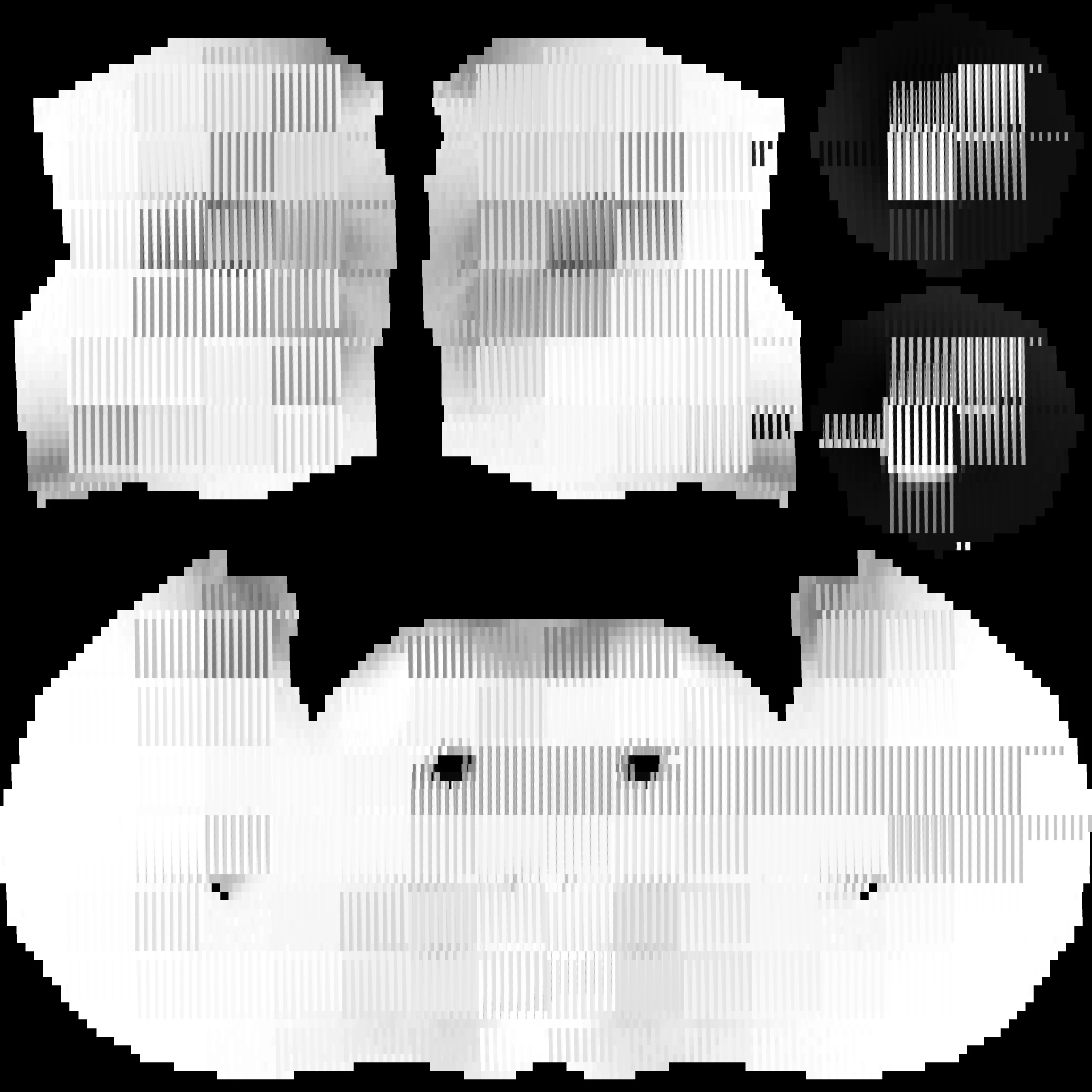

Feb 9, 2025 3:42 PM UTC
when i make the bake with "By Mesh Name" it improve but not much
Feb 9, 2025 3:20 PM UTC
its look something like that
