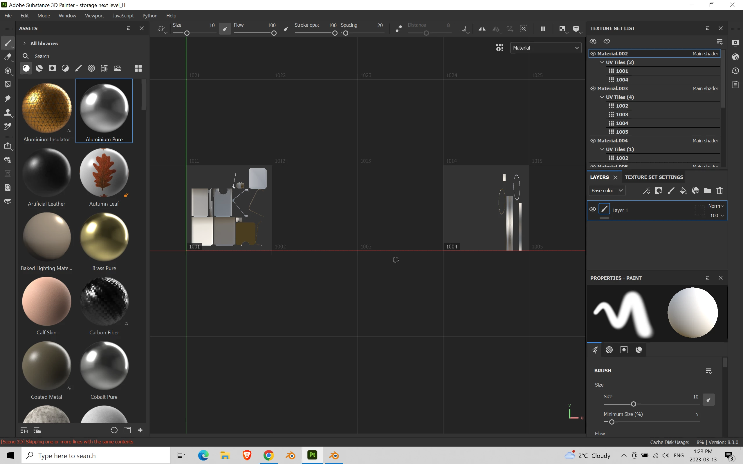

Painting error: Can only paint on some materials and not others
For some reason using the when using a brush tool to paint on a paint layer, I can only paint on 2/8 materials.
I imported my fbx from Blender without any errors. Could it be a problem with my UVs or my UDIM tiles?
I am using a PBR Metallic Rough with Alpha blending shader and I also used a PBR Metallic Rough Shader
with no difference.
I had this error in Substance
[GenericMaterial] Shader API has been updated. Textures may briefly flash white in the viewport. Updating the shader via the shader settings window or resource updater plugin could resolve the issue.
And I updated it with no changes.
Does this issue ring a bell with anybody?

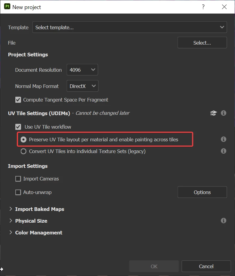

    I am glad it worked! In fact, if you're not working with the Paint across UV tile option on, you'll have to switch Texture Set in the Texture Set List to paint on different UV tile.That could have been the issue.
    Have fun with Substance Painter!

    Thanks for getting back to me. I kept my new projects settings at default, except for resolution.
    I did not check Use UV Tile Workflow. However the paint across tiles is checked, but greyed out.
    I imported my FBX again and I checked the UV tile workflow this time and that did the trick!
    Though its wierd that I could paint over some UDIM tiles and not others before.

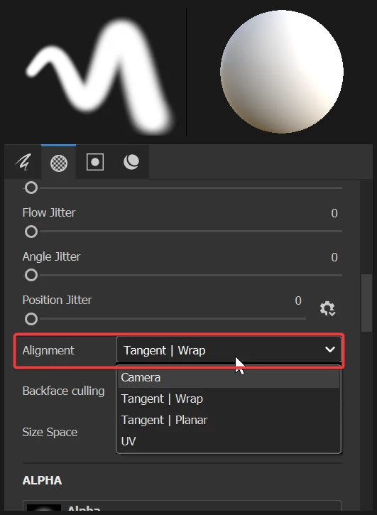

    I am not sure to fully understand the problem, but it could be due to the UDIM tiles if the project is not set up to the "paint across tiles" mode.
    You could also try several Brush Alignment to check if something changes.
