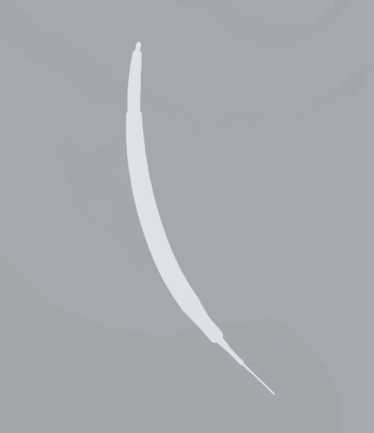

Pen sensitivity issue on Huion KAMVAS 22 Plus
Whenever I paint a stroke on any surface, instead of getting a smooth size transition, I get a very weird stepping artifact (image below). I have already reinstalled absolutely everything (drivers for both Painter and Huion tablet, video card, etc) and had no success fixing the problem at all. Also, I tried several different pressure sensitivity adjustments on the tablet software and none of them have worked.

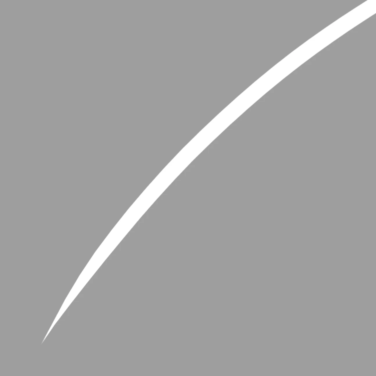

    Geoffroy, I have more findings: I've tried doing the same thing on a completely different computer with a Cintiq drawing tablet instead, and I had the exact same problem as shown above. So, the issue is in fact related to Substance Painter, and not to the tablets at all.
    Can you please try to reproduce the issue and see if you'll run into the same problem?
    Here is the result that I should get on Substance Painter (I made this on Photoshop, which has no issue with the pen pressure):
    Thanks in advance!

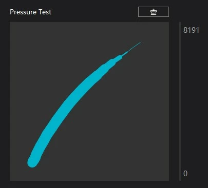

    May 17, 2022 2:03 PM UTC
    Thanks for the quick reply, Geoffroy.
    I've tried on Photoshop and had no issues at all. HOWEVER, the issue also shows in the Pen Pressure test section on the tablet's software (image below).
    GeoffroySC
