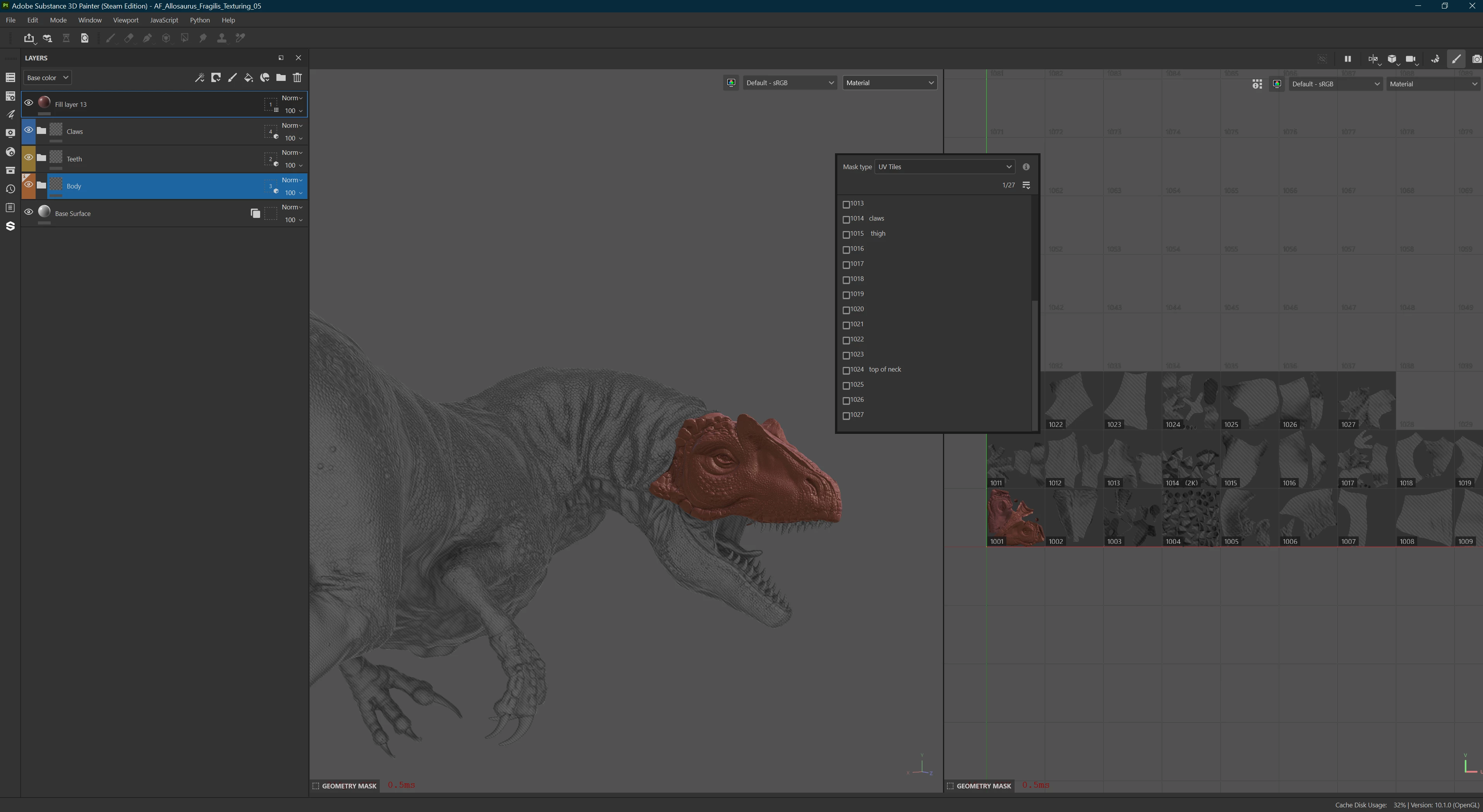

Most of the time I'm not working in 4k on the whole model but just the part where I need to be precise with my texturing. I use the geometry mask for isolating the part that I want to texture (this is were a good UV unwrap saves a lot of time !).
The other thing is the number of active channels : only the strict minimum for what I'm working on. And overall reducing the number of channels in your project is a good idea: when working on an organic project you might not need the metallic and the normal map.
At export or for render you can spend a bit more time waiting for Painter to calculate the whole project.
Geometry mask and a limited amount of channels are a good bet to improve your overall experience.
Here I'm working on only one UV tile that I isolated, this will allow me to work with the performance of a single asset, however beware of any anchors or complex process that might come from the bottom of the stack.
The Painter team is very aware of the performance problems and we will improve them step by step. If you can share any project that you have, we might be able to evaluate what sort of bottle necks there is and find relevant solutions.
