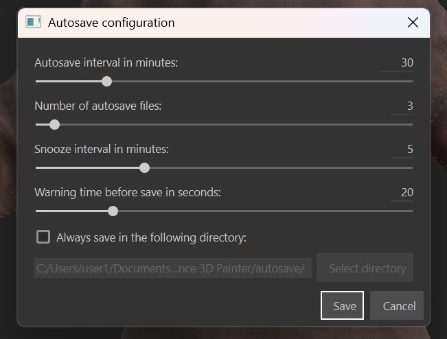

This issue occurs regardless of the project or resolution. Could it be due to cache or Autosave settings?

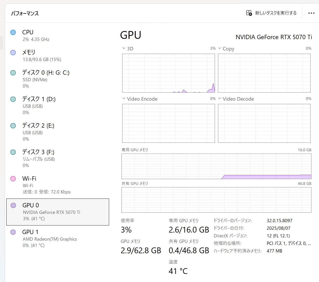

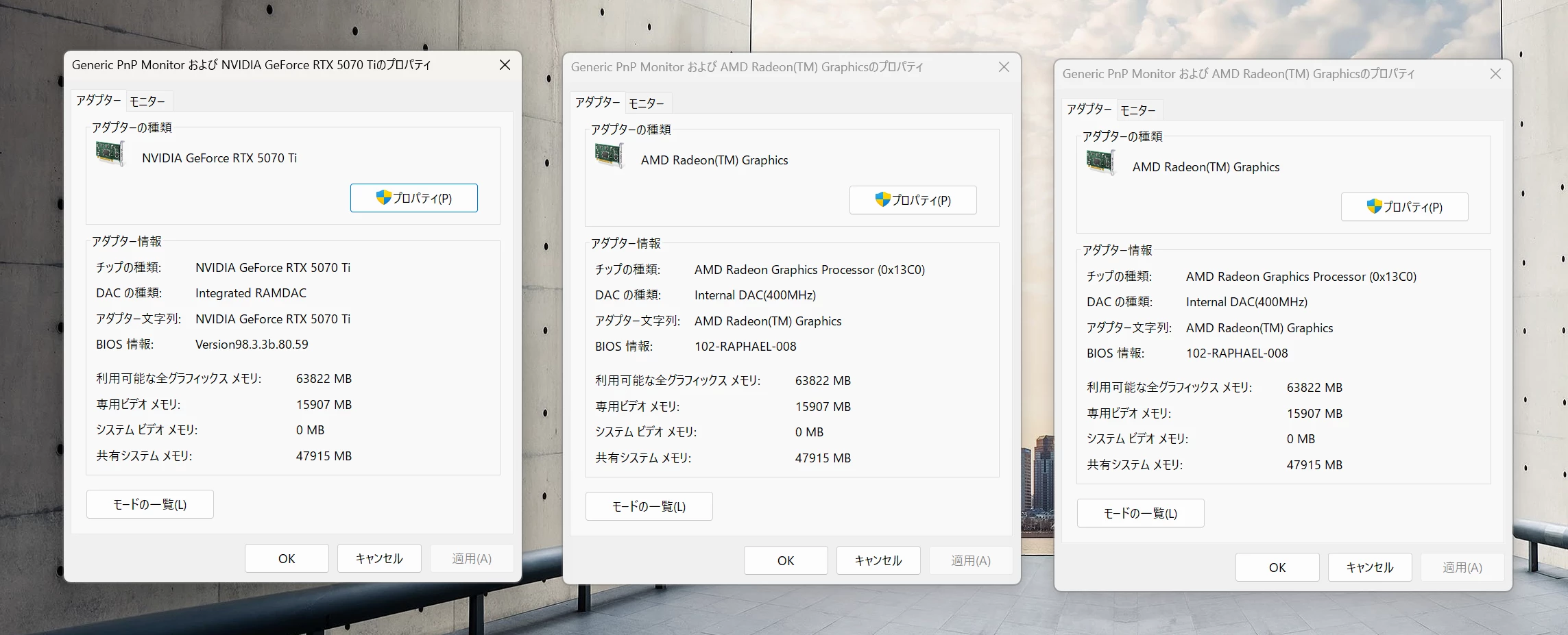

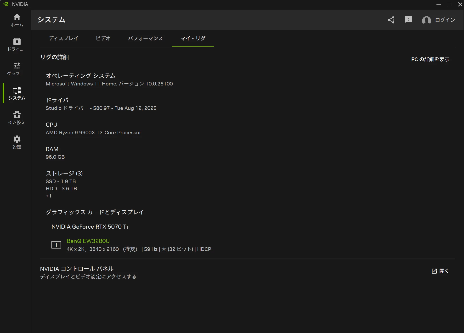

The specs are as shown in the attached image, and when I check performance in Task Manager, there seems to be ample processing capacity, so I don't think it's a spec-related issue.

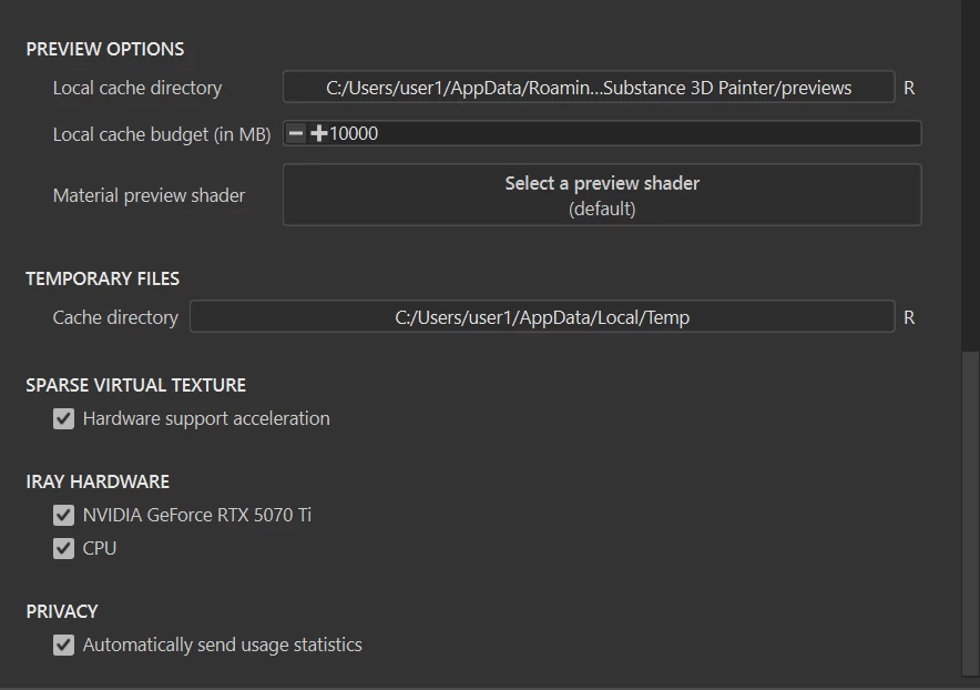

I tried disabling "Hardware-Supported Acceleration" in Edit > Settings > Sparse Virtual Texture, but the issue persisted.

The first thing I advise you to check is that your GPU driver is up to date. If it is and that the problem is still occurring, could you share your log (Help > Export log...) at cdellenbach@adobe.com with a link to this thread?
Keep me posted.
