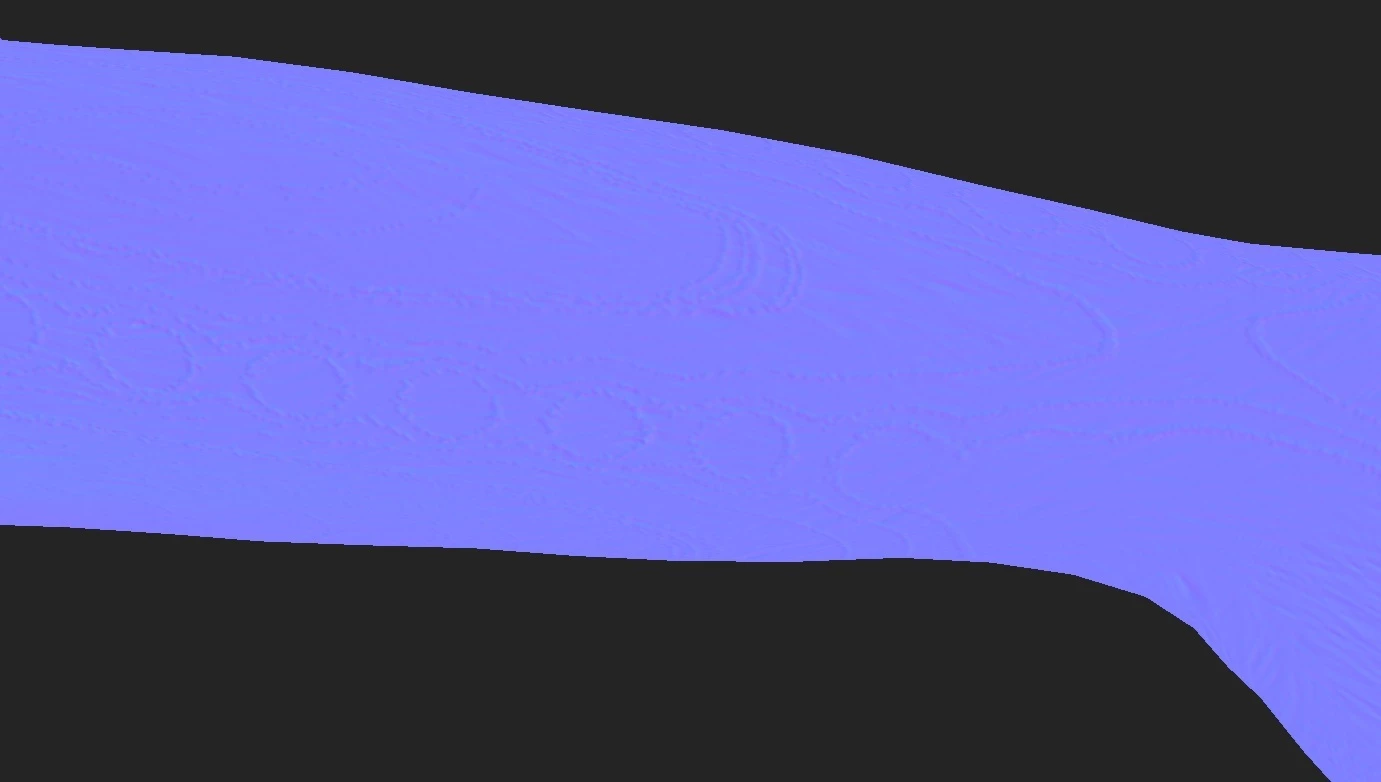

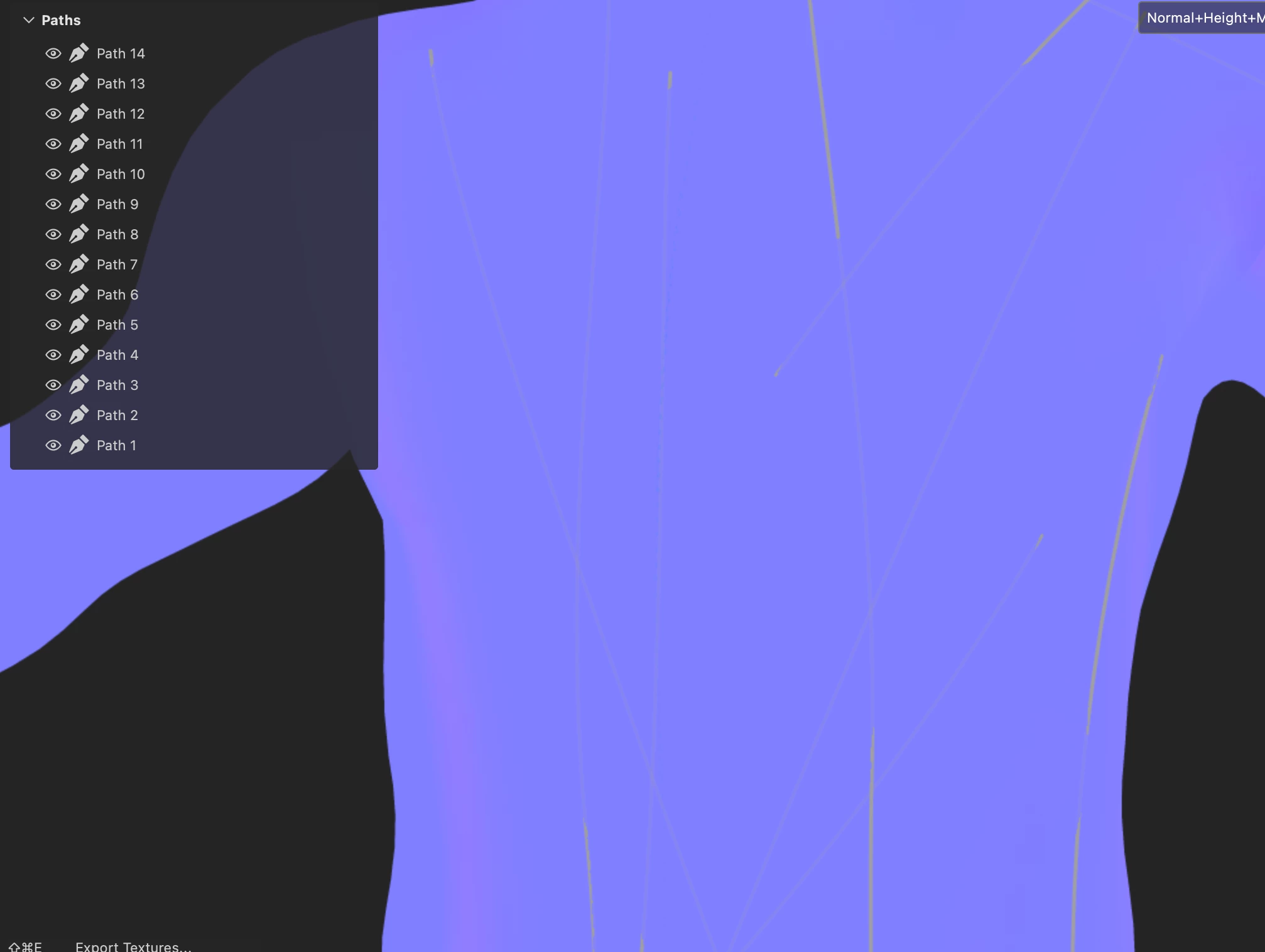

Now, let’s focus on your issue! From my perspective, it doesn’t look like a real “Painter bug”. Let me explain myself. I see two kind of artifacts in your video (thanks for the video by the way):
  1. Weird colors
  2. Stripes
Weird Colors in the Normal Map are expected. I’m sure that if you display your material and not the Normal Map, you don’t see any related artifacts. This is because of your UV shells orientation. To make it simple, Normal Maps work in a tangent space, so in 2D. When editing your Normal map directly on your 3D model, Painter automatically makes the required adjustments from on UV shell to another preventing, in fact, visible seams. I’m convinced that if you add a UV checker Generator, you’ll realized that artifacts are located near seams.
In addition, uncommon mesh’s normals can also result with a “weird looking” Normal Map. Therefore, I wouldn’t relate too much on how my Normal map looks, but rather on the material view itself.
Stripes are a different thing. On my side, I’m not reproducing.

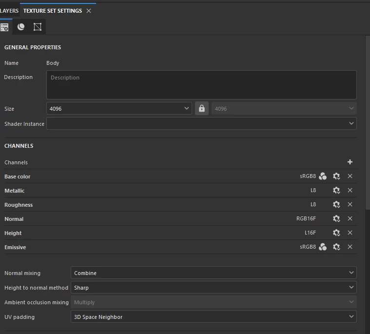

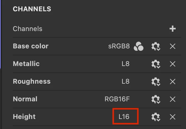

However, it kinda looks like a bitdepth issue to me. Can you tell me in which Space your Height map is working?
Texture Set Settings - Channels

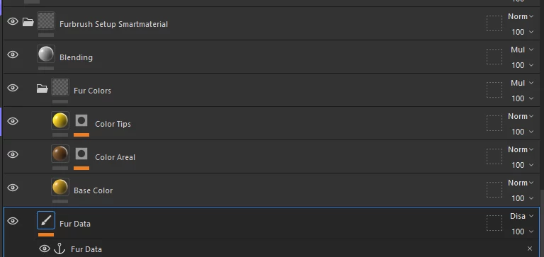

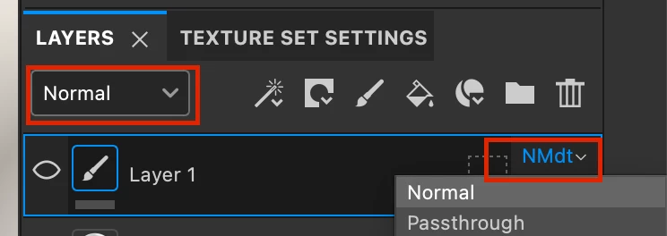

Also, do you see these stripes in the material itself? Do you have underneath layers with this kind of “fur” effect? If so, can you switch the Path layer’s Blending mode to “Normal” for the Normal map and Height Channel?

i thought the post was just being ignored >,<….. umm i never had shared the project because never gotten a reply back X-D from the old post.. so i might need Email or something again ^-^..
#1 stripes your looks very clean O.o i dont see anything X-D
#2 looks like the same as yours
#3 it dose nothing making it NMdt “Fur Data is where all the Painting is”  and Blending is where you can Change the settings.
its i find find it odd how the Wooden effects shows up in my Project the longer you work on it… even the finished Fur paint Changes into Wooden Effects and Circles
if your not getting this issue is it possible its the Tool brush it self ? it hasn't been updated in Ages

Hello ​@Stealth-unit ,
We don’t remove anything (except for scams and things of the sort). We switched Adobe forums platforms like a year ago and we lost some posts with that. Maybe that’s what you are referring to.
But my bad I didn’t catch up with you. This is indeed an issue and we created a ticket to fix it. When overlaying a large amount of paths, artifacts may appear. So thank you for helping us.
That being said (and unfortunately), considering we didn’t receive other reports on the topic, we considered it as a corner case, therefore the ticket is low priority. We will fix the problem as soon as we have the bandwidth
