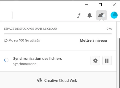

About Creative cloud desktop, I have all the time a file synchronisation activity.
Result : it takes bandwith on my internet connexion and 15/20% of the CPU.
Here is the version of the creative cloud desktop :

<moved from cc desktop bugs>
June 20, 2023
By example, on https://assets.adobe.com/  I have no files to synchronize.
I have noticed anoter thing :
1) Inside the creative cloud desktop, if I stop the synchronization, and if I restart the synchronization, the synchronisation stops and I can see that the synchronisation of files is "up to date".
2) But, then, I restart my computer and see that again the synchronisation problem is back (it synchronize all the time, even if there is no files to synchronise).
So I am all the time obliged to stop and restart the synchronisation inside creative cloud desktop.
June 20, 2023
I gone in all locations you have mentioned, and I have only found "PDF files with signature" in adobe document cloud.
But I don't understand why creative cloud does not stop the synchronisation, by using my CPU all the time at 15/20%.
