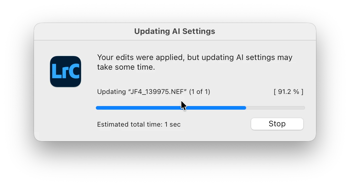

When using Loupedeck do you see the modal progress scope for update Ai settings?
I.e. this one:
If not then it's like @johnrellis said and at Loupedeck they didn't update the code.
