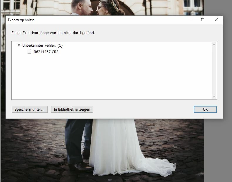

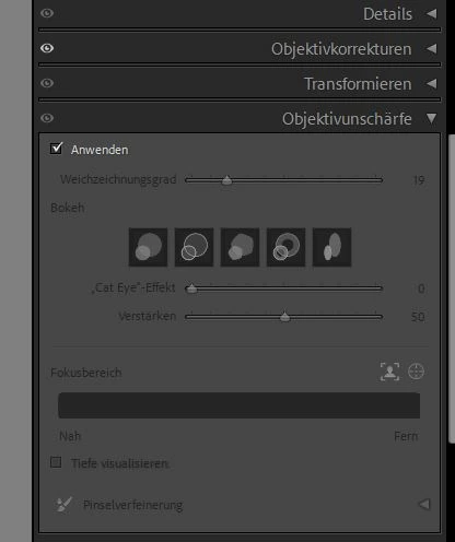

May 30, 2025 10:51 AM UTC
Wenn ich den den Haken bei Objektivunschärfe drin lasse, dann kann ich das Foto nicht exportieren. Es gibt eine Fehlermeldung "Exportvorgang wurde nicht durchgeführt".
Anshul_Saini
May 30, 2025 2:56 PM UTC
Hi @Sabine29465214qtrh,
Thanks for bringing this up. I understand how frustrating it can be when exports don’t work as expected.
To help troubleshoot this properly, could you please share the following details:
1. System Information: (Lightroom Classic → Help → System Info… → Copy and paste that here)
2. Please share the original file.
3. Where are you trying to save the exported image? Internal drive, external drive, or cloud-synced folder?
4. Does this happen with all files or just this one? Try applying Lens Blur to a different image and check if the export also fails.
I’ve tested this on my end with a CR3 file and was not able to reproduce the issue, so these details will help us better understand if this is file-specific, system-related, or a bug.
Thanks, and looking forward to your response so we can get this resolved!

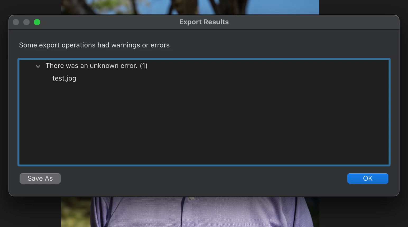

Apr 29, 2025 2:24 AM UTC
Hello Lightroom Community,
I have used lens blur several times before. Since a few days ago, I am unable to export pics with lens blur - Lightroom gives me an "unknown error". I included a photo for reference. I removed lens blur and was able to export pics with no isuue.
When the photo is loading during the export process, the progress bar moves much faster than during a standard export. I just updated to Lightroom 8.3...
