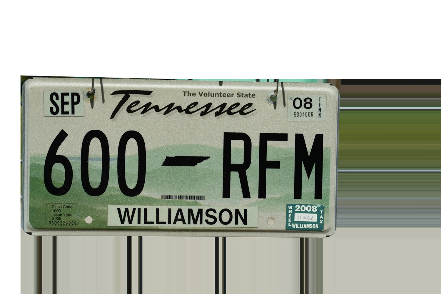

When enlarging and exporting a file with a transparent background as a PNG file from Lightroom this happens

I would add PNG to that as well as I've imported PNG files and tried to export them larger and it exhibited the same error. So -
Exporting as a PNG larger than the original size exhibits the error.
I don't know if it's important but I think there is a threshold of enlargement as well. When I was troubleshooting I could successfully export if the enlargement was small - when I enlarged the large side form 6,000 p to 7,000 p it did fine, but going up to 8,000 p the error was there. That has been my experience anyway.
There should be a vid of the CSR attempting to correct the issue via my computer - Case number: ADB-16432718-F5M0 - if that's helpful and you run in those circles. I can't imagine it's all that exciting...

So to recap:
Tiff/PSD with Transparent Backgrounds
Exported at larger than original size exhibit this behavior.
Is that correct?

This is definitely a bug.  The only thing I use PNG files for in LR are Identity Plates and Watermarks so haven't noticed it.

I found that as well, I think it takes longer because it's adding all that extraneous data to the file. I'm relieved that someone else was able to duplicate the problem - proof that I am, at least, not crazy.

Strange, I did a couple other photos and they both exhibit the problem so I got one good result out of 3!!
BTW, PNG files seem like they take a LOT longer to export than they should.   They take longer in Photoshop but in Lightroom they take an extraordinary amount of time to export.

What version of Lightroom Classic did you use and what were your export settings?

Works fine for me on macOS 10.15.7

I should also say, Lightroom Classic 10.0 being used on a Mac running Big Sur though it was also happening before I upgraded the OS on the Mac. It was not happening before I upgraded Lightroom Classic.

Yes. I start with this image from within Lightroom. It's an NEF file.
From within Lightroom I "edit in photoshop" to remove the background. The example I initially posted was a quick and dirty version I did with customer service. When I've finished removing the background from around the plate as well as the bolt holes I save it, then go back to Lightroom. Once in Lightroom I export as a PNG, sRGB color space, 8bits/component. I enlarge the Long Side to 12,000 pixels with a Resolution of 300.
This same thing happens with images that already have the backgrounds removed as well. The image below had a transparent background, was imported into Lightroom with a transparent background and upon export, enlarging the image by 1000 pixels, it rendered this way:
