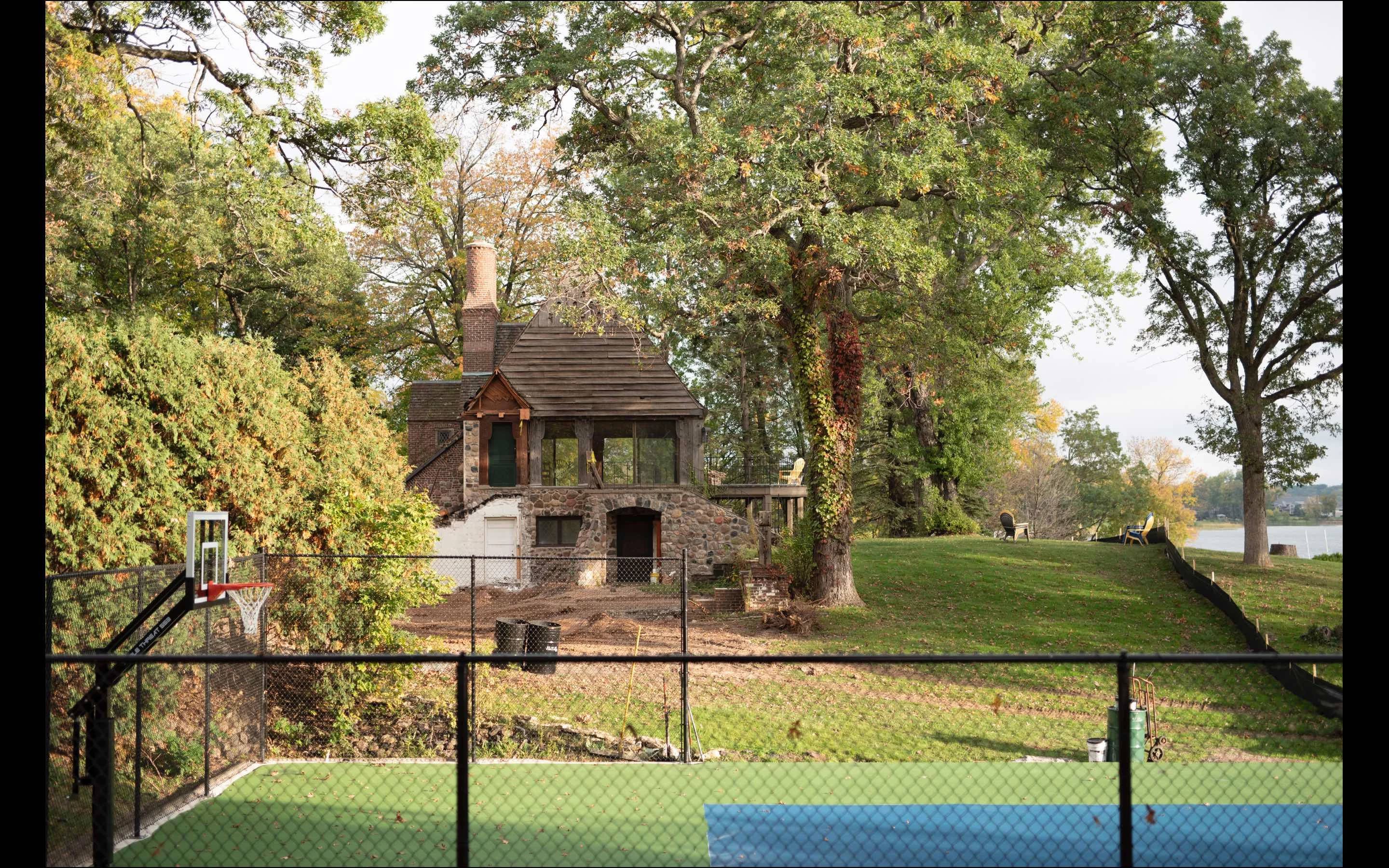

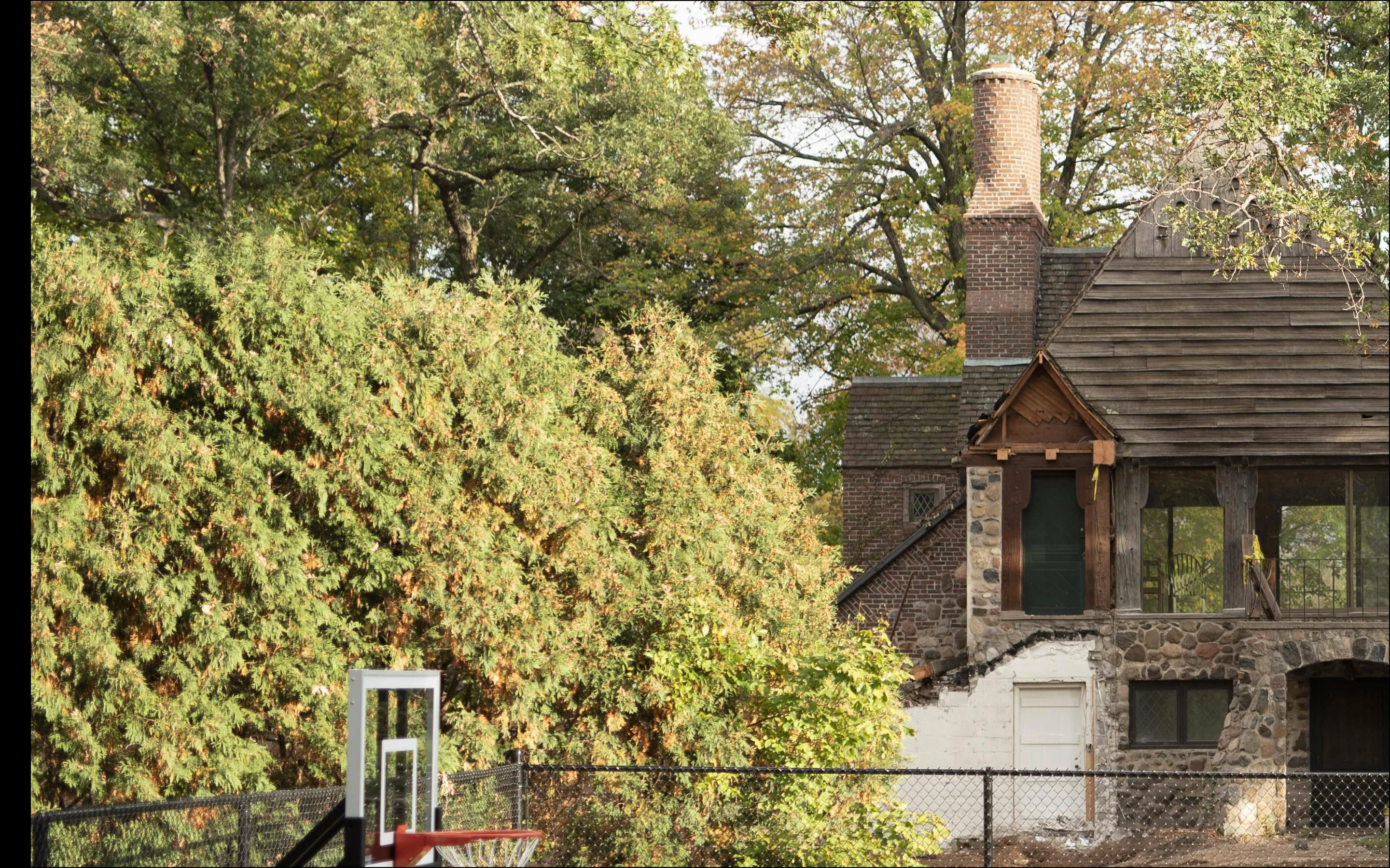

When I display a photo in Lightroom Classic in full screen zoomed in, Lightroom displays a slightly desaturated version of the photograph. The change in colors can be visibly observed in two ways:
  • Entering e.g., 100% zoom level in the Library Loupe view (E), then toggling Full screen (F). The photo displayed in full screen is desaturated.
  • Enter full screen mode and click on the picture to zoom in to the preset zoom level. The photo displayed when zoomed in is desaturated.
The phenomenon only appears in the Library module. Opening the photo from the Develop module and entering full screen mode while zoomed in fixes the issue.
The phenomenon only appears when the zoom level in full screen mode is set to anything other than "Fit" zoom level. Any numeric zoom level, e.g., 50%, 100%, 200%, and the "Fill" zoom level will show the issue.
The phenomenon seems unaffected by GPU setting in the preferences.
I have attached two screenshots showing the issue. In the first screenshot, the photo is displayed normally while Lightroom is not in full screen mode. In the second screenshot, I enter full screen mode, and the photo instantly becomes desaturated. (It's more easily visible if you download the two images and toggle between them.)
Is this a known issue? Is there any known workaround?

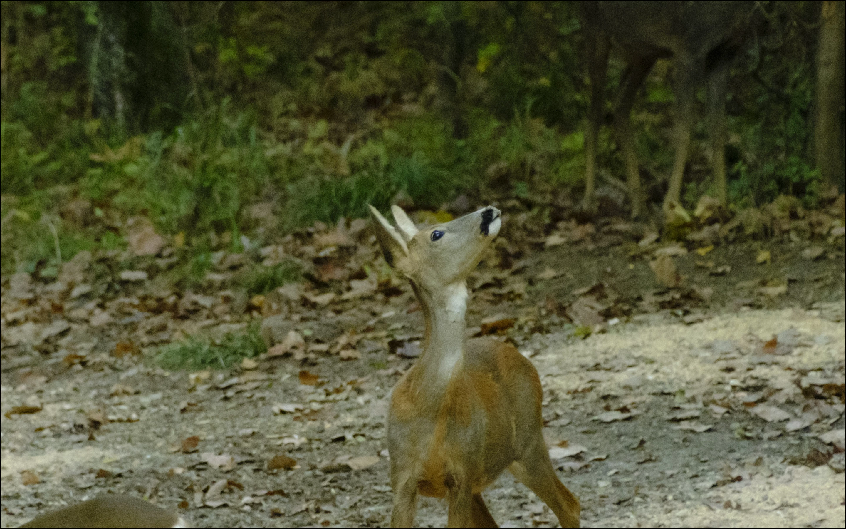

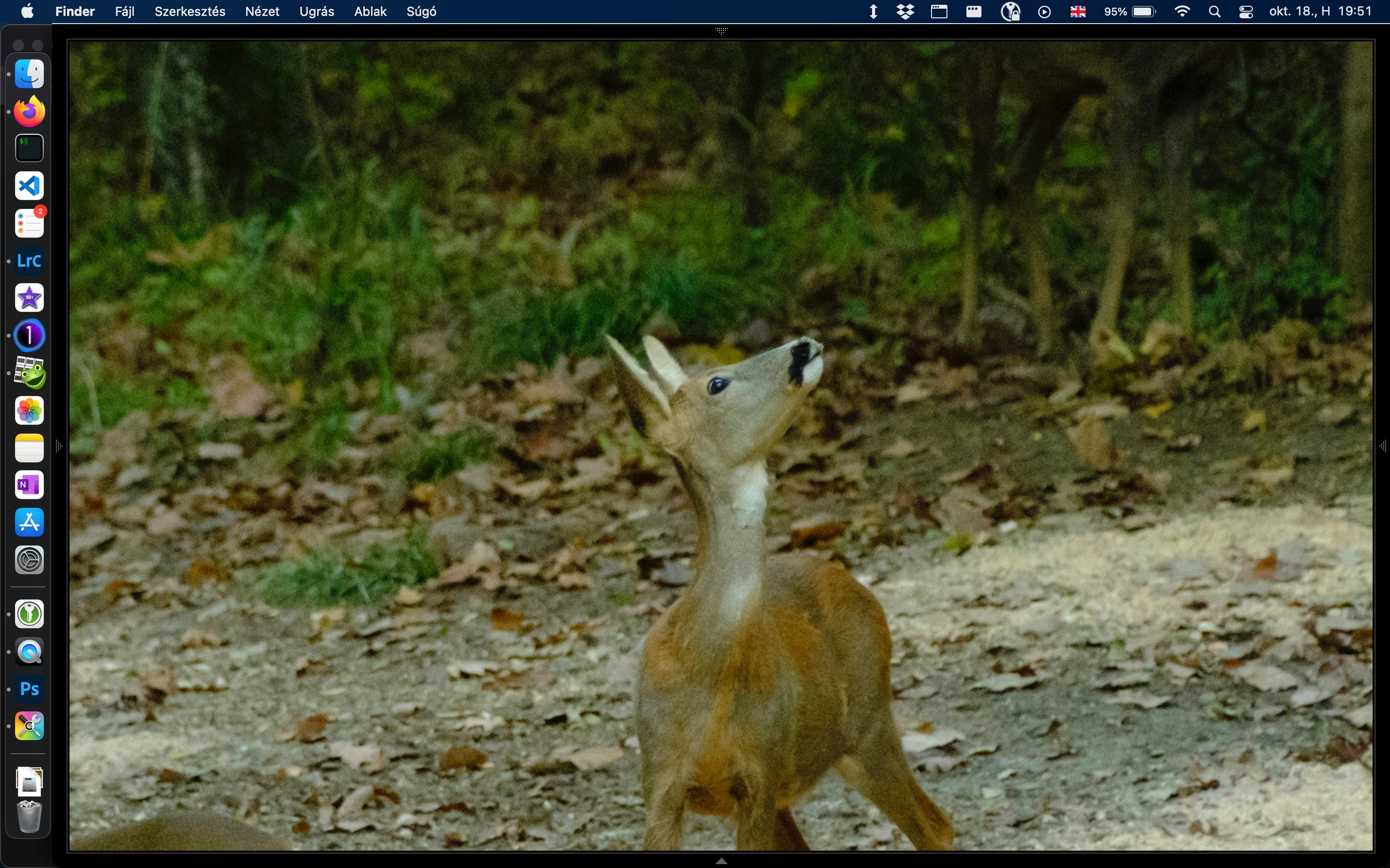

Issue: Lightroom Classic Renders image incorrectly in full-screen preview view, when zooming an image.
Elaborated: When I view an image in the full-screen preview view, the image renders normally at first, and the colors appear vibrant. When I zoom in while using full-screen preview, it appears to display the original image straight out of camera, without edits, color adjustments, etc. This is especially noticeable with raw images. In the example photos, you can see the normal image while zoomed out, and a dull image when zoomed in. Issue does not occur when not using full-screen preview.
  • Lightroom Classic Version Number: 10.4 release, camera raw 13.4
  • OS Version Number: macOS 11.4 (20F71)
Steps to reproduce:
  1. ... import a photo (I always shoot raw)
  2. ...apply any adjustment
  3. ...Open full screen preview (F)
  4. ... Click on image to zoom
Expected result: Should display image as it appears when not zoomed in. Should display latest image with adjustments, edits, etc.
Actual result: Displays what appears to be the original image straight out of camera, noticeably duller in color and without any edits made.

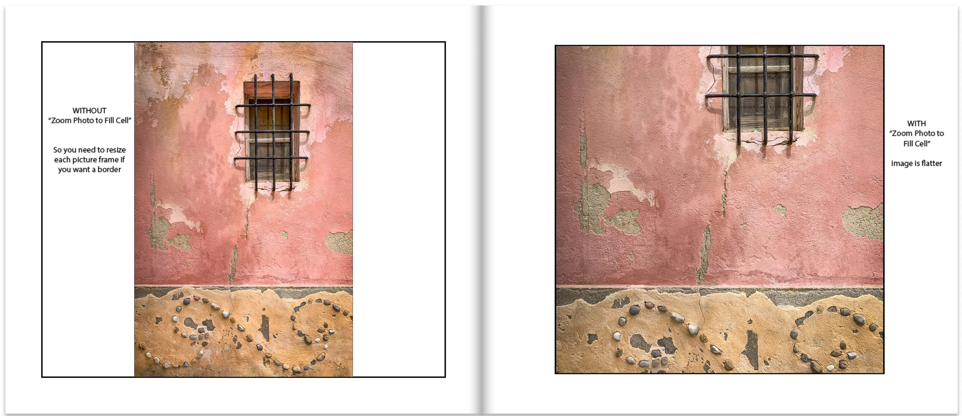

Good afternoon
I have had this problem for a few months.
I am on LrC 10.4 using Big Sur 11.5.1.
If I try to "Zoom Photo to Fill Cell" an image in the Book Module, the zoomed version looks flat/dull compared to the original as you can see from the screen shot below.
The image on the left is WITHOUT the "Zoom Photo to Fit Cell" setting and the one on the right is WITH.
This means that you have to resize every picture which doesn't have the same dimensions/ratio as the template, something not practical when making books with hundreds of images.
Hopefully you can point me in the right direction to fix the problem.
Many thanks in advance
