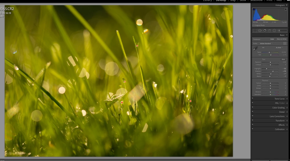

Image 1. - this is the base image for the double exposure.

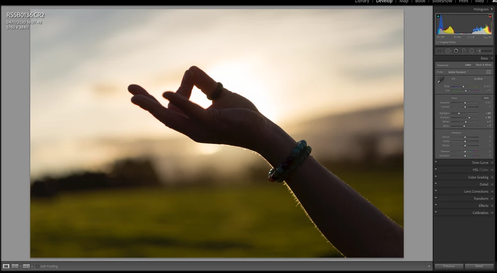

This is image 2 of the double exposure:

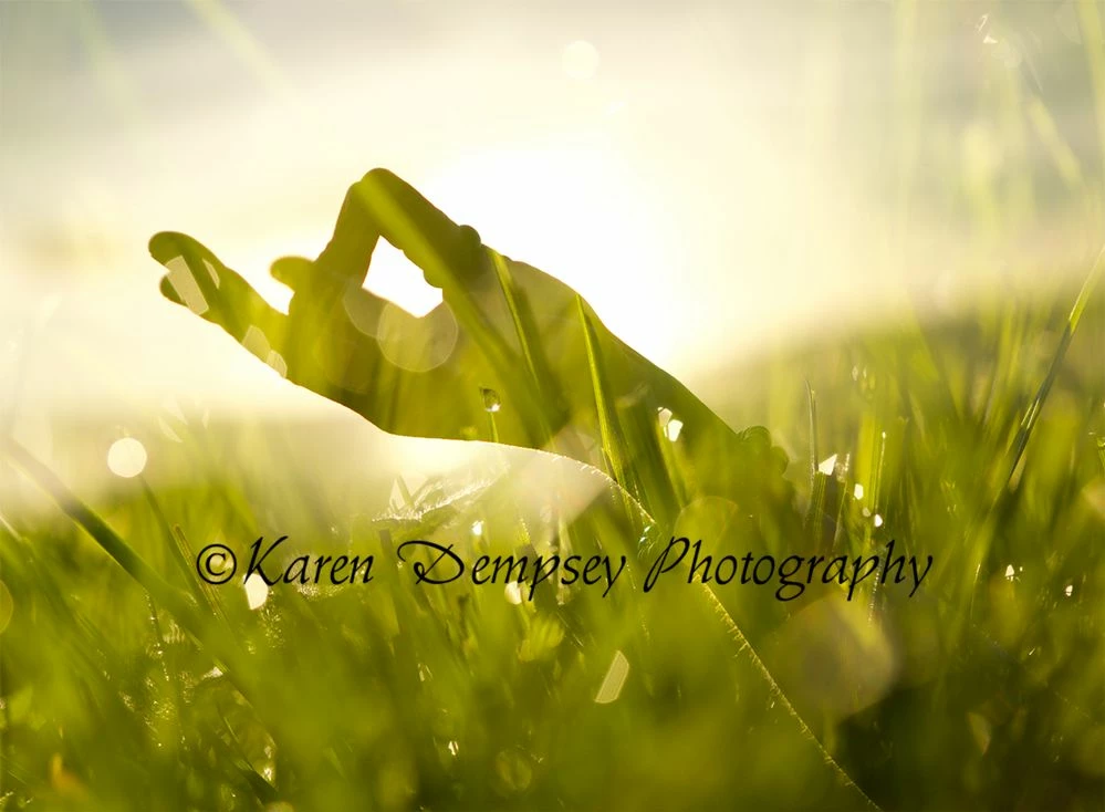

This is image 3: - the in-camera merged double exposure.  The image below is SOOC and exported directly from Lightroom last week and these are the colours I would like to keep.  This image is a low res jpg and is all I have left of the original colours as the RAW version in Lr has changed to nuclear Yellow.

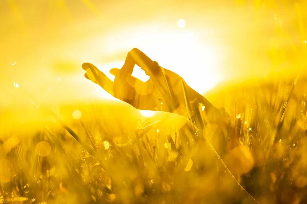

This is the RAW file showing now as funky, nuclear yellow.  Despite resetting all the settings and even reimporting the files I am stuck with the yellow and can't  get the original colouring back.  I can get it to revert to green by using Auto WB in Lr but it's not the same as the original.

Anthony, thank you for this information...I had completely forgot about your report! In the case here with Canon 5D MKIII multi-exposure CR2 file the OP set the camera to a fixed Flash WB setting. So one would expect the WB results to be the same as the individual shots. Clearly the method used for calculating the actual As Shot WB is incorrect. Here's a comparison of the OP's multi-exposure CR2 file shot witht he EOS 5D MKIII and a similar one I shot with the EOS 6D camera.
The color temperature in the 5D MKIII file is lower than mine (4436 vs 6509), but entering 4436 into LrC WB the image is still shifted heavily toward yellow. It's still a mystery to me!
